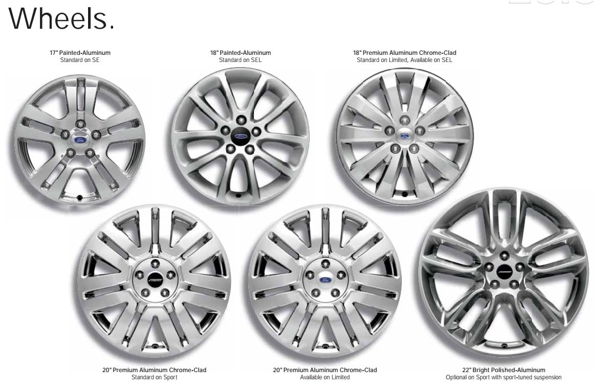

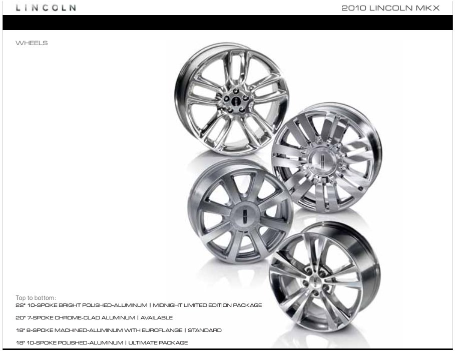

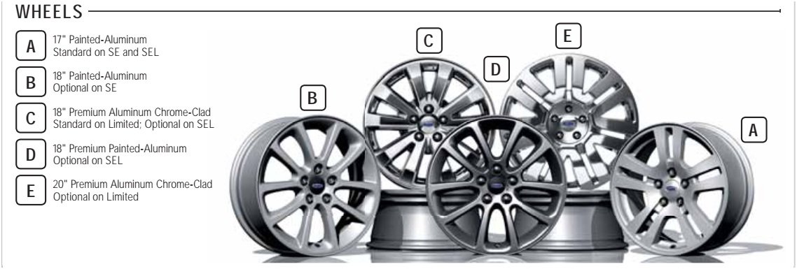

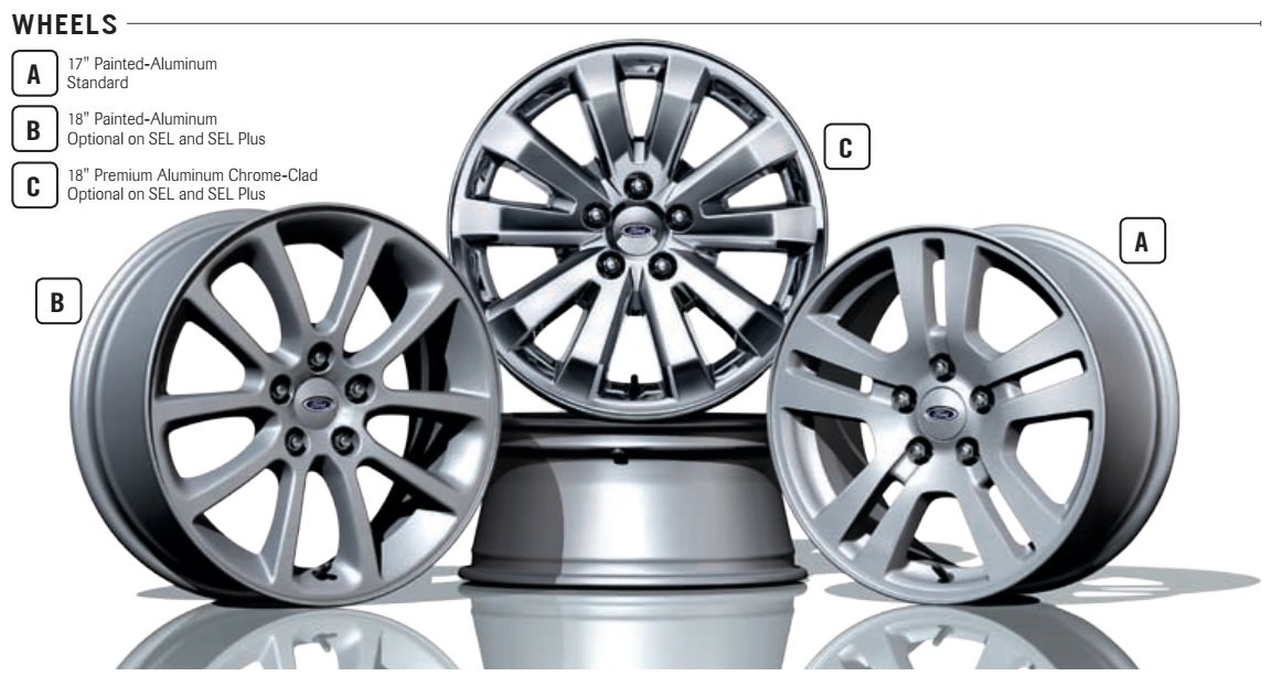

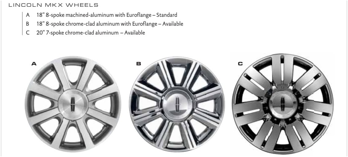

Haz Posted August 21, 2021 Report Share Posted August 21, 2021 (edited) Wheel-Size.com advises the following tire & wheel sizes for 2010 Edge... Using the website's search-by-wheel-size feature, the only Ford/Lincoln factory-installed wheels that fit are from 2006-2010 Edge and MKX, likely due to the wheels' 70.5 mm center bore being reduced to to 63.4 mm on 2011 and later model years. By year and model, your choices are... 2007 Edge 2008 Edge 2009 Edge 2010 Edge 2008 & 2009 MKX 2010 MKX You may want to try Car-Part.com's search engine to select used wheels by model year and/or specific wheel size/design in your area or nationwide. Photos of the individual wheels offered for sale are usually viewable, along with condition grading & pricing information. Good luck! Edited August 21, 2021 by Haz 1 Quote Link to comment Share on other sites More sharing options...

Haz Posted August 22, 2021 Report Share Posted August 22, 2021 (edited) It is NOT the case that 2011 or newer Edge/MKX wheels will fit your 2010 Edge, because those newer wheels have a center bore that is SMALLER than your 2010 Edge's hub spigot. If you are seeking Ford-Lincoln factory wheels to install without having the center bore enlarged, only those from 2006-2010 Edge & MKX will fit. From wheel-size.com ... Good luck! Edited August 22, 2021 by Haz 1 Quote Link to comment Share on other sites More sharing options...
