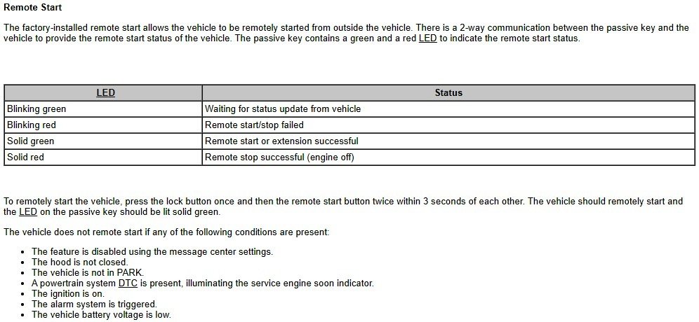

Just got some warranty work (catalytic converter) and the brake line recall on my 2016 edge. Go to pick it up and the remote start doesn't work ( of course it's nothing they did ? anyway other than the setting in the dash which I can't find under settings. And the hood latch what could be the issue? I beep it 3 times and lights just flash but no start no beep nothing. And no CEL any ideas would help before paying them
No I cannot which is driving me insane. I'm not technologically impaired lol but it is 100 percent not in the settings  on the cluster only thing remotely close is automatic engine shutoff which I assume means it shuts off after 15 min after remote starting
