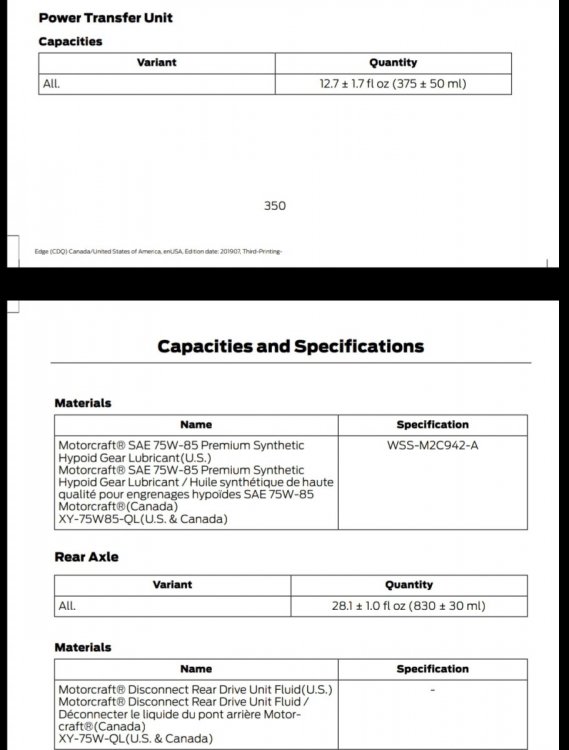

1004ron Posted November 5, 2022 Report Share Posted November 5, 2022 (edited) 2 hours ago, Lakeside said: I got the 12.8ounces off the Amsoil website. My owners manual says 11.8 fl. oz. (2016 Edge Sport 2.7L) I put in the same amount that came out. How much did you put in? Safest is to fill until it trickles out the fill hole. There's numerous reports of errors in the listed quantity. Edited November 5, 2022 by 1004ron 1 Quote Link to comment Share on other sites More sharing options...
Lakeside Posted November 5, 2022 Report Share Posted November 5, 2022 (edited) 8 hours ago, 1004ron said: How much did you put in? Safest is to fill until it trickles out the fill hole. There's numerous reports of errors in the listed quantity. Since I drained 22oz out, of my `16 Edge, I put maybe 23-24oz back in. I thought 11.7 was too little gear oil for a case that size. You'd think the Ford Owners Manuel would be accurate but I'm starting to wonder. I don't want to overfill it bc I'm afraid of aeration. I only was able to get about 10oz out of my daughters `19 Titanium 2.0L. I put about 14oz of Amsoil 75W-90 Extreme back in but I'm thinking of adding an additional 8ozs. (she purchased new and the PTU oil has never been changes) Edited November 5, 2022 by 1004ron Quote Link to comment Share on other sites More sharing options...
1004ron Posted November 6, 2022 Report Share Posted November 6, 2022 3 hours ago, Lakeside said: I don't want to overfill it bc I'm afraid of aeration. I only was able to get about 10oz out of my daughters `19 Titanium 2.0L. I put about 14oz of Amsoil 75W-90 Extreme back in but I'm thinking of adding an additional 8ozs. (she purchased new and the PTU oil has never been changes) Can't overfill if its trickling out the fill hole. Is that a typo? - shouldn't it be 75w140 or does the 2019 use 75W90? Quote Link to comment Share on other sites More sharing options...
lildisco Posted November 6, 2022 Report Share Posted November 6, 2022 1 hour ago, 1004ron said: Can't overfill if its trickling out the fill hole. Is that a typo? - shouldn't it be 75w140 or does the 2019 use 75W90? 2020 owners manual Quote Link to comment Share on other sites More sharing options...
Lakeside Posted November 6, 2022 Report Share Posted November 6, 2022 (edited) 1 hour ago, lildisco said: 2020 owners manual My daughters 2019 Titanium 2.0L calls for the 75W-90 and my 2016 Sport 2.7L calls for the 75W-140 Thanks everyone for your input. Steve Edited November 6, 2022 by 1004ron Quote Link to comment Share on other sites More sharing options...
Lakeside Posted November 9, 2022 Report Share Posted November 9, 2022 On 11/2/2022 at 10:52 PM, Lakeside said: I have a 2016 Edge Sport that I bought new that now has 62K on it. I've never changed the PTU oil so I thought it was time. I'm fortunate bc the drain plug and fill plug are very accessible and I didn't need to remove anything to change the oil. I drained 22 ounces out so I added 22 ounces of Amsoil 75W-140 Severe Gear oil. I'm a little confused bc my owners manual says to add 12.8 ounces. So whats up with that? Has anyone experienced this? Now I decided to change the PTU oil on my daughters 2019 Edge Titanium 2.0L Her Edge was purchased new and I'm changing her PTU for the first time also. I drained about 12 ounces out. so I put 14 ounces back in. Ford calls for 12.7 +/- 1.7 ounces in her Edge Decided to crawl under my daughters 2019 Titanium and add some more oil to the already 14oz. I added the other day. It took about 3ozs before it started coming out of the fill hole so I guess 17oz is all it'll hold. It has to be a much smaller PTU than whats in `16 2.7L Quote Link to comment Share on other sites More sharing options...

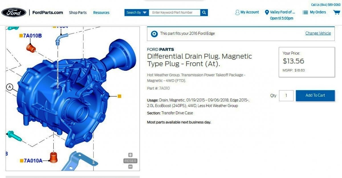

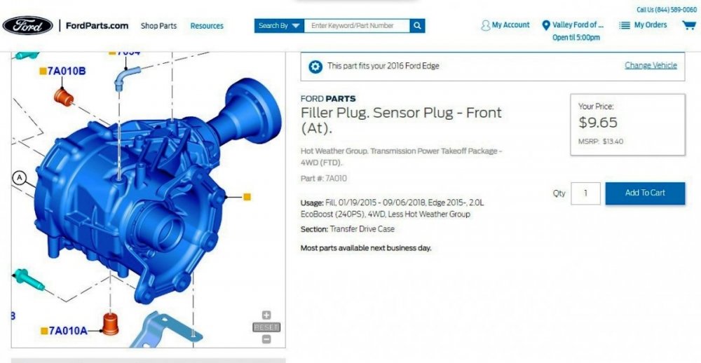

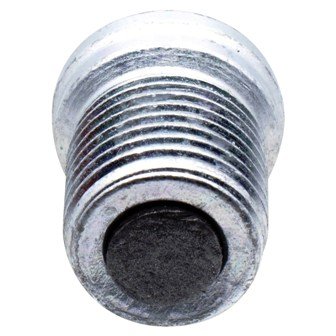

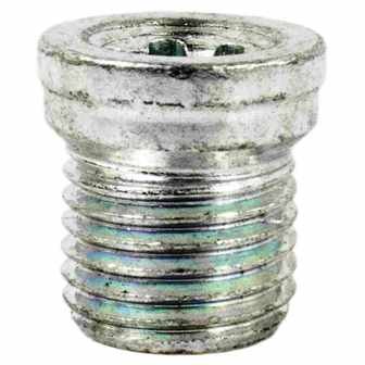

my2k2zx2 Posted December 3, 2022 Report Share Posted December 3, 2022 What is the part # for replacement drain plugs? I have a 2016 2.0 and had a heck of a time getting them out. I did use a Torx Plus bit but damaged them a bit with the torque needed to break them free. I'd like to replace them when I change the fluid again in the sprint. Quote Link to comment Share on other sites More sharing options...
1004ron Posted December 3, 2022 Report Share Posted December 3, 2022 8 hours ago, my2k2zx2 said: What is the part # for replacement drain plugs? I have a 2016 2.0 and had a heck of a time getting them out. I did use a Torx Plus bit but damaged them a bit with the torque needed to break them free. I'd like to replace them when I change the fluid again in the sprint. I expect you'll need to order the replacement for a Ford dealership (online or local). Maybe @Haz can get you the part number. Why did you use a Torx Plus and not what these plugs are Torx - that's most likely why they're damaged. Mine were very hard to break free due to the tapered metal to metal seal, but with the correct Torx key there was no risk of damaging the plug. Quote Link to comment Share on other sites More sharing options...
my2k2zx2 Posted December 3, 2022 Report Share Posted December 3, 2022 The T50 I had was loose to begin with, was afraid it would fully strip out. The TP50 I had fit much better. Knowing that I'm doing it again in the spring I figured it would be easy to replace the plugs at that time. Quote Link to comment Share on other sites More sharing options...
Haz Posted December 8, 2022 Report Share Posted December 8, 2022 From Ford's online parts site... Magnetic Drain Plug part number: CV6Z-7A010-A FordParts.com page link for Magnetic Drain Plug Filler Plug part number: CV6Z-7A010-B FordParts.com page link for Filler Plug Web searching the part numbers may reveal lower pricing via other online sellers. Good luck! 3 Quote Link to comment Share on other sites More sharing options...
