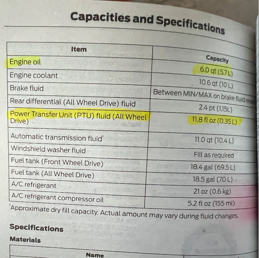

Lakeside Posted November 3, 2022 Report Share Posted November 3, 2022 I have a 2016 Edge Sport that I bought new that now has 62K on it. I've never changed the PTU oil so I thought it was time. I'm fortunate bc the drain plug and fill plug are very accessible and I didn't need to remove anything to change the oil. I drained 22 ounces out so I added 22 ounces of Amsoil 75W-140 Severe Gear oil. I'm a little confused bc my owners manual says to add 12.8 ounces. So whats up with that? Has anyone experienced this? Now I decided to change the PTU oil on my daughters 2019 Edge Titanium 2.0L Her Edge was purchased new and I'm changing her PTU for the first time also. I drained about 12 ounces out. so I put 14 ounces back in. Ford calls for 12.7 +/- 1.7 ounces in her Edge 1 Quote Link to comment Share on other sites More sharing options...
1004ron Posted November 3, 2022 Report Share Posted November 3, 2022 On 11/3/2022 at 2:52 AM, Lakeside said: Has anyone experienced this? Expand Yes. Fill the PTU's until the oil trickles out the fill hole. 1 1 Quote Link to comment Share on other sites More sharing options...
DILLARD000 Posted November 3, 2022 Report Share Posted November 3, 2022 Yep, better to overfill PTU, than underfill; that gearoil gets cooked so the more you can fit into that gearbox the better. After drilling\tapping & installing a Fumoto DrainValve in the PTU bottom & a fill hose on the PTU top vent barb with a fill can under the hood, now change the 75w140 AmsOil every 6mths along with routine engine oil changes. Hopefully makes it last as long as the rest of the car. Quote Link to comment Share on other sites More sharing options...
omar302 Posted November 3, 2022 Report Share Posted November 3, 2022 On 11/3/2022 at 2:52 AM, Lakeside said: I drained 22 ounces out so I added 22 ounces of Amsoil 75W-140 Severe Gear oil. I'm a little confused bc my owners manual says to add 12.8 ounces. So whats up with that? Has anyone experienced this? Expand The owners manual states 23.7 fluid ounces for the Sport (2.7 EcoBoost). Where did you get the 12.8 ounce capacity? 2019+models have a different PTU , it can disconnect the rear drive shaft to save fuel when AWD is not required. Quote Link to comment Share on other sites More sharing options...

1004ron Posted November 4, 2022 Report Share Posted November 4, 2022 On 11/3/2022 at 5:25 PM, DILLARD000 said: Yep, better to overfill PTU, than underfill; that gearoil gets cooked so the more you can fit into that gearbox the better. After drilling\tapping & installing a Fumoto DrainValve in the PTU bottom & a fill hose on the PTU top vent barb with a fill can under the hood, now change the 75w140 AmsOil every 6mths along with routine engine oil changes. Hopefully makes it last as long as the rest of the car. Expand Not easy to overfill if the if the fill hole is open. 1 Quote Link to comment Share on other sites More sharing options...
Perblue Posted November 4, 2022 Report Share Posted November 4, 2022 On 11/4/2022 at 10:58 AM, 1004ron said: Not easy to overfill if the if the fill hole is open. Expand Sure it is, jack it up so the fill hole points up some and fill until it pours out the hole. Quote Link to comment Share on other sites More sharing options...
handfiler Posted November 4, 2022 Report Share Posted November 4, 2022 (edited) In my experience with differentials, transmissions, transfer cases et cetera; quite often overfilling results in the excess amount exiting the unit via the breather. I follow the factory fill procedure and save myself unnecessary headaches. Edited November 5, 2022 by handfiler 1 Quote Link to comment Share on other sites More sharing options...
Lakeside Posted November 5, 2022 Report Share Posted November 5, 2022 On 11/3/2022 at 7:07 PM, omar302 said: The owners manual states 23.7 fluid ounces for the Sport (2.7 EcoBoost). Where did you get the 12.8 ounce capacity? 2019+models have a different PTU , it can disconnect the rear drive shaft to save fuel when AWD is not required. Expand I got the 12.8ounces off the Amsoil website. My owners manual says 11.8 fl. oz. (2016 Edge Sport 2.7L) I put in the same amount that came out. 1 Quote Link to comment Share on other sites More sharing options...
