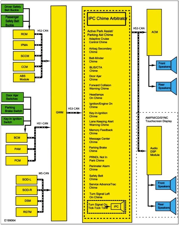

Haz Posted July 11, 2021 Report Share Posted July 11, 2021 (edited) The below Warning Chimes System Diagram lists the warning chimes and the network of electronic modules involved in the sounds being generated through the Instrument Panel speaker or through the vehicle audio speakers, but keep in mind your Edge may not be equipped with optional features included in the list… The below-attached 2016 Edge Warning Chimes Description and Operation from the online Workshop Manual provides warning chime descriptions that may be helpful toward identifying the type and eventual source and cause of the intermittent alert sound… 2016 Edge Warning Chimes Description and Operation.pdf (download link) Good luck! Edited July 11, 2021 by Haz 2 1 Quote Link to comment Share on other sites More sharing options...
enigma-2 Posted July 11, 2021 Report Share Posted July 11, 2021 10th one down shows "lane keeping alarm, warning chime". Quote Link to comment Share on other sites More sharing options...
