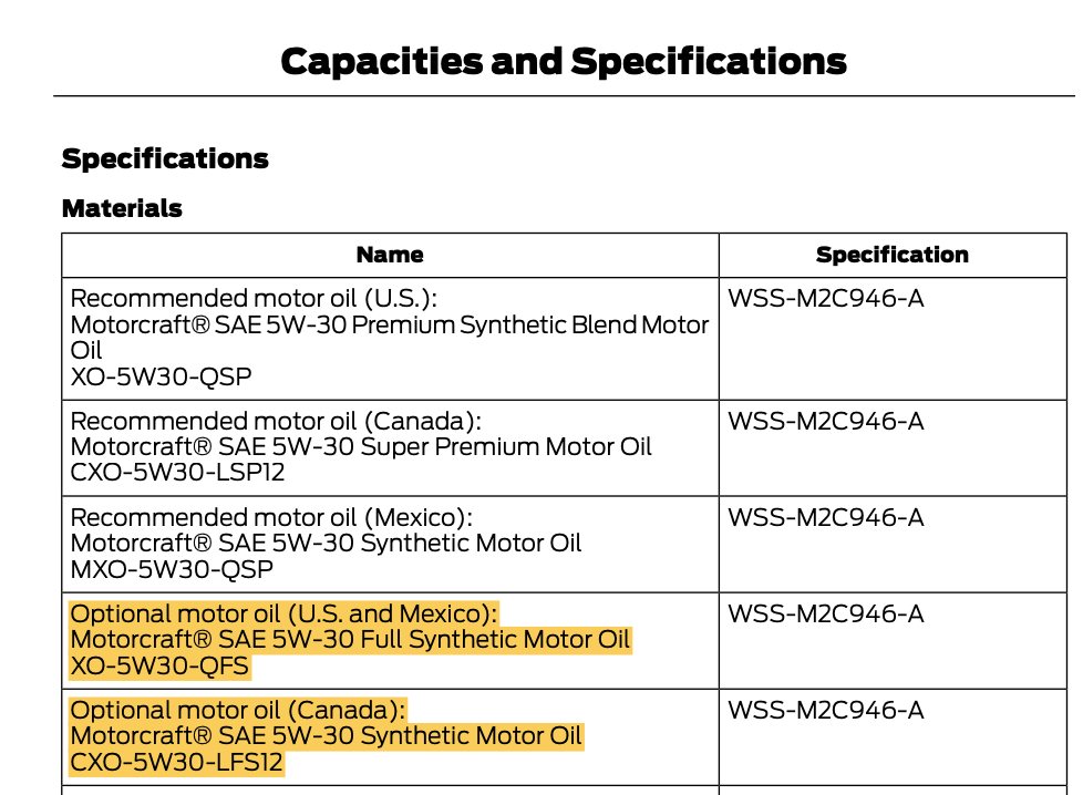

sc00by Posted July 3, 2024 Report Share Posted July 3, 2024 What ford suggests for the ecoboost motors: Engine Oil - SAE 5W-30 - Synthetic Blend Motor Oil XO-5W30-Q1SP I am honestly shocked they suggest a blended oil, for sure though it would be full syn. 1 Quote Link to comment Share on other sites More sharing options...

STBEAST Posted July 3, 2024 Report Share Posted July 3, 2024 Coming in late on this thread, the dealer uses Motorcraft 5w-30 semi synthetic and the say it is what Ford recommends. I was surprised they use semi instead of full synthetic. With the twin turbos on the ST I go about 4000 (no more than 4500) between oil changes. Past 5000 on a turbo engine seems to be pushing it a bit. Seems like if Ford recommends it, go with it??? My concern is the belt driven oil pump. I have read stories that possibly premature belt failures (followed by engine failures) could be linked to the customer using oils other than what ford recommends. I am not sure how true this is?? Makes no sense to use a rubber belt bathed in oil to drive the 'Heart" of the engine, but couldn't certain additive packages in certain oils accelerate deterioration of this critical belt? I literally have no clue how much truth there is to this, but I thought it would be good for conversation. Thanks Quote Link to comment Share on other sites More sharing options...
1004ron Posted July 4, 2024 Report Share Posted July 4, 2024 1 hour ago, STBEAST said: Coming in late on this thread, the dealer uses Motorcraft 5w-30 semi synthetic and the say it is what Ford recommends. I was surprised they use semi instead of full synthetic. With the twin turbos on the ST I go about 4000 (no more than 4500) between oil changes. Past 5000 on a turbo engine seems to be pushing it a bit. Seems like if Ford recommends it, go with it??? My concern is the belt driven oil pump. I have read stories that possibly premature belt failures (followed by engine failures) could be linked to the customer using oils other than what ford recommends. I am not sure how true this is?? Makes no sense to use a rubber belt bathed in oil to drive the 'Heart" of the engine, but couldn't certain additive packages in certain oils accelerate deterioration of this critical belt? I literally have no clue how much truth there is to this, but I thought it would be good for conversation. Thanks I doubt that your owners manual is different to mine with regards the oil spec. Full Synthetic is listed as optional - i.e. for those that want to pay for the extra protection of the full synth. 1 Quote Link to comment Share on other sites More sharing options...
handfiler Posted July 4, 2024 Report Share Posted July 4, 2024 (edited) I'll switch to Kirkland Signature 5W-30 full synthetic for my new Ranger. It meets Ford's latest standard: WSS-M2C961-A1 No concerns with my current stash of Pennzoil UP. It will be used up in my other vehicles. Out of an abundance of caution, I adhere to the recommended lubricant specifications and use Motorcraft oil filters during the warranty period. Edited July 4, 2024 by handfiler Quote Link to comment Share on other sites More sharing options...
STBEAST Posted July 5, 2024 Report Share Posted July 5, 2024 I guess it makes sense that Ford is going to only recommend Motorcraft, since it is their oil. Sales for sure. I think rather than risk the possibility of an oil pump belt failure due to using an oil NOT recommended by Ford, I will stick with Motorcraft for sure! Thanks for the info. Quote Link to comment Share on other sites More sharing options...
1004ron Posted July 5, 2024 Report Share Posted July 5, 2024 No doubt that the Motocraft oil is good, but wouldn't consider anything other than full synthetic. 1 Quote Link to comment Share on other sites More sharing options...
WyoEdge Posted July 5, 2024 Report Share Posted July 5, 2024 You can use any brand oil you care to use. As long as it meets Ford specifications. Ford cannot deny warranty if you use other than Ford oil. period. tim Quote Link to comment Share on other sites More sharing options...
