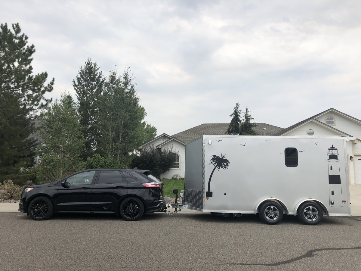

poontanghooligan Posted July 8, 2021 Report Share Posted July 8, 2021 In doing my research about towing with an Edge ST, I found very little info or experiences. So I thought I would post mine because I'm quite impressed! I think the platform is very underrated, not from a what it can't tow but from how it tows within its ratings. I am towing a 7.5x14 foot, all aluminum, v-nose, dual spread axle cargo trailer that I've converted to a camper. It was totally stripped and bare bones weighing 1,500 pounds. I insulated it, added holding tanks, paneling, vinyl floor planks, cabinets, beds, shower, propane tank, tv, refrigerator, microwave, air conditioning, etc. I think it weighs around 3,200 now but I'll be weighing it soon to make sure. Tongue weight is an estimated 350. So it would seem all within the towing specs. Now for the good parts. I have H&R lowering springs so you might be wondering, "How is the sag from all that tongue weight?". Isn't the ride harsh over bumps? So I also installed air bags and an auto-leveling pump which serves 2 purposes: the first is to take up any sag with the trailer hitched up (which was only about 2 inches) and the second is I can inflate the air bags to the max PSI so I can get better launches once I'm tuned. The trailer also has electric brakes and so even though the ST has pretty good brakes, having the trailer brakes makes stopping fast very controlled. I use a brake controller that goes inline with the 7-way plug (had to install that too) and a phone app to adjust it's settings. Works quite nicely. The ST has the 21 inch wheels and the tires are pretty low profile. Most say this is a terrible combination for towing. At the weight I'm towing, I beg to differ. I set the rear tires to 40 PSI cold and there is absolutely no squirm or wheel lip road rub when turning sharply. With the stiffer sidewalls and stiff suspension with air bags, even cross winds are comfortably handled. Towing power is crazy good. I live in the mountains and have no issue maintaining speed up any grades. I don't know the trans or engine temps while climbing, but I have the A/C on and with the temps outside over 100, there is no overheating. The ST just handles it. Acceleration from a stop is really good which helps merging in to traffic and passing power is awesome. Can't wait to get a tow tune though. So there you have it. I believe there is more the ST can handle but it's limited by the hitch specs. With a proper hitch, it could probably handle 4500 pounds safely and without unibody damage. If anyone wants a list of parts I used for setting up for towing, let me know. Cheers! 4 Quote Link to comment Share on other sites More sharing options...
poontanghooligan Posted August 2, 2021 Author Report Share Posted August 2, 2021 Finally got the trailer weighed. Came in at 3280 pounds with 440 tongue weight. Going to have to load more stuff to the rear to offload some of that. 1000 mile roundtrip next week and I'll report back mileage. 2 Quote Link to comment Share on other sites More sharing options...
poontanghooligan Posted August 14, 2021 Author Report Share Posted August 14, 2021 Returned from 1000 mile roundtrip to the Redwood Forest yesterday. Averaged 11.6 mpg doing 62 to 64 mph most of the way. There were several climbs and a lot of rolling hills. Temps were in the upper 90's until we got closer to the coast. Power and handling was great. 20 psi in the air bags, 40 psi rear tires, 35 psi front. One issue I had: every time I started an ascent, after a minute or so climbing, I got a notice indicating "AWD temporarily disabled". What causes this? There was no overheating of the PTU/diff that I could tell. No gear smell, no power loss. After the start of the descent, AWD was re-enabled and everything seemed fine. Maybe it thinks there's too much power going to the rear because of the incline? Anyone have this happen to them? Quote Link to comment Share on other sites More sharing options...

Snoking Posted August 15, 2021 Report Share Posted August 15, 2021 I kind of think you have the wrong trailer or wrong tow vehicle for such trips. Quote Link to comment Share on other sites More sharing options...

poontanghooligan Posted August 15, 2021 Author Report Share Posted August 15, 2021 3 hours ago, Snoking said: I kind of think you have the wrong trailer or wrong tow vehicle for such trips. Hmmm...I don't see why either is wrong. I am within the manufactures limits on tongue weight (340 now), max trailer weight (3280), frontal area of trailer above vehicle roofline not exceeding 30 square feet and GVWR below 5700 lbs. The trailer also has dual axels with electric brakes. The ST has additional cooling capacity as well. I'm also following the special operating conditions maintenance schedule as outlined in the manual. So how is what I'm doing wrong? Quote Link to comment Share on other sites More sharing options...
poontanghooligan Posted August 15, 2021 Author Report Share Posted August 15, 2021 (edited) 4 hours ago, Snoking said: I averaged 17.5+ at 68 MPH on a 1450 mile trip for Arizona to Washington last month. I think this is more in line with Ford's intended towing for the Edge. Nice! You have much less drag with that setup. While there might be "intended" towing, I am within all manufacturers specifications for my setup. I'm not trying to justify doing something I shouldn't. And overall, the trip went great. I had all the power I needed, braking was really good and handling was what I would expect when towing a trailer. I have a lot of towing experience (30 years) with many RV's and vehicle combinations. None of the vehicles were AWD though. So my question was around why the AWD was disabled under specific conditions, like starting up a grade. If the RDU is overheating and I am within manufacturers specs, then Ford's RDU cooling capacity is overrated. Edited August 15, 2021 by poontanghooligan Quote Link to comment Share on other sites More sharing options...

14AWD3.5 Posted September 23, 2022 Report Share Posted September 23, 2022 I cant comment about the rdu temp issues other than to note that the sail effect/frontal drag is loading the entire drivetrain in excess of a similar weight low profile trailer, thus its harder overall on the edge. While I support towing what you can with what you have, the short wheelbase and large sail area are two things which would cause me to not want to tow that trailer much at all. Definitely change your PTU fluid, at least you have a drain plug! The rear diff on our edges is pretty small. I got mine changed at 80K just for preventative measures cause’ I’ve towed 5x8 and 6x12’ Uhaul trailers a fair bit while moving. 1 Quote Link to comment Share on other sites More sharing options...

edjunior Posted July 1, 2023 Report Share Posted July 1, 2023 On 8/2/2021 at 11:59 AM, poontanghooligan said: Finally got the trailer weighed. Came in at 3280 pounds with 440 tongue weight. Going to have to load more stuff to the rear to offload some of that. 1000 mile roundtrip next week and I'll report back mileage. Have you considered a weight distributing hitch? This could help with the leveling, and then use the airbags for fine tuning. Nice job on the trailer by the way. When you get a chance, could you post some pics of the innards. Gotta see what you did inside. 1 Quote Link to comment Share on other sites More sharing options...

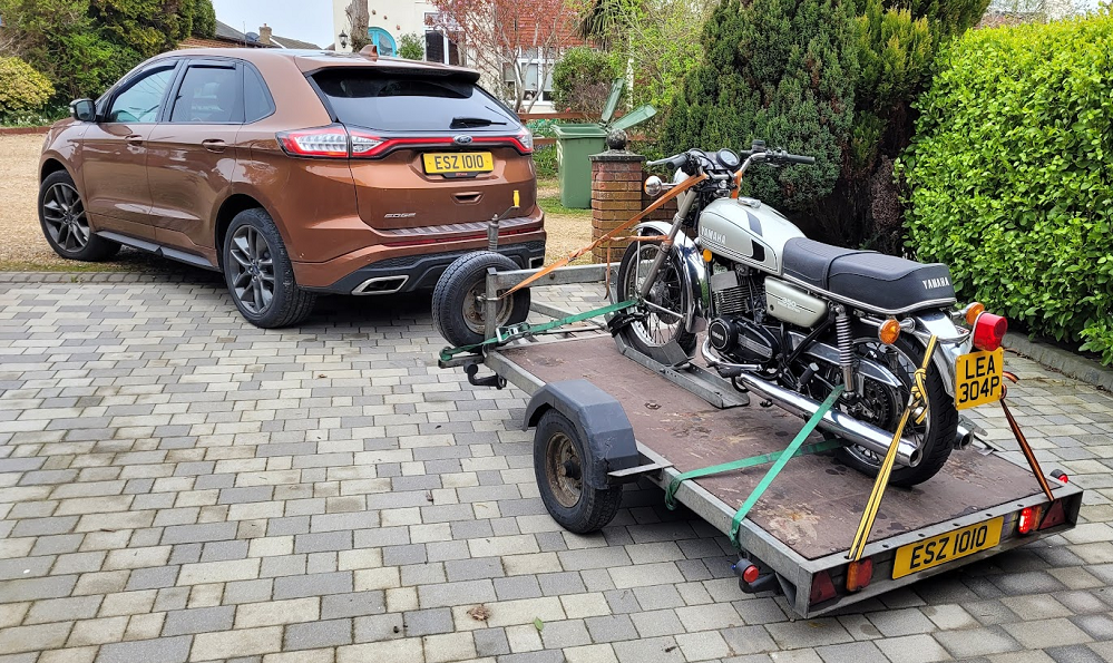

niceonept Posted July 4, 2023 Report Share Posted July 4, 2023 On 8/15/2021 at 1:26 PM, Snoking said: I averaged 17.5+ at 68 MPH on a 1450 mile trip for Arizona to Washington last month. I think this is more in line with Ford's intended towing for the Edge. Yep, agreed. Here's my only towing experience with the Edge so far. Similar. Quote Link to comment Share on other sites More sharing options...
