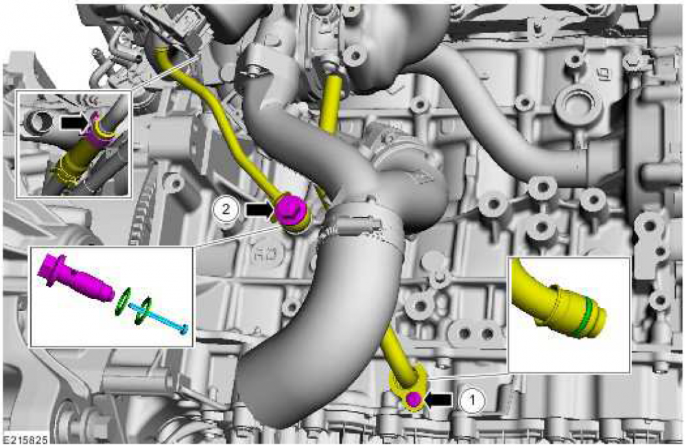

ymerameha Posted July 21, 2021 Author Report Share Posted July 21, 2021 (edited) My car is still in dealer and I don't have any pictures of turbo. My turbo is like https://spolshy.com.ua/product/9805482485/ or https://atomcarparts.co.uk/product/turbocharger-no-10009700232-for-ford-mondeo-s-max-galxy-2-0-tdci/ Page from service manual where stated to be prepared to collect escaping fluid: Maybe that helps you and thank you for info. How much do you think the turbo weighs? Edited July 21, 2021 by ymerameha Quote Link to comment Share on other sites More sharing options...
Nsohail76 Posted July 22, 2021 Report Share Posted July 22, 2021 Thanks. I fixed it today. There was a coolant hose right above the turbo that i forgot to put the clamp back on. Which i for some reason removed (not needed) Turbo approx around 18 lbs Quote Link to comment Share on other sites More sharing options...
