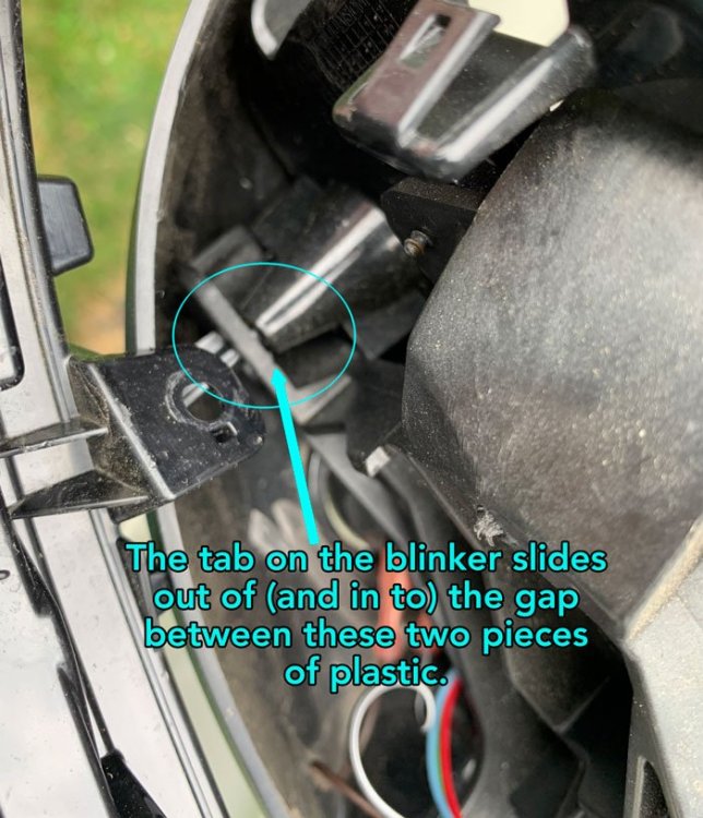

Once you pull the blinker out, you'll see a tab with a hole on the bottom of the blinker assembly where the screw went through.
That same tab on your new blinker will slide back in between the two pieces of plastic circled in my image below (don't worry, you'll quickly see it even though my image below doesn't seem very obvious).
