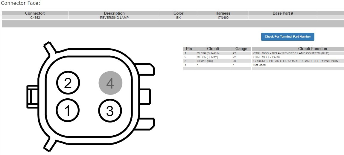

Standing outside the garage the other day, I noticed the reverse lights were really dim on my wife’s 2016 edge sel. I took everything apart and was trying to get some readings on the meter but I really wasn’t sure what the readings should’ve been. Anyone have the numbers I should be looking for? I really don’t want to spend $1000 for that whole plastic piece with the reverse lights built into it. The thing only has 22,000miles.
Perhaps the attached Diagnostic Procedure for Reversing Lamps and Reversing Lamp Connector diagram from the online 2016 Ford Edge Workshop Manual can be helpful, especially if you have capability to scan for Diagnostic Trouble Codes (DTCs)...
