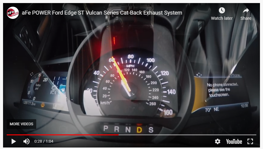

bscott94 Posted June 4, 2021 Report Share Posted June 4, 2021 I saw someone share an exhaust kit for the ST that include a video showing the sound. I notice the left screen shows boost. Is this a standard setting on the ST? Can it be enabled on a 17 Sport? Quote Link to comment Share on other sites More sharing options...

omar302 Posted June 29, 2021 Report Share Posted June 29, 2021 On 6/28/2021 at 12:32 PM, WWWPerfA_ZN0W said: torque pro has been more versatile for ecoboosts than forscan, but that won't help with module programming Expand I believe what OP meant with ForScan is he tried to enable the feature using the module configuration in ForScan, there is an option for that but it does not work probably because the Edge's IPC firmware does not have that feature. My guess he'd have to flash the firmware of a 2019+ ST to get the cluster to function similarly (if even possible). ForScan does have a a lot of PIDs and, if i remember correctly, 2 for the boost pressure (commanded & actual) which can be displayed as gauges. Quote Link to comment Share on other sites More sharing options...
Special_K Posted June 29, 2021 Report Share Posted June 29, 2021 On 6/29/2021 at 4:25 AM, omar302 said: I believe what OP meant with ForScan is he tried to enable the feature using the module configuration in ForScan, there is an option for that but it does not work probably because the Edge's IPC firmware does not have that feature. My guess he'd have to flash the firmware of a 2019+ ST to get the cluster to function similarly (if even possible). ForScan does have a a lot of PIDs and, if i remember correctly, 2 for the boost pressure (commanded & actual) which can be displayed as gauges. Expand I really wanna know if i can enable this on a Sport....who is gonna be the Guinea pig Quote Link to comment Share on other sites More sharing options...
jmr061 Posted June 29, 2021 Report Share Posted June 29, 2021 Back in Dec of 19 I bought a cluster from a 19 ST and put it in my 16 Sport and the Sport did not pass the data to the cluster to get the boost gauge to work. 1 Quote Link to comment Share on other sites More sharing options...
