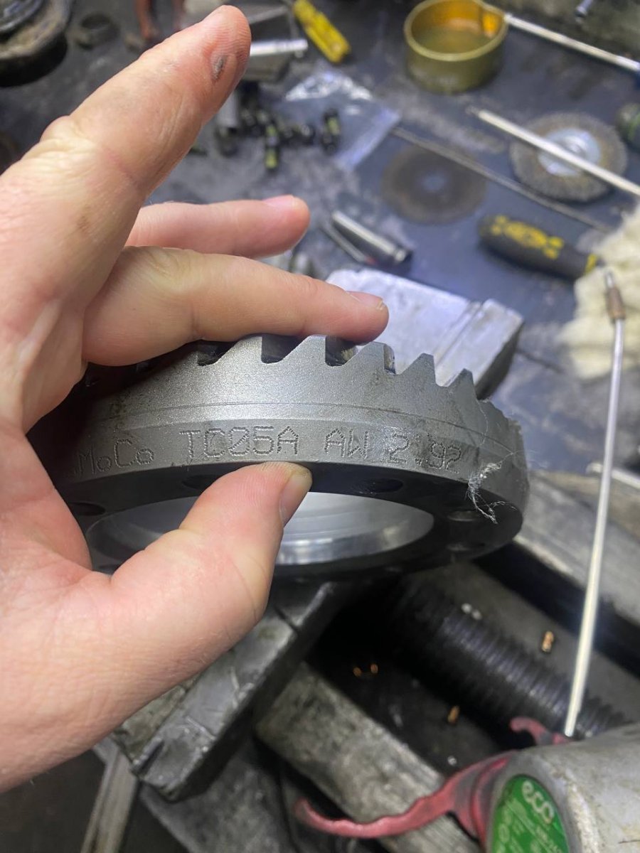

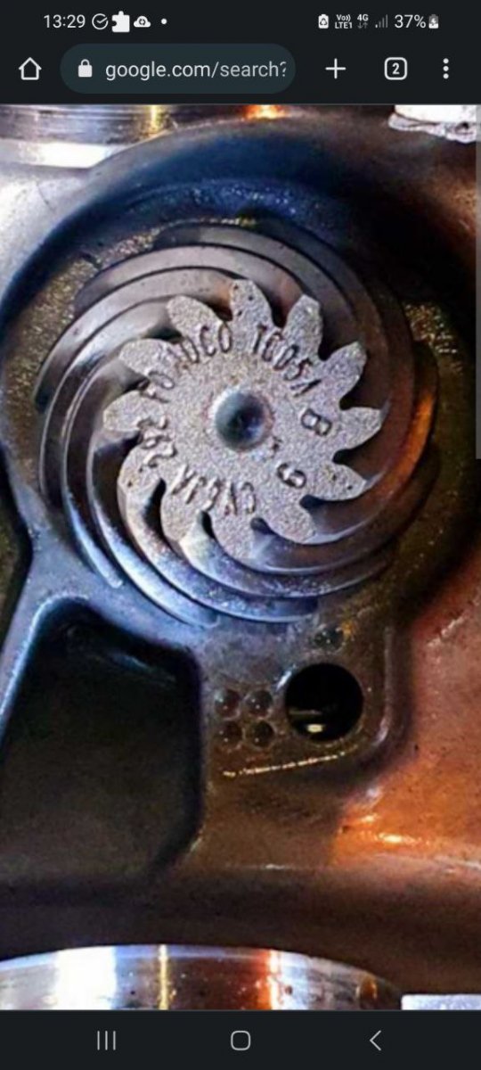

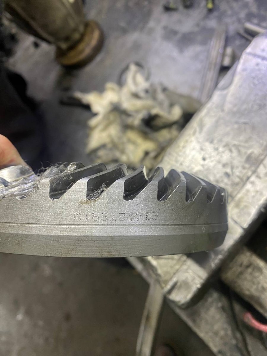

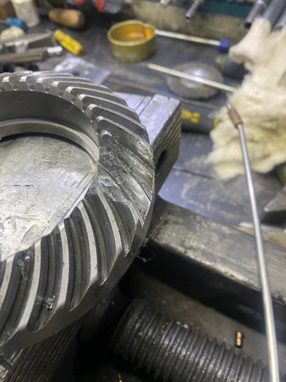

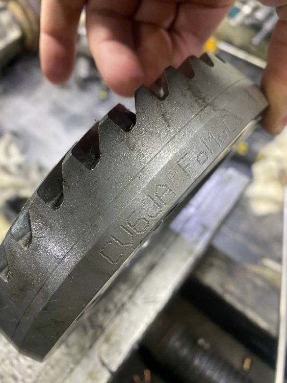

I'm also trying to solve the problem with the AWD machine of 2013! I studied this topic as much as possible and concluded that the rear gearbox from 2011 is not suitable, since its gear ratio is 2.91 and on my gearbox it is 2.92!!!! It is not possible to find a new or used S 154 A or S 154 D!!! CAN someone give me some advice on what to do?  Can someone share a link where you can order the gears of the main pair of the rear gearbox separately?
