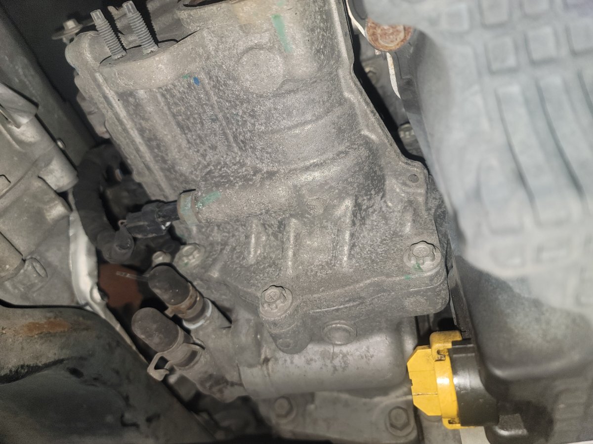

ST Road Runner Posted June 17, 2023 Report Share Posted June 17, 2023 My 2019 Edge ST has two rubber caps as highlighted by the 2 red arrows. Are these where a cooling unit would connect? Irritating that 2018s have a drain plug and for 2019 they dropped it. 1 Quote Link to comment Share on other sites More sharing options...
Fingernip Posted June 21, 2023 Report Share Posted June 21, 2023 (edited) On 6/17/2023 at 5:41 PM, ST Road Runner said: My 2019 Edge ST has two rubber caps as highlighted by the 2 red arrows. Are these where a cooling unit would connect? Irritating that 2018s have a drain plug and for 2019 they dropped it. Expand Is this a US spec edge? My 2019 has the additional cooling for the PTU. All marketing material listed it as a liquid cooled PTU for the ST in my region (Newengland) Edited June 26, 2023 by 1004ron Quote Link to comment Share on other sites More sharing options...
CTEdgeST Posted June 22, 2023 Report Share Posted June 22, 2023 (edited) Yes, that is a PTU cooler with the ports plugged. My 2020 ST has a simple plug that was installed rather than the capped cooler. It appears that your Edge was built at some time during the transition from cooled to non cooled PTU's in Edge ST's This is what the cooler looks like: https://www.rockauto.com/en/moreinfo.php?pk=11176489&cc=3444713&pt=2088&jsn=565 Read this link for my experiences, Ford diagrams and part numbers: https://www.fordedgeforum.com/topic/31746-2020-edge-st-ptu-fluid-drain-fill/ Edited June 22, 2023 by CTEdgeST 3 1 Quote Link to comment Share on other sites More sharing options...

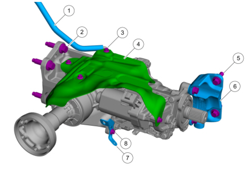

WilkiST Posted May 15, 2024 Report Share Posted May 15, 2024 Very interesting thread here. I just got my 2022 ST and am very interested in PTU related issues. So far i know PTUs on 2019+ Edges are way different to the one in previous years. I hope i will be able to look under my car in some days and provide with real photos. For the moment this what i found regarding PTUs for confused owners, like me. PTU description: The Power Transfer Unit (PTU) is a gearbox that attaches to the transmission. The PTU directs power from the transmission differential case through a dog clutch to a hypoid ring gear. A hypoid pinion gear is meshed to the ring gear and splined to the output flange. A dog clutch is used to transfer drive torque from the input shaft to the ring gear. When the dog clutch is released, no torque is transferred through the ring gear and pinion to the rear driveshaft. When the dog clutch is engaged, normal AWD function is achieved by directing torque to the rear wheels as needed to prevent or control wheel slip and improve handling There are two different models of the PTU. The low torque PTU is paired with the 8F35, 8F40, and MMT6 transmissions. The high torque PTU is paired with the 8F57 transmission. The low torque and high torque PTUs are similar in design and operation. And some drawings: Item & description: 1 - Vent tube. Unique routing for each powertrain. 2 - PTU to transmission bolt for 8F35/40 & MMT6. One-time use. 2 - PTU to transmission bolt for 8F57. One-time use. 3 - Heat shield bolt 4 - Heat shield 5 - PTU to engine bracket bolts. Unique parts for each powertrain. 6 - 7B664 PTU to engine bracket. Unique parts for each powertrain. 7 - Oil temperature sensor harness bracket (If equipped). 8 - Oil temperature sensor harness bracket bolt PTU cooling system - if equipped: Item & description 1 - Fan and bracket assembly 2 - Fan and bracket assembly bolt Item & description 1 - Oil-to-Coolant cooler stud. One-time use, part of 7P159 kit. 2 - Oil-to-Coolant cooler. Part of 7P159 kit. And operating modes description: Power Transfer Unit (PTU) Operation The PTU has four (4) distinct modes of operation: Connected, Connecting, Disconnected, and Disconnecting. Each mode is commanded by the AWD module. The PTU contains a reversible DC motor and two hall effect position sensors. The motor moves the shift fork which connects or disconnects the dog clutch collar. PTU Position sensor A monitors the position of the actuator cam. PTU Position sensor B monitors the position of the shift fork. Some PTU models are equipped with an oil temperature sensor Connected Mode Connected Mode is the default mode for the PTU. The AWD module will command Connected mode at the beginning of each key cycle. In connected mode, the fork and dog clutch collar are positioned towards the RH side of the PTU. The dog clutch is engaged. The driveshaft is rotating at an overdrive ratio compared to the front axle shafts. Torque is available at the RDU. Connecting Mode To connect the PTU, the two halves of the Dog clutch must be within 40 RPM of each other. The AWD module calculates the speed differential based on transmission OSS, RDU Driveshaft Speed, and PTU gear ratio. The actuator motor will energize and rotate the gear reduction drive and the actuator cam against the actuator fork. When the dog clutch teeth line up, the cam pushes the actuator fork into position and the clutch engages. It can take approximately 100 - 150ms for the dog clutch to engage after the command is sent. Disconnected Mode The AWD module will command disconnected mode based on vehicle conditions. The purpose of the disconnected mode is to reduce drag losses from spinning the driveshaft when conditions indicate AWD will probably not be needed in the near future. In disconnected mode, the fork and dog clutch collar are positioned towards the LH or transmission side of the PTU. The dog clutch is disengaged. Disconnecting Mode To disengage the PTU, no torque can be routed through the dog clutch. That is, the RDU must be completely disengaged. Depending on vehicle conditions, the AWD module may keep the PTU engaged for the remainder of the key cycle. The actuator motor will energize and rotate the gear reduction drive and pull the actuator cam away from the actuator fork. When the dog clutch collar has moved far enough to the LH or transmission side, the dog clutch teeth disengage. Wondering if i have one on mine. Have fun guys! Quote Link to comment Share on other sites More sharing options...
Replicator Posted October 6, 2024 Report Share Posted October 6, 2024 Went to change my PTU fluid yesterday and noticed the PTU Cooler isn't connected to anything. I thought the ST starting in 2019 had the PTU Cooler? What would be needed to connect this? 2019 ST manufactured in July 2019 in the US and sold in US. 1 Quote Link to comment Share on other sites More sharing options...

STBEAST Posted December 27, 2024 Report Share Posted December 27, 2024 (edited) Replicator. Those 2 plugs are where the COOLANT hoses would hook up to circulate coolant through the cooler. So, no you cannot drain the ptu fluid by removing the caps. Looks like that was during the transition stage to the liquid cooled ptu system. From 2019 on they also added a cooler and an electric motor that would circulate coolant through the ptu to help with heat. I verified this on my 2021 ST. I just traded in for a 2024 and the PTU system identical. I also found that when you shut the car off, this electric motor continues to run for a few minutes, circulating coolant through the ptu, to help with heat soak. The newer style also have a temperature sensor install where the fill would be. All I can say is if they are using HOT coolant to help with the ptu failures, these things must be getting hot! Edited December 27, 2024 by 1004ron Quote Link to comment Share on other sites More sharing options...
