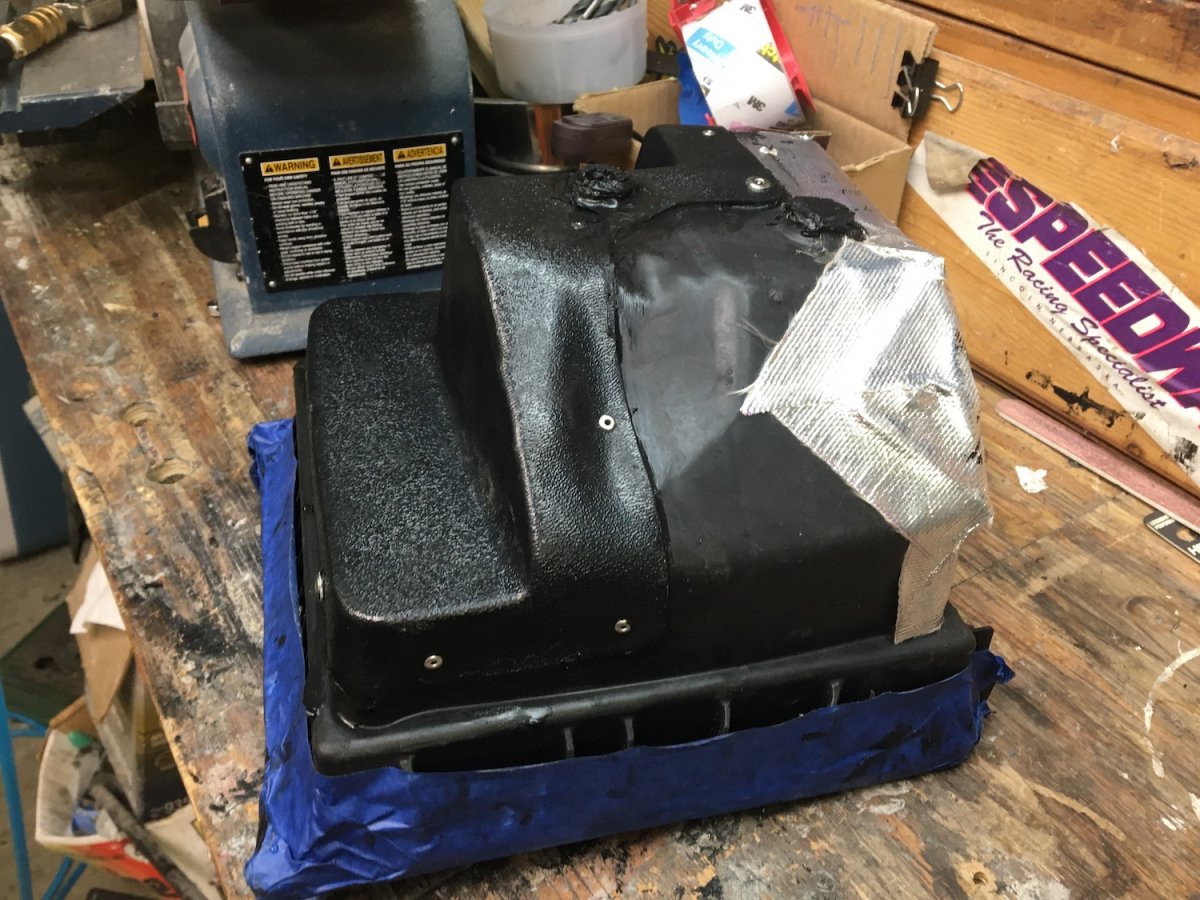

Xtra Posted September 22, 2021 Author Report Share Posted September 22, 2021 Here is a test fit the patch before I took a heat gun and formed it to create a super tight fit. 2 Quote Link to comment Share on other sites More sharing options...

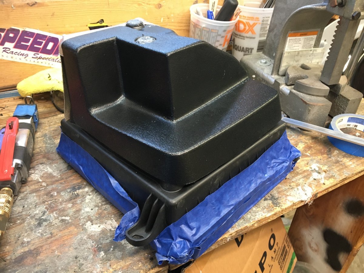

Xtra Posted September 22, 2021 Author Report Share Posted September 22, 2021 (edited) The black RTV is super messy ( I think I said that before ) anyway, this is the final attached patch after using the heat gun, RTV, and rivets to secure it in place. Sealed air tight and ready to be covered by nice shiny heat shield. If all goes well It could be finished and installed by tomorrow evening. The blue painters tape is there to protect the finish from scratches while working on it. Edited September 22, 2021 by Xtra 4 Quote Link to comment Share on other sites More sharing options...

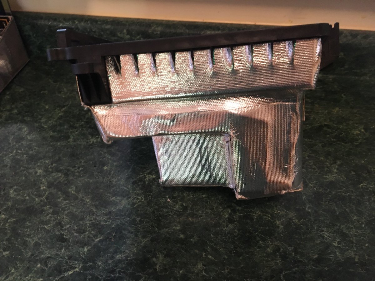

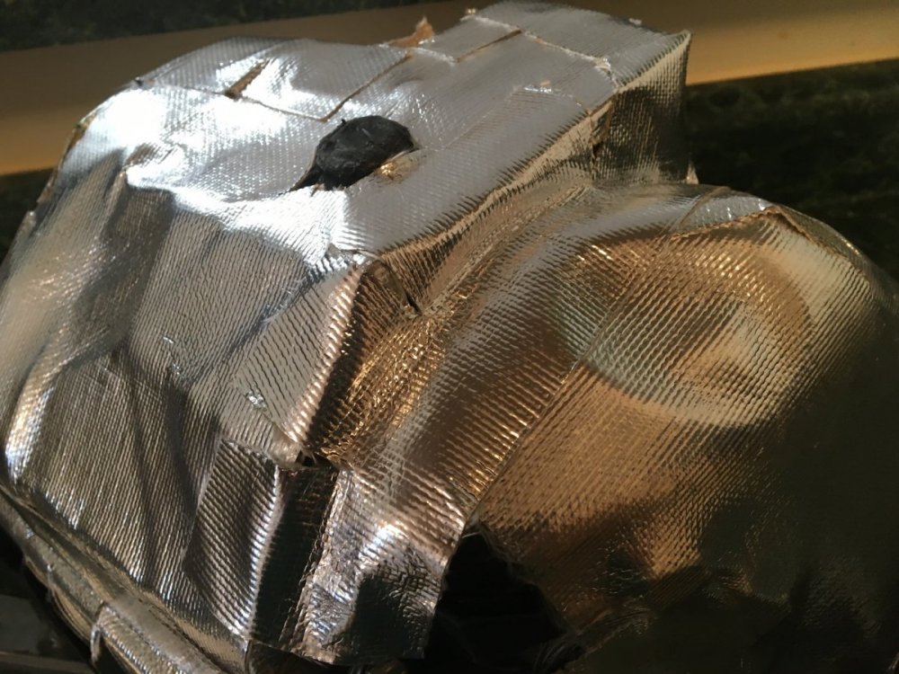

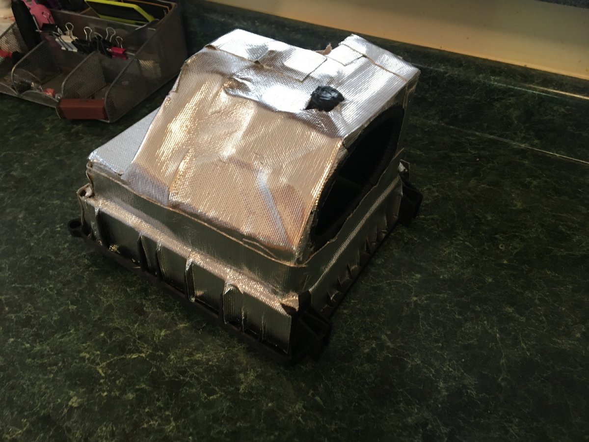

Xtra Posted September 22, 2021 Author Report Share Posted September 22, 2021 (edited) Just finished insulating the bottom half. There are a lot of curves and corners to wrap. It took three 2ft X 1ft sheets to cover the bottom half and the snorkel with the Thermo-Tec material. It is said to reflect 90% of the heat. So it should help with intake temps.... I hope. In this photo you can see that one foot is uncovered and one is covered. I did this to see what works better. Edited September 23, 2021 by Xtra 1 Quote Link to comment Share on other sites More sharing options...

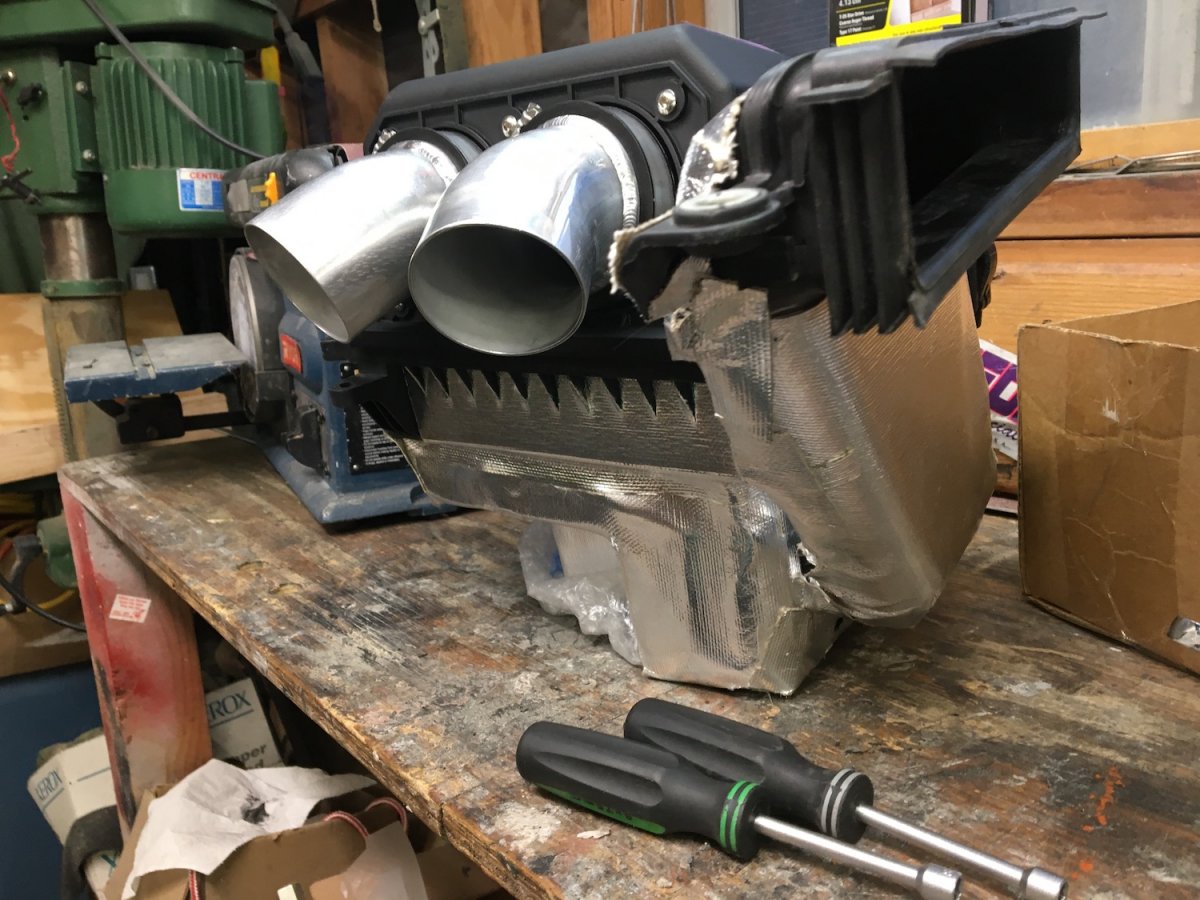

Xtra Posted September 22, 2021 Author Report Share Posted September 22, 2021 (edited) Attached the snorkel, bolted it on and sealed it to the bottom half. I need to press down the insulation a bit better, otherwise it is good to go. Edited September 22, 2021 by Xtra 2 Quote Link to comment Share on other sites More sharing options...

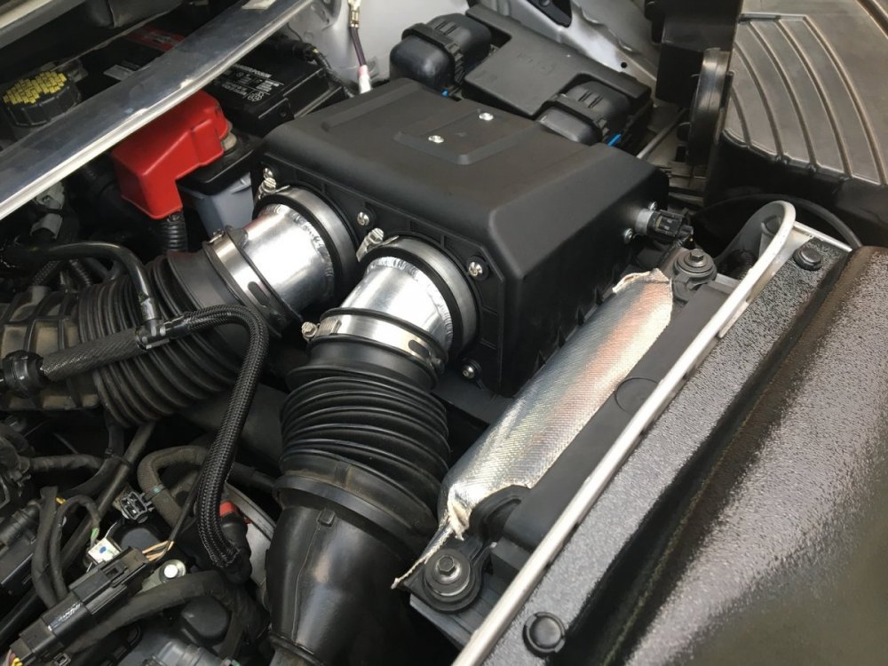

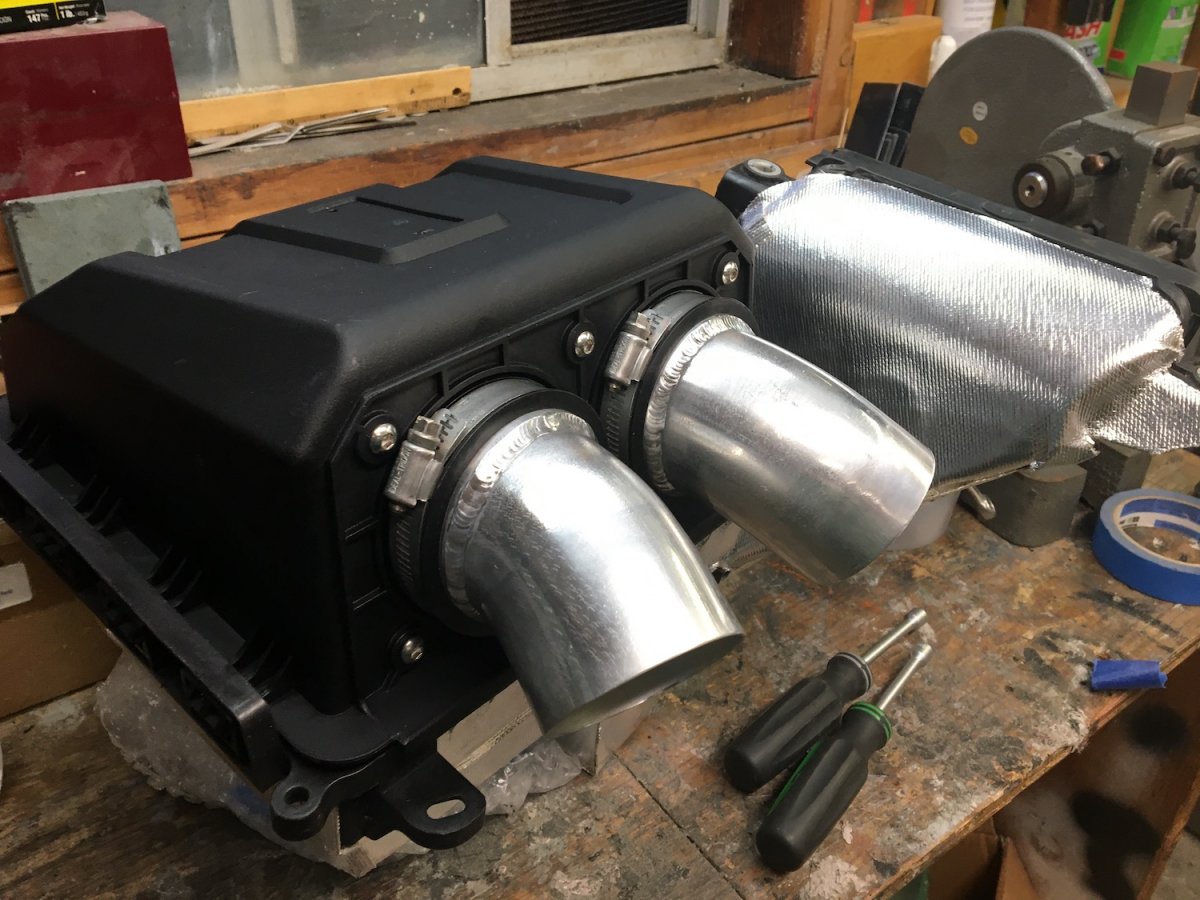

Xtra Posted September 23, 2021 Author Report Share Posted September 23, 2021 (edited) The V3 completely assembled ready for installation. Ran out of light so will install tomorrow. Edited September 23, 2021 by Xtra 4 1 Quote Link to comment Share on other sites More sharing options...

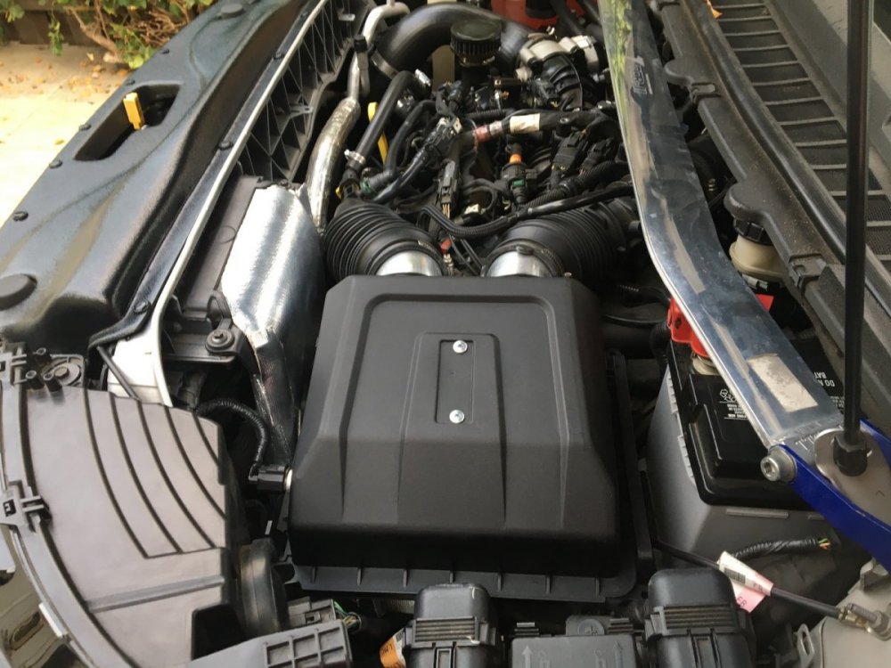

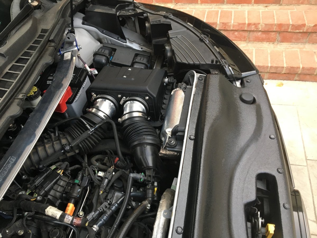

Xtra Posted September 25, 2021 Author Report Share Posted September 25, 2021 (edited) The V3 is finished and installed. Tomorrow I take a 300 mile test drive. The family decided to tag along so it better not give any problems considering there will be my 2 grand kids, their mom, and my wife in the car. Any fails and I will be sleeping on the couch. LOL Anyway here are the photos of the V3 installed with the custom bottom half. I still need to develop the Adaptor plate, but for now it is time to test. Oh! and the car is now running great, it was the spark plugs causing the problem. Some of the plugs gap had opened considerably causing a misfire under boost conditions. They were gapped at .029 when installed and they opened up to almost ,040 that allowed the boost to blow out the spark like birthday candles. Fits like a glove Edited September 25, 2021 by Xtra 1 1 Quote Link to comment Share on other sites More sharing options...

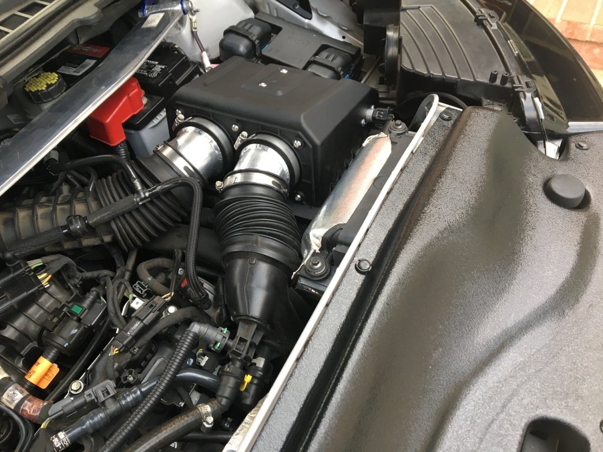

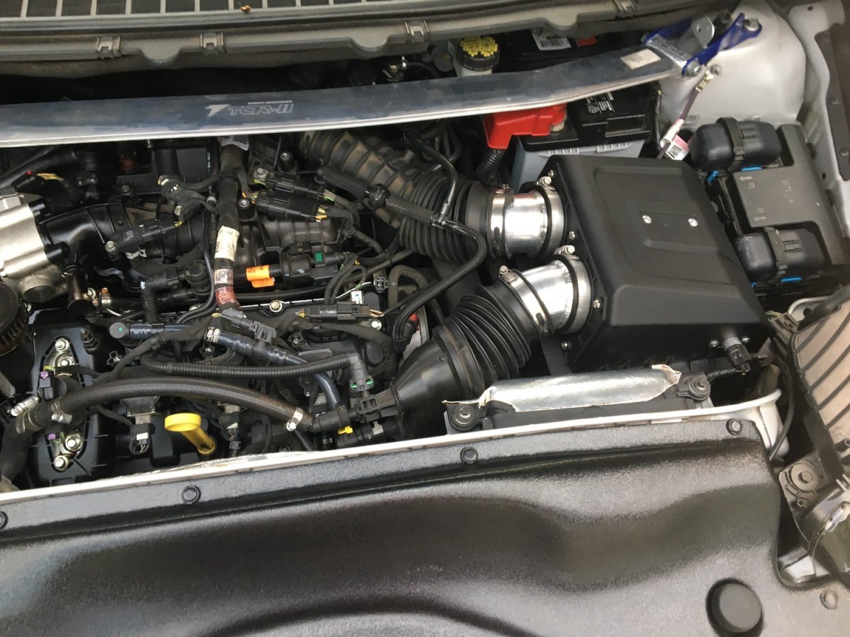

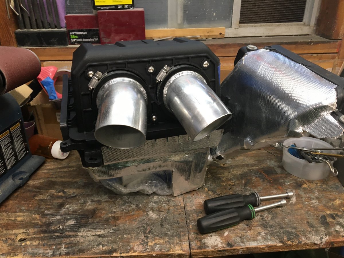

Xtra Posted September 25, 2021 Author Report Share Posted September 25, 2021 (edited) Here are some more photos ..just because it took so long to get to this point. The V2 and V3 working together to create a complete system . Tight fit with no room to spare.. Edited September 25, 2021 by Xtra 2 1 Quote Link to comment Share on other sites More sharing options...
handfiler Posted September 25, 2021 Report Share Posted September 25, 2021 Looks amazing. You're a true hand filer! 1 2 Quote Link to comment Share on other sites More sharing options...
WWWPerfA_ZN0W Posted September 25, 2021 Report Share Posted September 25, 2021 those r some saucy pics right there. i see you put some insulation as well? best of luck, hope it runs well and runs hard. 2 Quote Link to comment Share on other sites More sharing options...

Xtra Posted September 25, 2021 Author Report Share Posted September 25, 2021 (edited) Just completed the first half of the test drive. The car rans great even with 5 on board and the AC on. Managed 2 more MPG than the last time I did this same drive. Edited September 25, 2021 by Xtra 2 Quote Link to comment Share on other sites More sharing options...
Xtra Posted September 25, 2021 Author Report Share Posted September 25, 2021 It is hard to say how much of that 2 mpg is from the V3 and how much is from the fresh plugs. The first time I did the drive there was only two people in the car and the car was running fine. I wish that I could have just tested the V3 alone, but the plugs had to be done. The V3 has been working well and has not moved or made any rattling noises or vibration . Nothing has come loose or any interfere problems found. I would give it a thumbs up as it is working as designed 2 1 Quote Link to comment Share on other sites More sharing options...
