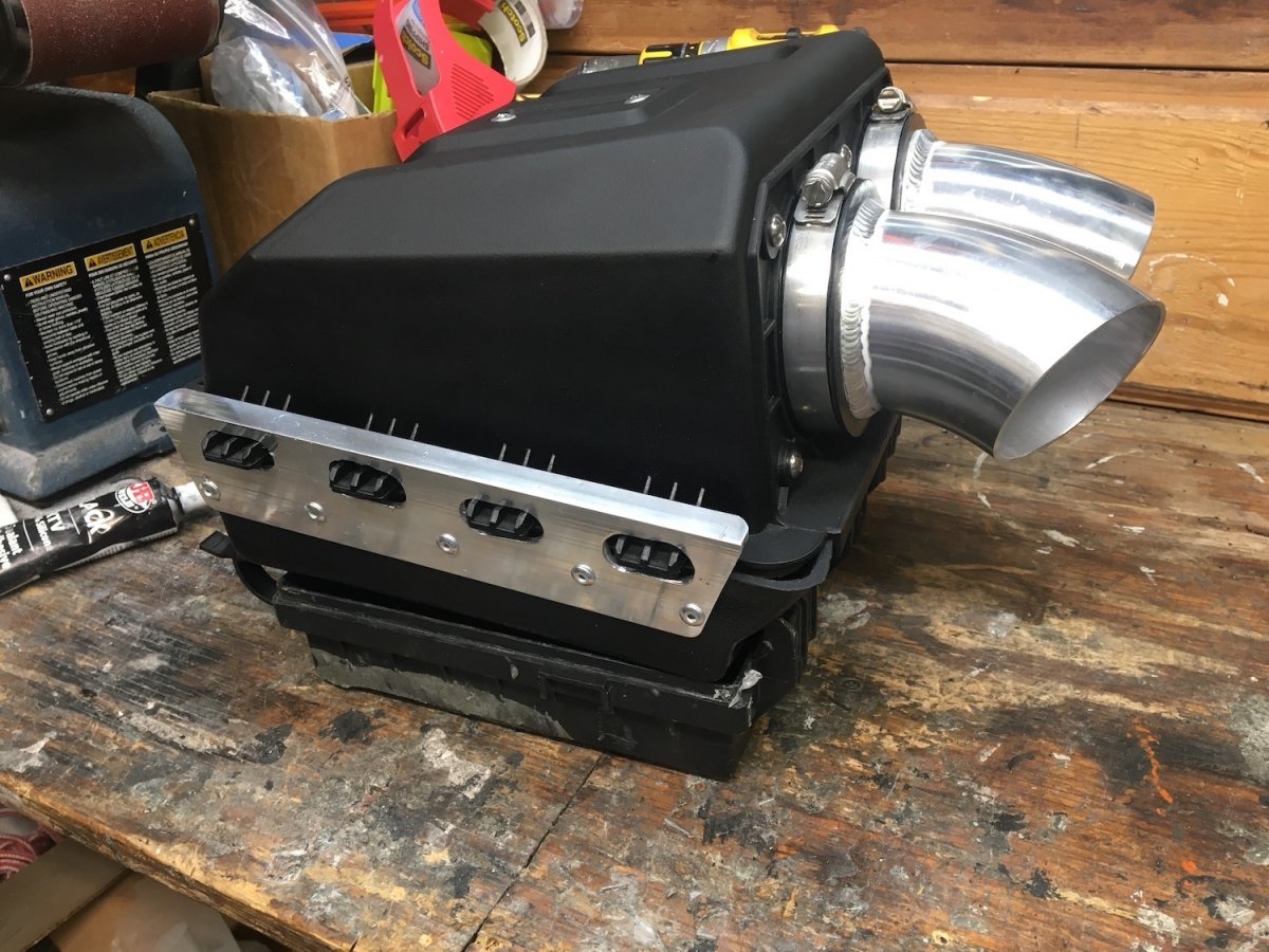

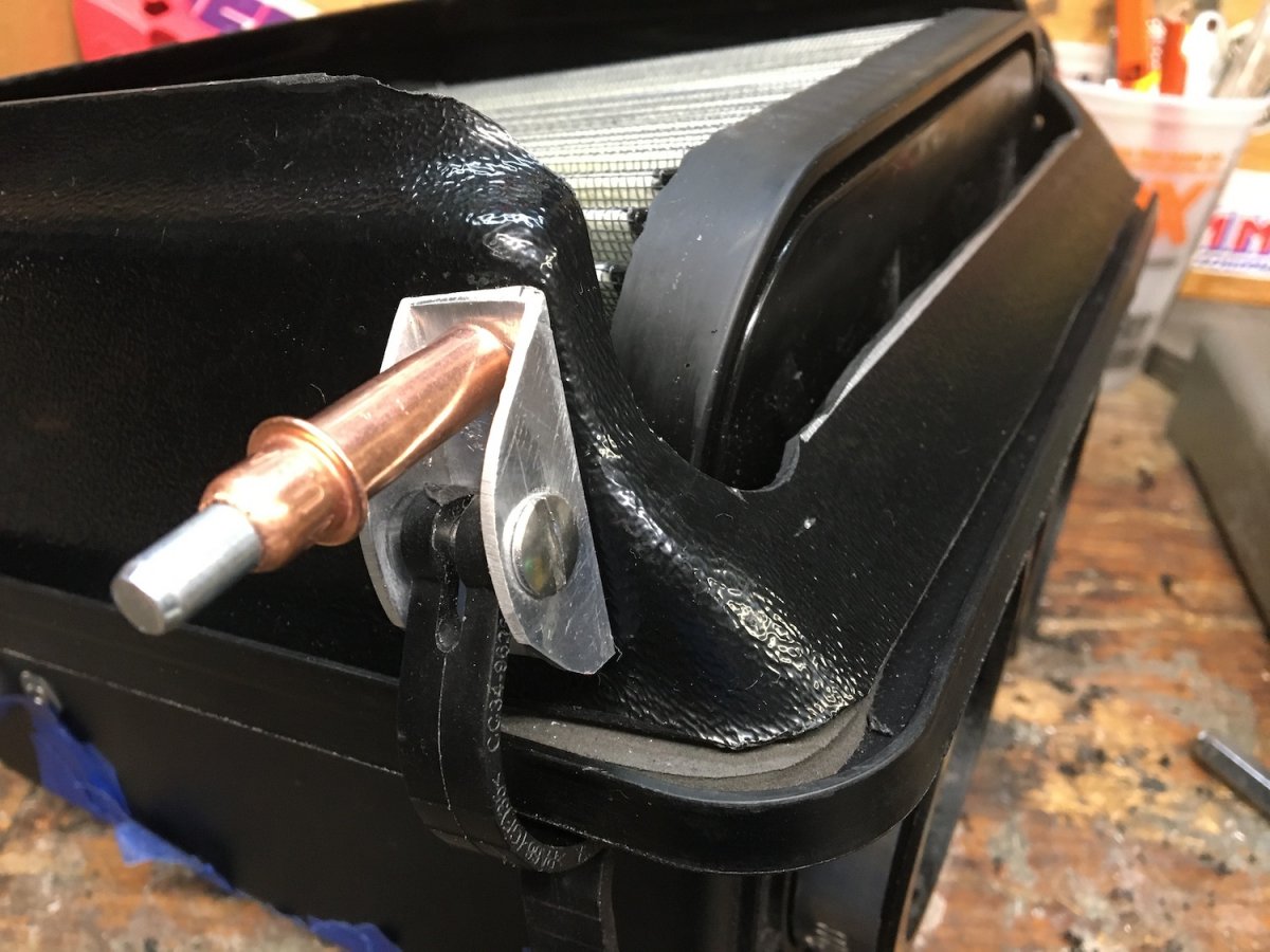

Xtra Posted January 19, 2022 Author Report Share Posted January 19, 2022 (edited) Have put in some time on the Adaptor Plate and have sorted out the latches. I still have to rebuild the mold before it is ready. Edited January 20, 2022 by Xtra 1 Quote Link to comment Share on other sites More sharing options...

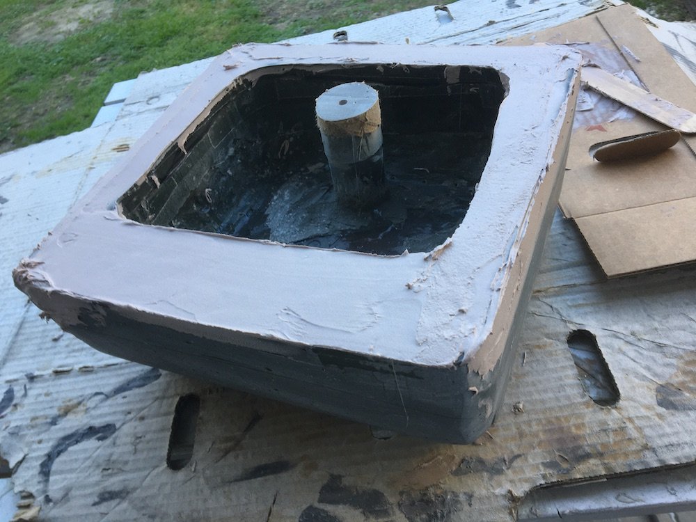

Xtra Posted January 25, 2022 Author Report Share Posted January 25, 2022 I have been working on the Adaptor mold, making some major changes to it. It is still a ways off from being done but progress continues. 1 Quote Link to comment Share on other sites More sharing options...

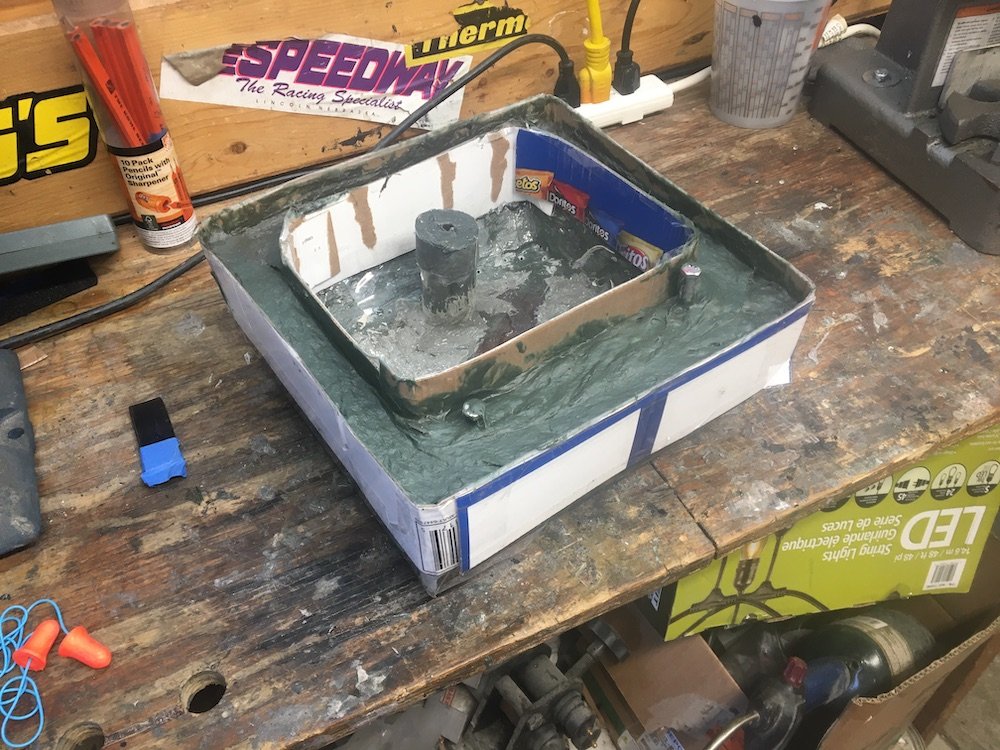

Xtra Posted January 28, 2022 Author Report Share Posted January 28, 2022 (edited) Here are some photos of the work being done I use cardboard with packing tape on it to create a mold. The packing tape acts as a mold reliese, the fiberglass will not stick to it. The mold needed to be made taller because the bottom edge of the ABS was not pulling in completely when I changed up to the thicker material. This curve at the bottom edge had to be cut off thus making the part shorter and causing an interference problem with the filter. When the cardboard is removed it looks like this. You can see the one inch that I added to the height. I use hot melt glue to attach the cardboard to the mold. It sticks fast and holds strong enough to do the job, but any residue can be removed easily and pulls right off. Once the mold was cleaned up I used bondo to create a flat base and fill any low parts. A little sanding and it will be one step closer to making another test part. Edited January 28, 2022 by Xtra 1 Quote Link to comment Share on other sites More sharing options...
Xtra Posted January 28, 2022 Author Report Share Posted January 28, 2022 (edited) Here you can see how the filter interferes with the old mold as well as the slight curve out along the bottom edge of the adaptor. By raising the mold one inch and squaring off the front edge, I hope to gain the space needed. Edited January 28, 2022 by Xtra 1 Quote Link to comment Share on other sites More sharing options...

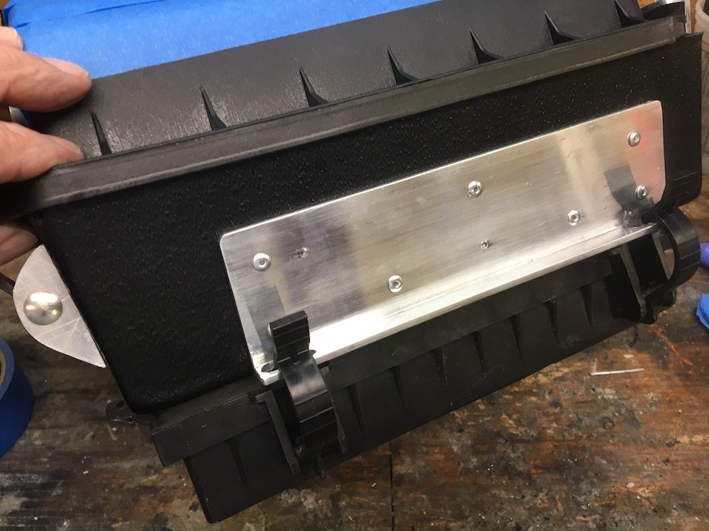

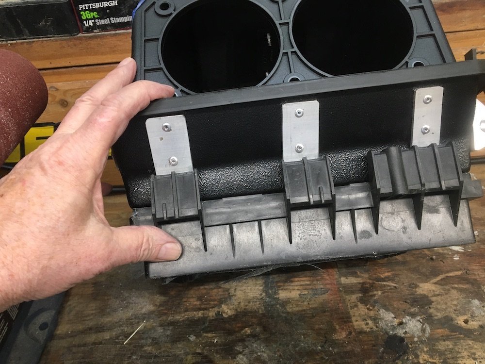

Xtra Posted January 28, 2022 Author Report Share Posted January 28, 2022 (edited) I worked on the clamping system and this is a prototype using the original mold. All the parts fit and hold the three parts together nicely. They go together quickly and easily without tools. Now that I know it works I just need to make it look better. Good thing is most of the latches will not be visible once the V3 is installed in the car. This is what I call the gate and it attaches the lid to the Adaptor. Don't worry about the gaps between the Adaptor and the lid. They are being addressed with the rebuild of the mold. These are the latches that are on the opposite side of the gate. Once these are clipped the lid is firmly attached to the Adaptor. This is how the OEM Air Box is clipped to the Adaptor. Small groves are machined into the aluminum for the latches to catch on. It may be changed into two catches instead of one long one This is the opposite side showing how the OEM Air Box is attached to the Adaptor plate. Once the Adaptor is lacted into place it holds solidly and connects all three parts together ( Lid, Adaptor and OEM Air Box ) without rattles or movement. High density rubber gaskets seal it up air tight. If I can make this work it will simplify iinstallation, cut costs, and should fit every Edge with a 2.7EB or 3.0TT no matter the year. Heck, this might fit other Fords with the 2.7EB, if they use the same Air Box and filter as the Edge. Will have to do some research that possibility. Edited January 28, 2022 by Xtra 1 Quote Link to comment Share on other sites More sharing options...

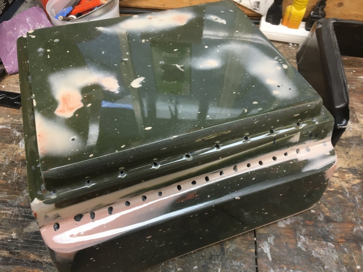

Xtra Posted February 9, 2022 Author Report Share Posted February 9, 2022 (edited) Getting closer. Today, I put on a clear resin gloss coat and let it dry throughly. Then all the vacuum holes were drilled and cleared with compressed air. After it dried... let the sanding begin. Started with 120 then 320 dry sandpaper to smooth out the finish. Next it was completely wet sanded 4 times over, starting with 400 grit then working my way through 600, 1000 , and 1200 wet sandpaper before I hit with a polishing compound. All that remains is work on the bottom side Two new mounting T-nuts need to be installed and vacuum slots need to be cut into the foot before it is ready to mount to the wood base. It's so shiny I need sunglasses...lol Edited February 9, 2022 by Xtra 3 Quote Link to comment Share on other sites More sharing options...
