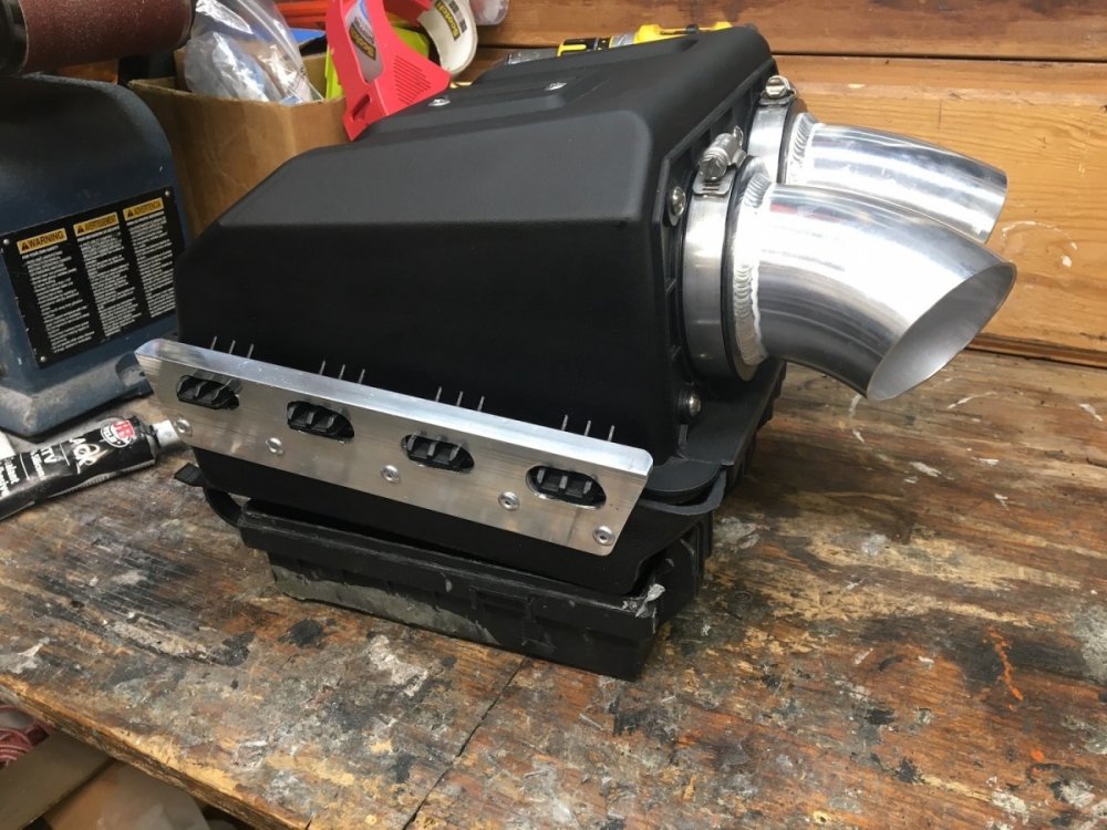

Xtra Posted November 12, 2021 Author Report Share Posted November 12, 2021 (edited) Attached the gate to the Adaptor and the clips to hold the top in place. There is a large gap that will require some work on the mold to correct. The gap can be seen just in front of the gate under the elbow reducers. The thicker material looks like it will work and be strong enough to do the job. The Adaptor is still in the prototype stage It is my hope that this is the answer for the ST. The mold will have to be modified to correct the problem. From top to bottom 1. The V3 lid and filter . 2. The Adaptor Plate, and at the bottom 3. the top of the OEM bottom half. Edited November 12, 2021 by Xtra 2 1 Quote Link to comment Share on other sites More sharing options...
Xtra Posted November 13, 2021 Author Report Share Posted November 13, 2021 (edited) This is what the patch coves, and why the bottom half is cut the way it is. The V3 uses every bit of space, it is touching on the bottom, and on the right side of the photo, a fuse box? There is only a small gap between the snorkel, and it is pushing the limits on attaching the accordion hoses as well. See how they extend into the Bottom Half, there is still room needed for the Reducer Elbows to attach them. Somehow it fits. Edited November 13, 2021 by Xtra 1 1 Quote Link to comment Share on other sites More sharing options...

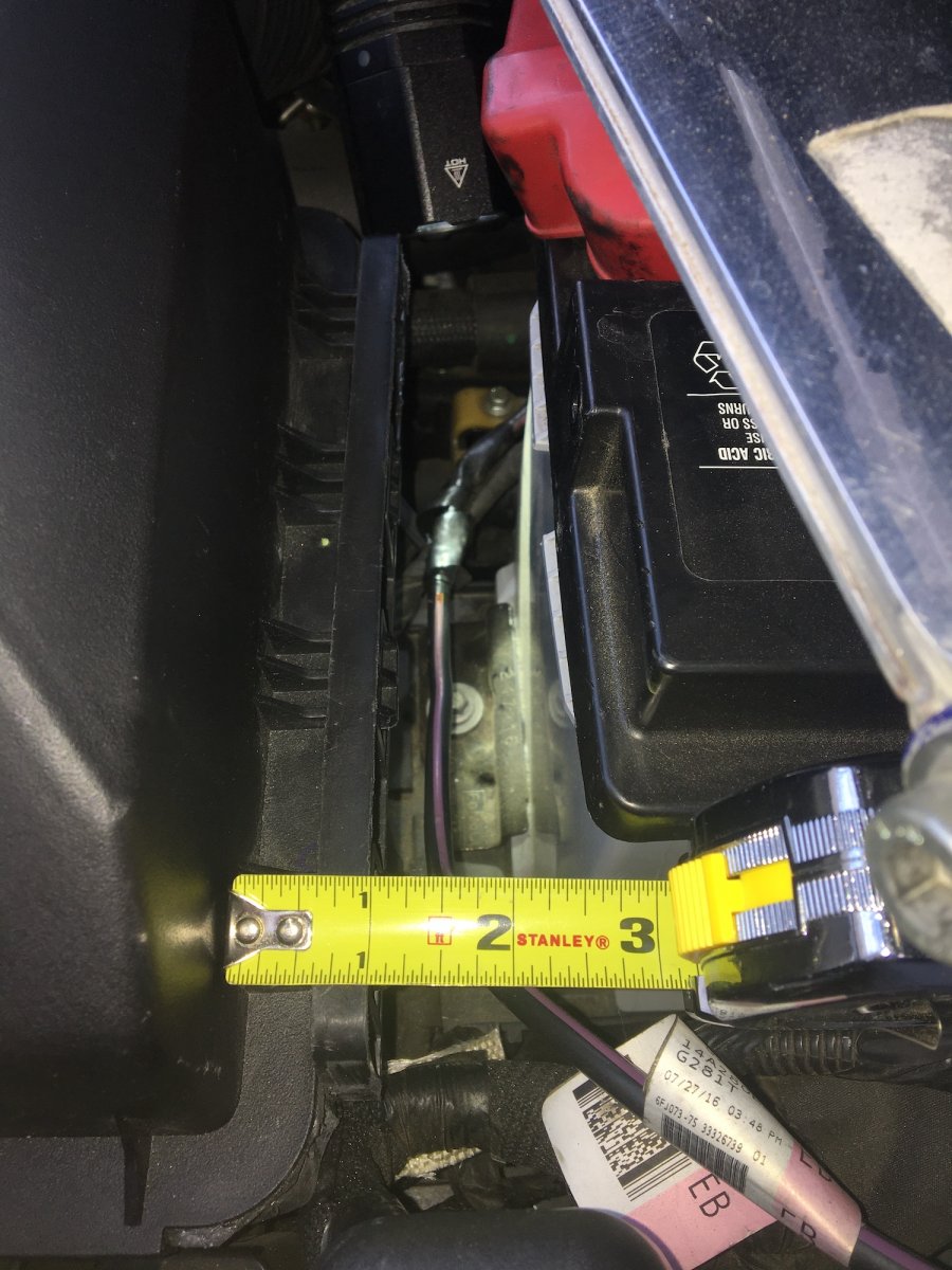

Xtra Posted November 17, 2021 Author Report Share Posted November 17, 2021 Decided to check out the clearance on the battery tray. In the photo is an H6 battery. The H6 is 10.94 L X 6.89 W X 7.48 T. The H7 is 12.40 L X 6.89 W X 7.48 T . The only difference is H7 is 1.46 inch longer than the H6. The clearance between the H6 and the V3 is right around 1.5 to 1.75 inch. It will be a super tight fit but it looks like the H7 battery will work with the V3. We will find out for sure in a few weeks. 2 Quote Link to comment Share on other sites More sharing options...

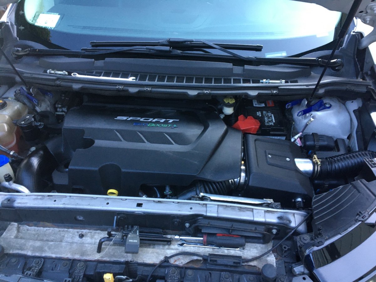

Xtra Posted December 11, 2021 Author Report Share Posted December 11, 2021 (edited) Test fit the engine cover with the V3 installed. I do not like the way it looks as it covers up the Elbow Reducers. The cover also did not sit down properly as the V3 sits higher than the OEM air box. Edited December 18, 2021 by Xtra 3 Quote Link to comment Share on other sites More sharing options...
Xtra Posted December 18, 2021 Author Report Share Posted December 18, 2021 (edited) I think that by trimming the engine cover along this natural line might let it fit properly and still show off the V3. I just might do that myself to find out. Edited December 18, 2021 by Xtra 1 Quote Link to comment Share on other sites More sharing options...
Xtra Posted December 18, 2021 Author Report Share Posted December 18, 2021 (edited) Well it turns out that the engine cover does fit without any trimming it at all. But I did it anyway lol .. I still like it better without the engine cover. Perhaps it is because I am use to seeing it without the cover on. I will leave it like this for awhile. Edited December 18, 2021 by Xtra 1 1 Quote Link to comment Share on other sites More sharing options...
