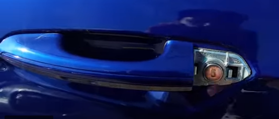

The Breeze Posted April 28, 2021 Author Report Share Posted April 28, 2021 Looking for some insight on the manual door lock... Opened it up yesterday and as expected, the linkage for the manual lock was not attached up at the cylinder. Anyone have eperience with this part and know how it attaches? The part of the cylinder that the linkage connects to is keyed. It's pretty clea what direction the plastic piece needs to go to fit over it, but what keeps it in place? It was an indent around the plastic which hints at some kind of a retaining clip which is MIA and explains why it probably fell off. The problem is, I've combed the net looking for an image, part number or something to help identify whats missing and what I need to order. I have found nothing except a million other door lock cylinder linkage clip retainers that "Doesn't fit your 2013 Ford Edge". Is it possible it does NOT use any kind of retainer and it's just a friction fit? Any thoughts (or pics!) will be very helpful as right now the door is in pieces and can't be easily driven. I'd prefer not to button it all up without finishing the job, just to rip it all apart again in a few days. Quote Link to comment Share on other sites More sharing options...
enigma-2 Posted April 28, 2021 Report Share Posted April 28, 2021 First if all, the clip fell off in a closed cavity and is probably still lying at the bottom of the door. If it's what ive seen before, it has a "u" section that snaps over the shaft and a double circle section that hooks to the latch bar. Anyway its probably laying in the bottom of the door. Now, if you can't find it you'll need buy a new part. Save yourself alot of time and headaches. Head down to your local Ford dealers parts department and let him look up the part. (Your probably going to have to anyway, not a common failure). Quote Link to comment Share on other sites More sharing options...

The Breeze Posted May 2, 2021 Author Report Share Posted May 2, 2021 Got the manual lock working today. No clips missing, no damage to the handle base. You can see in the first pic, when it's facing the wrong direction, it appears as if it should accept an oh-sh!t clip. But I guess a better mind than mine would have known better. The lock cylinder doesn't have any grooves or anything else to work with a clip. Turned the other way, those four "tabs" just press into the handle base. I inspected both pieces first to confirm there were no cracks so I could have some confidence it would stay on. I had to remove the cylinder from the base and the linkage from the black piece and then it snapped right into place and felt quite secure. Slid the tumbler back in, attached the rod at both ends and buttoned it all up. Works great. I'm still left with the "why" it came off. I have a hard time believing it could have been a door slam. I bought the Edge used and I wonder if the door was a replacement from an accident. If so, in an effort to keep the same key for the door and ignition, they probably swapped the lock cylinder and maybe were just too lazy to finish the job knowing the buyer would probably not test something like that before buying. Lesson learned... Actually, lesson was taught many years back when this stupid student bought a used Civic. A few years into ownership the battery died and had the same problem, but this time the lock was frozen from lack of use. I guess a common problem with that generation of Hondas. I had to have AAA come out and slim jim the door. You would think most people would test the door lock before buying used after a headache like that. Not this student. Maybe next time buying used I'll know better? Doubt it... 3 Quote Link to comment Share on other sites More sharing options...
enigma-2 Posted May 4, 2021 Report Share Posted May 4, 2021 (edited) Good writeup. Judging by looking at the pictures, it's a wonder that more lock lineages don't come off. Thanks for posting. As for why, my guess is someone replaced the handle. Last year I was at Walmart. When I got to my car, the entire outer handle came off in my hand when I pulled on it. Replacing it is easy enough, remove the screw in the end of the door and the handle pops off. May have popped off during a handle change and the mechanic (home or incompetent) either didn't notice or care. Just a guess. Edited May 4, 2021 by enigma-2 Quote Link to comment Share on other sites More sharing options...
