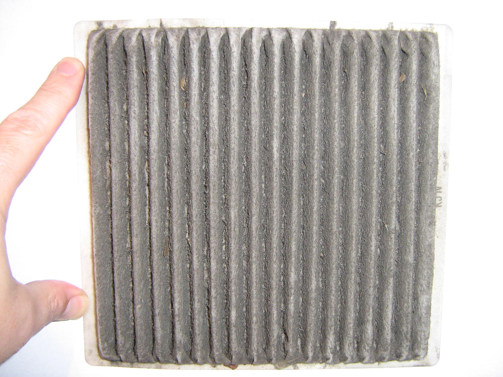

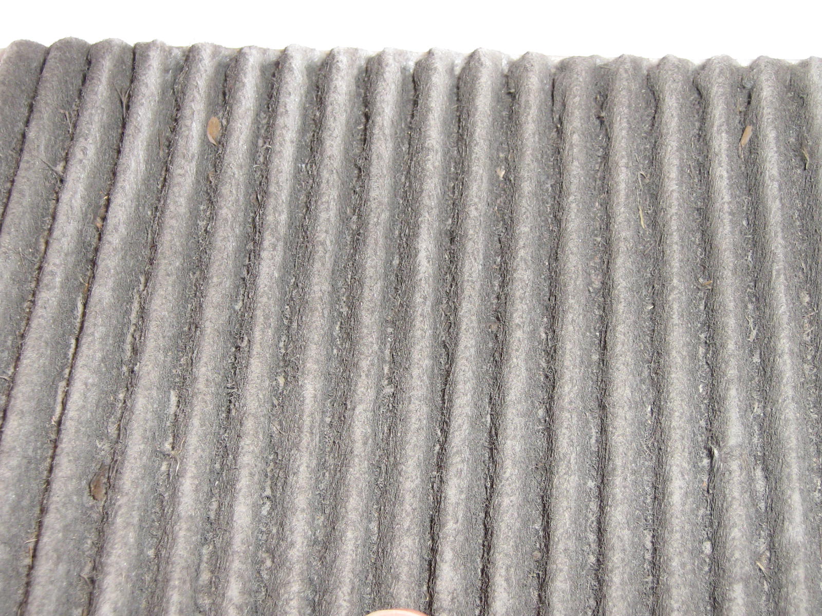

CorporateEdge Posted April 13, 2009 Report Share Posted April 13, 2009 Popped open the cabin air filter compartment on my 2008 SEL. Based on the postings it took me less than a minute. Attached are photos of the filter which I am sure is the factory original since I haven't had it serviced. Given a car almost 1.5 years old the filter isn't really that bad but I am going to go buy a new one today. Here are a couple of shots Quote Link to comment Share on other sites More sharing options...
Lex Talionis Posted April 13, 2009 Report Share Posted April 13, 2009 Given a car almost 1.5 years old the filter isn't really that bad damn.. looks darn right nasty to me Quote Link to comment Share on other sites More sharing options...
BlazedUp Posted April 13, 2009 Report Share Posted April 13, 2009 Damn, that is nasty, I thought mine was bad. Also, I believed these filters did nothing but seeing yours they clearly do. Can you believe my dealer charges $60 for 2 minutes worth of work and a $3 air filter. Quote Link to comment Share on other sites More sharing options...
