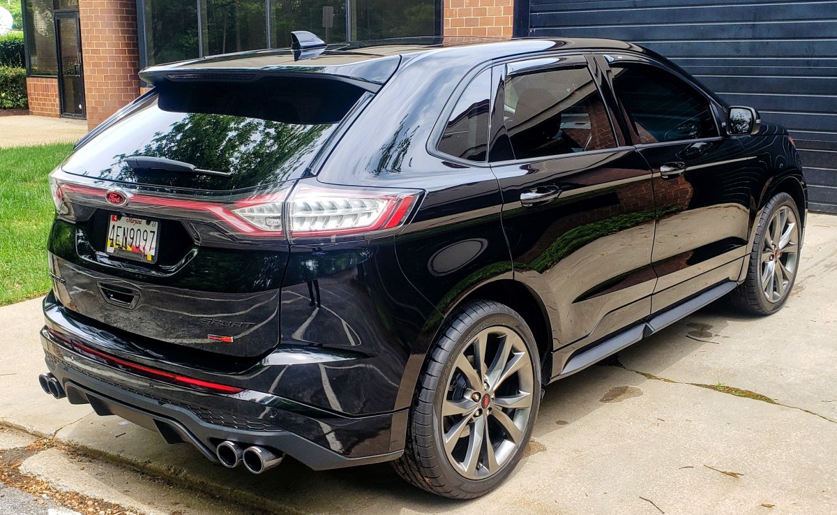

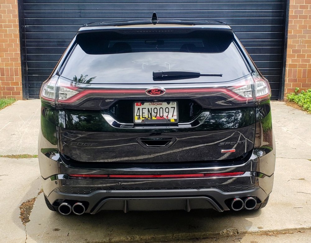

I am also new to the forum (joined yesterday), I bought a 2017 Edge Sport just over a month ago, 32k miles, also Shadow Black.  So far I have added the JLT catch can, KN drop-in, HikeIt throttle accelerator, and the Boomba Adjustable BOV adapter (just wanted to see if I liked the VTA sound before deciding which Turbosmart to get) and Atturo AZ 850s 265/40/21.  Some cosmetic stuff, 20% tint, tinted fog and mirror lights, window visors, hood skin, hyperdip blacked out badges, and black/red overlays on all ford emblems that I'm in the process of changing out now, black/red EcoBeast AWD overlay, Akrapovic carbon fiber dual exhaust tips (removed those stupid factory covers), glossy carbon fiber interior trim panel. My next purchase was going to be the power package from unleashed, or just the tuner/tunes from LMS. So I just had a few questions: How have you been liking the unleashed tune? Which tuner did you choose? Did the tune totally crush your gas mileage? Do u recommend it? My DD is about 6 miles city, 40 hghwy round trip, very little traffic. Thanks very much for any response
Your ride looks sweet! I love the quad exhaust tips!!! I didn’t know I needed that until I saw it on yours. So I went with the SCT tuner power package. I didn’t end up changing the thermostat but I did have the spark plugs swapped. I’m still waiting on my Green air filter as well. My drive is similar to yours and I’m getting around 22 mpg with a 93 octane tune. I put it in sport a lot though. If I set cruise on the highway I average high 20s. I highly recommend it, I’ve been telling all my buddy’s with eco boosts to look into it. Totally changes the feel. When I leave it in drive it’s still very well behaved but when I drop it into sport it feels as fast as my g37 was. I haven’t done any real tests, just flooring it up to highway speeds or goosing it on backroads but I’m very pleased with it.
How easy is it to remove the exhaust covers and slap those quad tips on?
That is amazing!  I can't believe that both of you are getting better gas mileage with the tune, that seals it for me and I'm ordering tonight! Exhaust covers are super easy, 4 bolts on each, 2 star and 2 tiny hex heads, I actually had to go buy one of those tiny ratchet sets bc mine didn't have a small enough size.  Kind of a pain to get to a couple of them, (I didn't use a jack or ramp) but you can have em both off in 20 minutes.  It leaves you with enough room for tips that are 7.5"-8" across.  I went with 89mm tips which were 7.5" total width.  I also had to cut about an inch off of the exhaust pipe to get it to the depth I wanted, but that will be dependent on the tips you purchase of course.  Thank you for the information, I really really appreciate it.
I apologize,  I should have noted that those are the sizes that you can fit if you want to retain the factory clips for possible later use (wanna be able to put em back on when I turn it in one day).  If you are willing to cut those clips, then you could go a bit wider.  As you can see, there is still a bit of room on both sides of the factory cuts..
