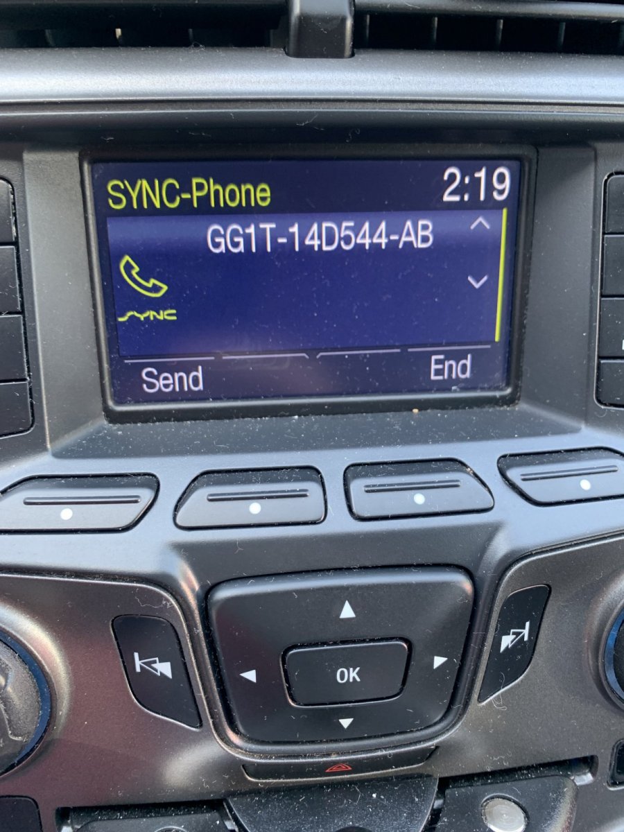

Cmac Posted April 23, 2022 Report Share Posted April 23, 2022 (edited) I know this thread is old but I feel that sharing this will help some people in the future. After trying to downgrade many times and failing I created a modified software version by comparing and combining the file that contains 4.4 with software 4.6. I assumed that the start files for the new software check some hash or input to keep you from downgrading, since they were the same name and size I just replaced them. It worked perfectly for me and now my Siri functionality works. The system still thinks the software is version 4.6 but is actually version 4.4 as I used the old data files from 4.4. Attached is an image of my displayed version number. Anyone who wants to try my modified software is welcome to, However I am not responsible for any issues that this may cause. Use at your own risk. The download link is here https://drive.google.com/drive/folders/1UccA1CQxjGzDCKPkAodkix3TTZFFbGXw?usp=sharing Edited April 23, 2022 by Cmac 2 Quote Link to comment Share on other sites More sharing options...
JD3450 Posted April 24, 2022 Author Report Share Posted April 24, 2022 Thanks. The download install worked and I have the same sw version as your photo but still not working like before, meaning I could ask Siri for the nearest Home Depot or text my wife and it went through the car speakers. I thought it worked via USB connection until I paired the iPhone for Bluetooth and then the Siri symbol just moves on the phone but it doesn't work. I tried deleting the pairing and try again but now I cannot even add the phone. Crazy sw! it was worth the shot. My voice activated phone calls with Siri still worked....until I deleted the pairing...lol. I'll try another day. Thanks for the effort. 1 Quote Link to comment Share on other sites More sharing options...
Cmac Posted April 24, 2022 Report Share Posted April 24, 2022 I am sorry It didn't work for you. I had absolutely no Siri functionality since buying the car in 2020 and now I can tell it to call/skip music and open apps while connected to the car through Bluetooth. I do think its odd that it still didn't work for you because the install file I created uses the old 4.4 software masked as 4.6. If you do decide to try it again, I would reboot/reset the system before the reinstall. Mabey it retained something in its memory? I spent a day messing around trying to install the older version and did those before deciding to edit the software files and giving it a try. Quote Link to comment Share on other sites More sharing options...
JD3450 Posted April 24, 2022 Author Report Share Posted April 24, 2022 Maybe I’ll try factory reset. I did a Sync Reboot. i spent weeks trying to install a 2016 Escape upgrade for my daughter… works. I don’t have much energy for mine now. I never should have messed with it but why would Ford even put broken software on their upgrade site! 2 Quote Link to comment Share on other sites More sharing options...
JD3450 Posted April 25, 2022 Author Report Share Posted April 25, 2022 (edited) I performed both resets and reinstalled your downgrade software. The redo fixed the issue I was having with pairing my phone. But in the end, I have the same issue in that Ford blocked the ability uses hands off to dictate a text or ask Siri for a list of stores, or restaurants, etc, near me. That was the old software allowed to be heard over the sound systems. I did notice I was able to send a text via voice by just watching the Siri circle gizmo appear and I guess it it was getting my dictation but just not responding verbally. But that disappeared too. From what I read for others in a new search, Ford screwed up the 4.6 software and doesn't care to address it by just having us reload the old software. They seem to blame it all on Apple. Very poor quality control and testing by Ford. In the end, I just don't care to use Sync as I need to turn bluetooth off so I can use the Iphone/Siri to do what I need when I need to do it. Just cannot do it handsfree so I just don't use it while driving. Does the hands free voice dictate texting work for you? Edited April 25, 2022 by JD3450 Quote Link to comment Share on other sites More sharing options...
Cmac Posted April 25, 2022 Report Share Posted April 25, 2022 (edited) I am glad the reinstall fixed that connection issue. If I had an older software version than 4.4 I could make a masked downgrade file for a version that could potentially work better. I might mess around some more to see if I can get Siri to talk through the speakers. I am not sure if it has to do with Siri as with apple earphones it mainly listens preforms the command and does not speak. Now that you mention it I didn't notice it not talking through the car, It would call but not send texts for me, probably part of the issue as it normally asks what you would like to send. I agree that ford intentionally removed this feature and then blamed it on apple. I am not sure why but the install files for 4.6 had some major changes in structure from what I can see. The older installations had 7 things to install while the new one only had 6. Along with different sized backend data files. Many things could be changed in the installation file for different results that I have not messed with and I'm not sure If I will because I'm unable to see the source code and would hate to brick my radio. Edited April 25, 2022 by Cmac Quote Link to comment Share on other sites More sharing options...
