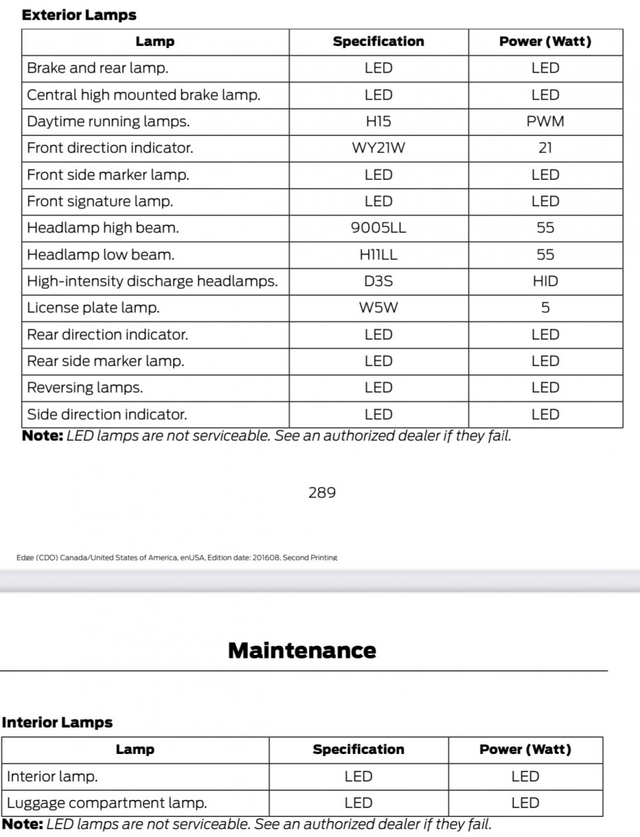

CameronDouglas Posted March 31, 2021 Report Share Posted March 31, 2021 Anyone have a chart for all the interior bulb sizes on the 2017 Edge Sport? The OM just says LED without specifying the size. And apart from the interior and license plate lights, what else is not an LED stock? Quote Link to comment Share on other sites More sharing options...
enigma-2 Posted March 31, 2021 Report Share Posted March 31, 2021 LEDs are not bulbs. They are chips soldered onto a circuit board or attached to a plastic backer (they're an integral part of an assembly and not replacable). The actual number of the LEDs used in these assembles are not known (other than to Ford and the supplier who's manufacturing them for Ford. Being a nonserviceable part, Ford doesn't release that information). Even if uou disassembled the lamp, you still wouldn't be able to identify the LED. All of the incandescent and high intensity discharge bulbs used are listed in the chart you posted. All other fixtures are non-replaceable LEDs. Quote Link to comment Share on other sites More sharing options...
