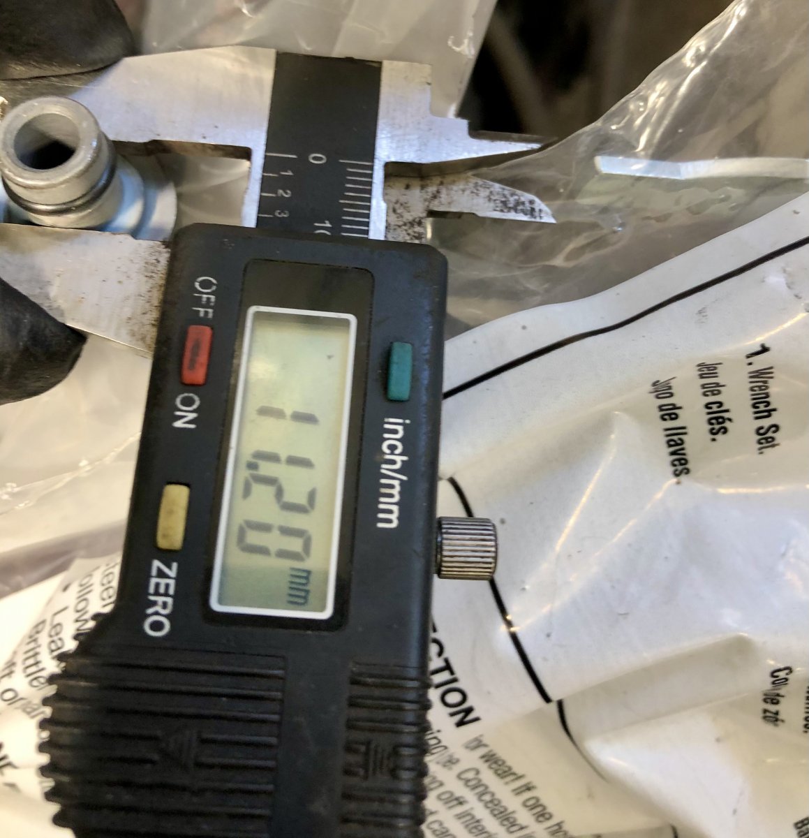

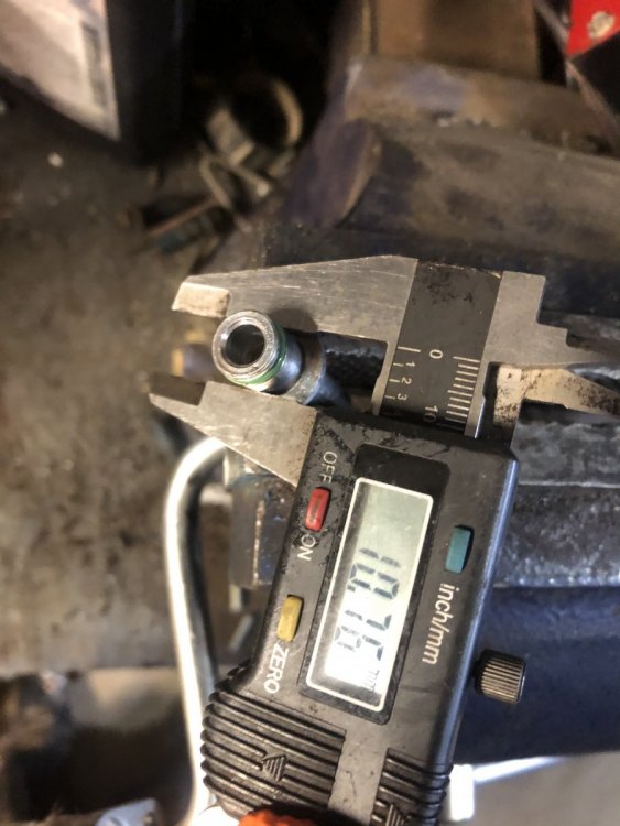

Alex E Posted April 18, 2021 Author Report Share Posted April 18, 2021 UPDATE - So it was an air leak caused by the aftermarket Edelman Power steering line. The connection that inserts into the pump measured too small compared to the OEM line. Tried it with 2 Edelman lines, both calipered too small. Go OEM with this part. What a pain this was! 1 2 Quote Link to comment Share on other sites More sharing options...
