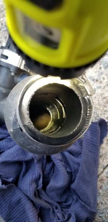

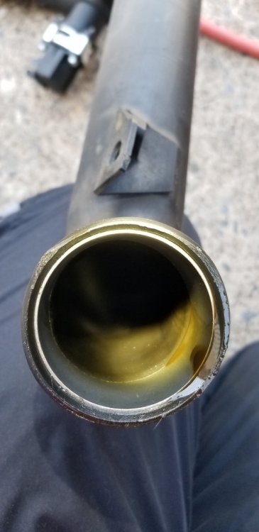

DrivingofftheEdge Posted March 20, 2021 Report Share Posted March 20, 2021 (edited) I'm changing fluids today and of course you want to move everything you can for easy access. I take the intake tube off that goes from the compressor side back of the engine across the bottom and to the intercooler. I look at the tube on the rear engine side, not that much oil. I put my finger into the intercooler side and holy shit. My fingers are covered and the oil is extremely dirty. Edited March 20, 2021 by DrivingofftheEdge Quote Link to comment Share on other sites More sharing options...
lildisco Posted March 21, 2021 Report Share Posted March 21, 2021 Time for a catch can & possible valve cleaning! Get some throttle body cleaner & go to town on the intake tube. Quote Link to comment Share on other sites More sharing options...

lildisco Posted March 21, 2021 Report Share Posted March 21, 2021 Do you remember how clean the intake was? Maybe it was residual stuff from prior to the catch can install? Quote Link to comment Share on other sites More sharing options...
DrivingofftheEdge Posted March 22, 2021 Author Report Share Posted March 22, 2021 That is very possible. I really didnt look too much inside the intake and this is the first time taking that inlet off. The valves looked pretty clean still when I first installed the catch can and removed the intake. The only thing I do notice is the smell of hot oil while I'm driving, which is odd. Quote Link to comment Share on other sites More sharing options...
