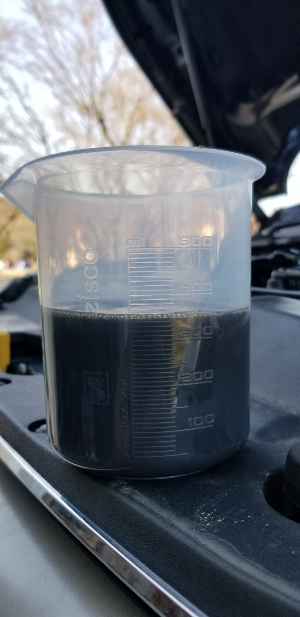

DrivingofftheEdge Posted March 20, 2021 Author Report Share Posted March 20, 2021 Drained PTU got about 350 MLS, which doesn't seem like that much. A quart has 946 MLS in it. Fluid was dark and stinky but shavings were at a minimum. Used a magnet in the cup and only found very very small metal shavings. Quote Link to comment Share on other sites More sharing options...
1004ron Posted March 20, 2021 Report Share Posted March 20, 2021 Probably caught it in time. What's the mileage ? Quote Link to comment Share on other sites More sharing options...
DrivingofftheEdge Posted March 21, 2021 Author Report Share Posted March 21, 2021 Just a hair under 50k Quote Link to comment Share on other sites More sharing options...

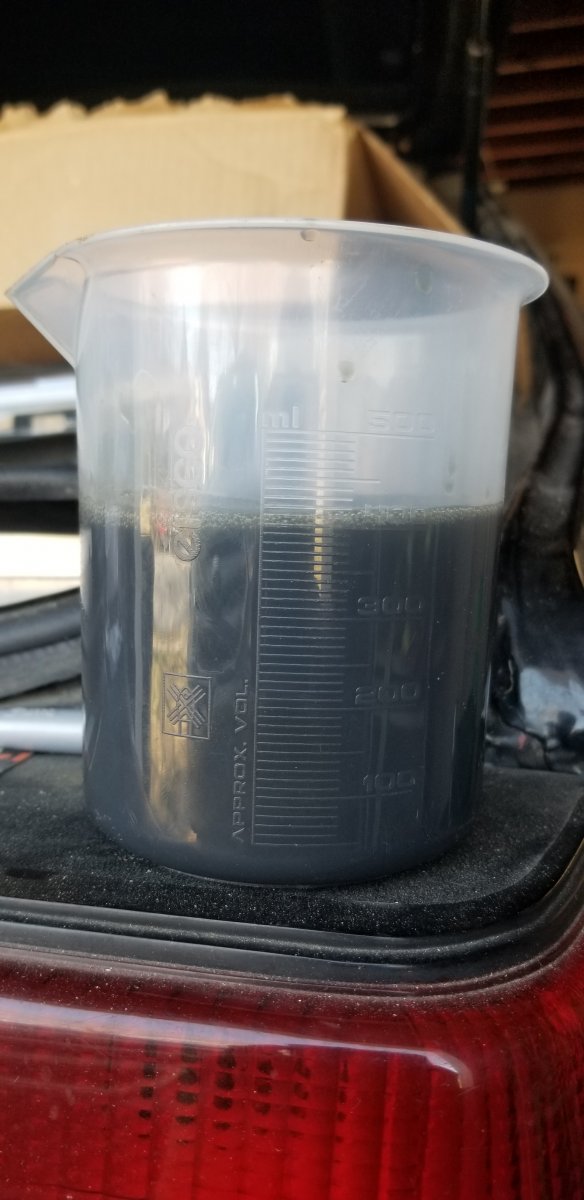

DrivingofftheEdge Posted March 21, 2021 Author Report Share Posted March 21, 2021 Changed the fluid in the rear, well sucked it all out. Got almost 400mls. The rear has more than the PTU? That's weird. Quote Link to comment Share on other sites More sharing options...
