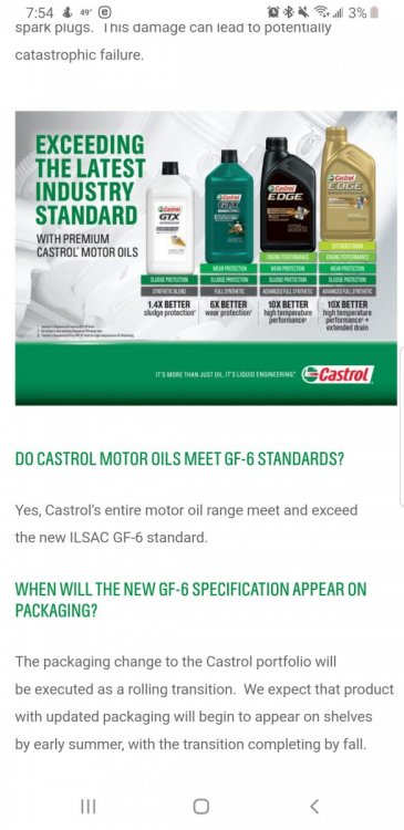

DrivingofftheEdge Posted March 4, 2021 Author Report Share Posted March 4, 2021 I'm pretty sure almost every oil is now ILSAC GF-6 compliant even non synthetic Quote Link to comment Share on other sites More sharing options...
DrivingofftheEdge Posted March 4, 2021 Author Report Share Posted March 4, 2021 Quote Link to comment Share on other sites More sharing options...
