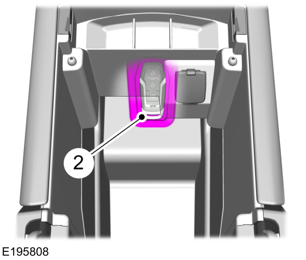

omar302 Posted February 1, 2021 Report Share Posted February 1, 2021 On 2/1/2021 at 12:46 PM, 1004ron said: Edit: Dealership called to say he's cut a valet key for me using the code I provided and he's reasonably confident that will get me into the vehicle - free of charge. Expand That's good to hear. Try again to get the code using the 2 key method stated in the owners manual, I just tried it on my 2016 and it worked. (comments in red are mine). Quote Displaying the Factory-Set Code Note: You need to have two programmed intelligent access keys for this procedure. Open the floor console storage compartment lid. With the buttons facing the rear of your vehicle (up) and the key ring up (facing the rear of your vehicle), place the first intelligent access key into the backup slot inside the center console. Press the START/STOP button once and wait a few seconds. (I counted 5 seconds) Press the START/STOP button again and remove the key. Insert the second programmed key into the backup slot, then press the START/STOP button. The factory-set code appears in the information display for a few seconds. Note: The code may not display until after any other warning messages first display. (it displayed after a few seconds) Expand 1 Quote Link to comment Share on other sites More sharing options...
1004ron Posted February 2, 2021 Author Report Share Posted February 2, 2021 The dealership is closer to my work than home, so stopped by on my way home this evening and picked up my free Valet key. It worked perfectly. Now have my factory keyless entry code saved - the code on the card inside my owner's manual pouch is ***0* and the number displayed on the dashboard is ***9*, which of course is one and the same thing with the door keypad. For the method for displaying the code on the dashboard - I pulled the valet keys out of each FOB and placed them in the holder with the buttons facing up and the end where the valet key goes facing forward - tried other orientations and this was the only way that worked in my Sport. 1 Quote Link to comment Share on other sites More sharing options...

BamaInArk Posted September 25, 2024 Report Share Posted September 25, 2024 Thanks I just came back to report I figured it out using the both Keyfobs trick to display the code for me. 2 Quote Link to comment Share on other sites More sharing options...
