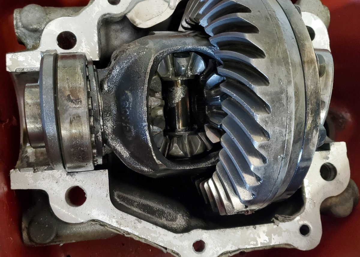

honerboys Posted September 11 Report Share Posted September 11 that pull & pay parts yard contacted me that a 2014 edge had just arrived in their yard - went out there and pulled the differential out - took 2 hours - jspec i took your advice and removed the entire pass side knuckle - hard to do in a yard - they don't allow you to bring in a jack so you're unbolting things under spring pressure - but it is in my garage now it's an exact replacement for mine - most of the oil dumped at the yard but i set it on end in my drain pan and got out 6-7 ounces of oil - i don't see any metal in it so maybe i got lucky my plan is to get new seals and flush it out - i have some 75w-90 gear oil here to flush - or should i use something like kerosene to flush it? - the seals cost almost as much as this unit - pull & pay charges a flat price for parts no matter what kind of car they come from - so a differential for a ford is the same as one from a porsche - it was $128 out the door - hopefully get this in, in the next 30 days (that's the extent of their warranty) i am also planning on drilling a drain into it - anybody have a quick link to instructions for that? - that way i can make changing it's oil an every 10K mile or so job - thanks for all the advice - will check back when it's in - also going to open my bad one up and see what's what in there 1 Quote Link to comment Share on other sites More sharing options...
Cerberus Posted September 12 Report Share Posted September 12 Nice find. I wouldn't do a kerosene flush, especially with the condition of the RDU and it's fluid being apparently very good. I also would not drill it to create a drain, nor change the fluid every 10k.. but that's just me. Quote Link to comment Share on other sites More sharing options...
honerboys Posted September 12 Report Share Posted September 12 reason not to drill drain? - i'm seeing online that these need an occasional oil change - the one i just got is 10 years old with it's original oil (i assume) - just curious Quote Link to comment Share on other sites More sharing options...
Cerberus Posted September 12 Report Share Posted September 12 41 minutes ago, honerboys said: reason not to drill drain? - i'm seeing online that these need an occasional oil change - the one i just got is 10 years old with it's original oil (i assume) - just curious Changing fluid is good. Compromising the structural integrity of a load bearing member is unnecessary to perform the fluid change, it just makes it easier. Also, if in fact the unit has the original fluid and is in as good a condition as you say, that would suggest that regular fluid changes are less necessary than you might think. Mine ran empty for many miles and did not fail completely.. yet. 1 Quote Link to comment Share on other sites More sharing options...
