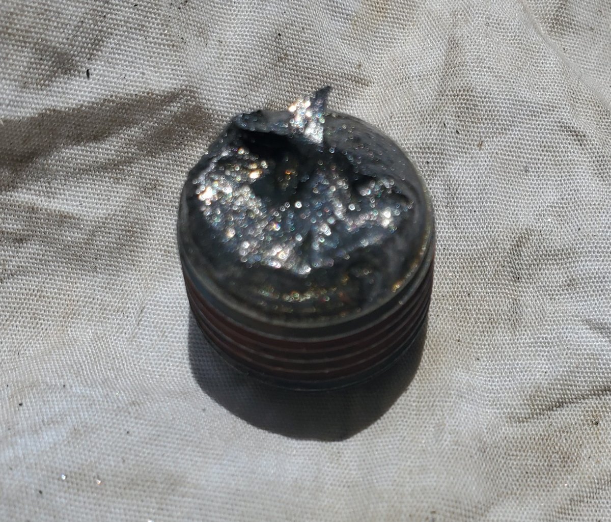

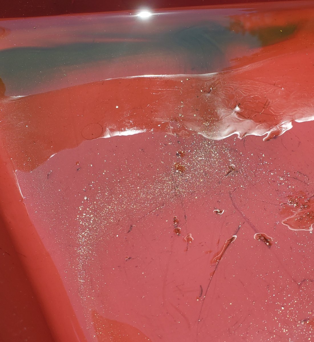

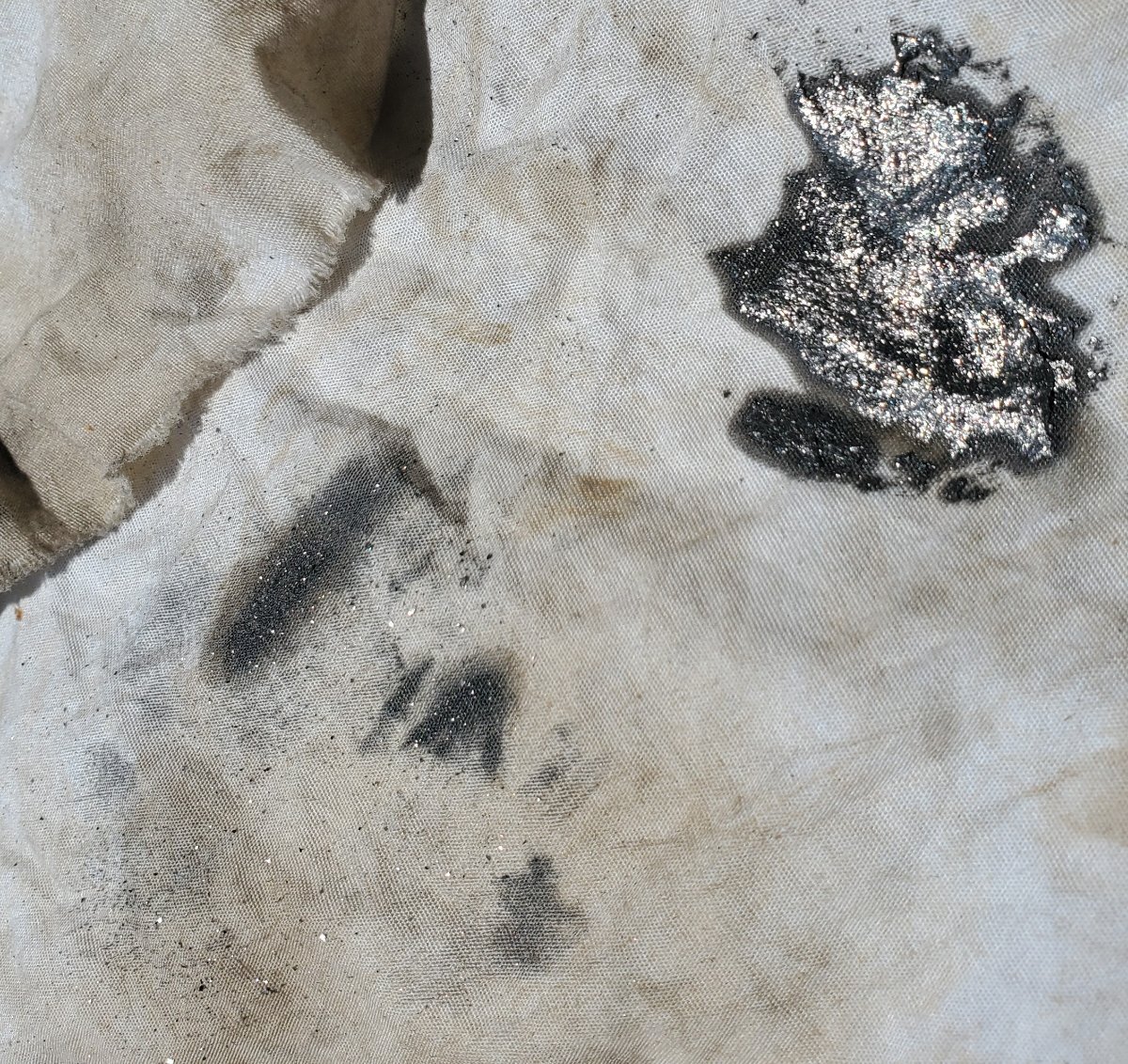

honerboys Posted August 3, 2024 Report Share Posted August 3, 2024 sorry it took so long to get back here - this is my wife's car and i needed a day when she wouldn't need it - i siphoned out about a pint of oil - i guess i would need a thinner siphon hose to get to the bottom of the case - i had cleaned the fill plug magnet about 3 weeks ago - you can see that in that time it has completely filled up again with metal - also, a picture of a little bit of the oil in the drain pan - lots of specks in there (and that was just the drips as i actually drained the differential into an old oil bottle) - and finally a pic of the magnet sludge smeared out on a rag - no big pieces of metal but those could be down in the bottom of the case - so it seems i've found the culprit for the growling noise - going to get a rebuilt one and see how that goes - anyone recommend any sellers of those - some come from china - are those actual ford diffs that have been rebuilt or from some other manufacturer? Quote Link to comment Share on other sites More sharing options...

Cerberus Posted August 16, 2024 Report Share Posted August 16, 2024 (edited) I have not replaced mine yet, but I got the one I have for the job off of ebay, it is a used unit harvested from a wreck or something, sticker numbers all match the unit in my ride. It took a while to find it on ebay, but it was cheap. Like less than 200. And when I pulled the fill plug, it had only the slightest film of magnetic dust sludge on it, so I'm optimistic about it's condition. Just waiting for the weather to cool off a bit before I do the job. Edited August 16, 2024 by Cerberus Quote Link to comment Share on other sites More sharing options...
