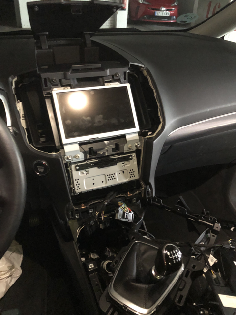

Antrox Posted August 23, 2023 Report Share Posted August 23, 2023 (edited) Hello all. My Sync2 screen has the brackets on the top and the bottom. Is @Okie 3d printed solution valid? Because I think they are attached to the sides instead. As you can see bellow this os my Sync2 configuration. Edited August 23, 2023 by Antrox Added a photo Quote Link to comment Share on other sites More sharing options...
