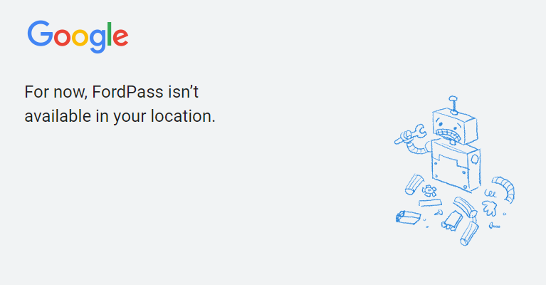

b00STie Posted January 18, 2021 Author Report Share Posted January 18, 2021 I got it working by connecting my Google assistant with the ford pass app. Here is the link to connect the Google assistant with your fordpass account. All you do is sign in and it connects everything. https://assistant.google.com/services/a/uid/000000ac1d2afd15?hl%3Den-US&hl=en-US&jsmode=o&source=web&source=web 1 Quote Link to comment Share on other sites More sharing options...
bigleyy Posted January 19, 2021 Report Share Posted January 19, 2021 Alas does not appear to be available in Canada Quote Link to comment Share on other sites More sharing options...
