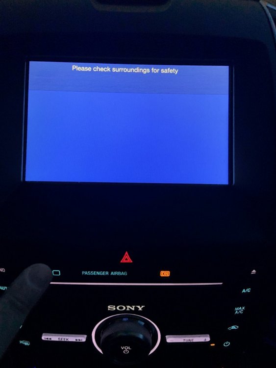

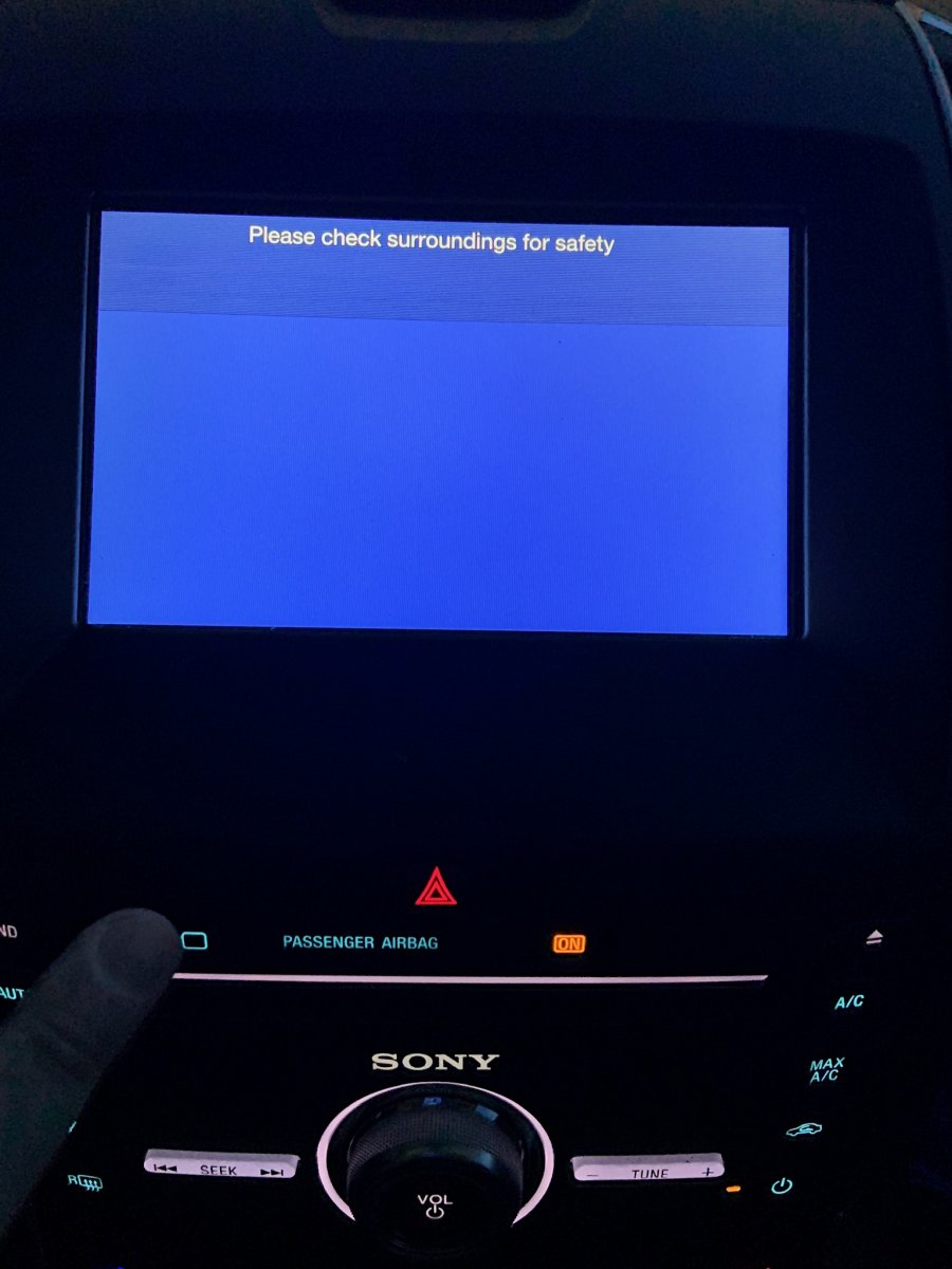

v8vega Posted January 10, 2021 Report Share Posted January 10, 2021 Last week my front camera stopped working on split view, but worked fine on the wide angle. Today the screen is black momentarily and then turns blue. Anyone come across this before and any ideas on what I could do to check/fix this? Quote Link to comment Share on other sites More sharing options...

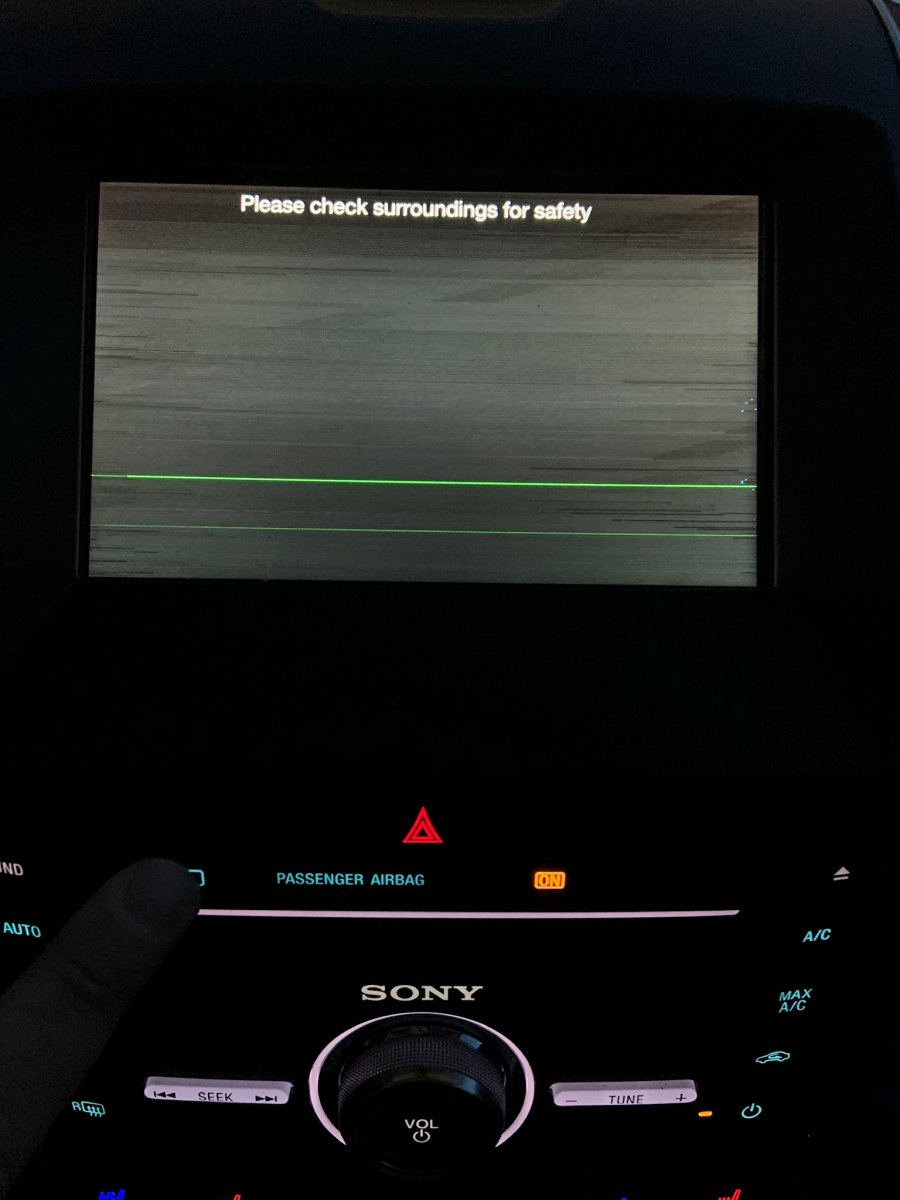

v8vega Posted January 12, 2021 Author Report Share Posted January 12, 2021 Update: Over the weekend the front camera wasn't working at all as shown. Monday morning on the way to the Ford dealer the camera began to work only in 180 view, but not in split view. Dealer called me today and said the camera is no good and will be replaced. Quote Link to comment Share on other sites More sharing options...
v8vega Posted January 14, 2021 Author Report Share Posted January 14, 2021 Got the car back from the dealer after they replaced the front camera. The split view still doesn’t work and when I got home the camera stopped working again. I now get a message that says “camera is unavailable”. The next morning it worked again on wide view, but not on split view. Anyone have any ideas? The dealer is working with Ford to find out whats going on. They don’t understand why split view isn’t working. I wonder if there’s a connection issue somewhere? Quote Link to comment Share on other sites More sharing options...
