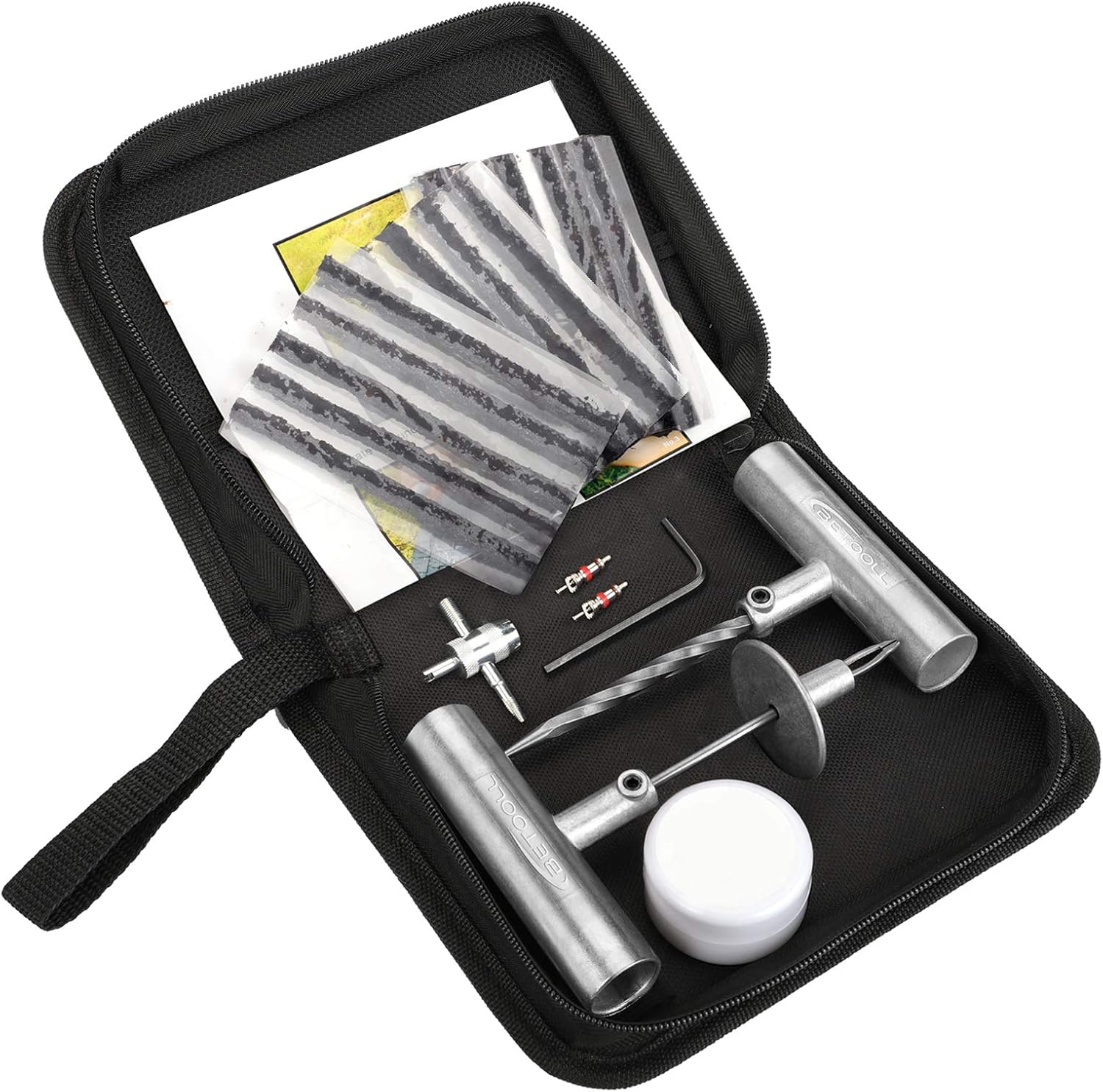

1004ron Posted January 1, 2021 Report Share Posted January 1, 2021 Yes, I don't like the idea of using the 18" emergency spare, and taking another look at it this evening I decided that I'm going to keep one of those Puncture Plug kits, and a small 12v compressor that I already have, in the ample space in the area where the existing spare is kept. https://www.amazon.com/dp/B07MR5FX8M/?coliid=I28AFU02Y7FK60&colid=7FQZRUTL8DOG&psc=1&ref_=lv_ov_lig_dp_it Quote Link to comment Share on other sites More sharing options...

txaggie Posted January 1, 2021 Report Share Posted January 1, 2021 1 hour ago, 1004ron said: Yes, I don't like the idea of using the 18" emergency spare, and taking another look at it this evening I decided that I'm going to keep one of those Puncture Plug kits, and a small 12v compressor that I already have, in the ample space in the area where the existing spare is kept. https://www.amazon.com/dp/B07MR5FX8M/?coliid=I28AFU02Y7FK60&colid=7FQZRUTL8DOG&psc=1&ref_=lv_ov_lig_dp_it I have had one of those in my Edge since I brought it home. Quote Link to comment Share on other sites More sharing options...
