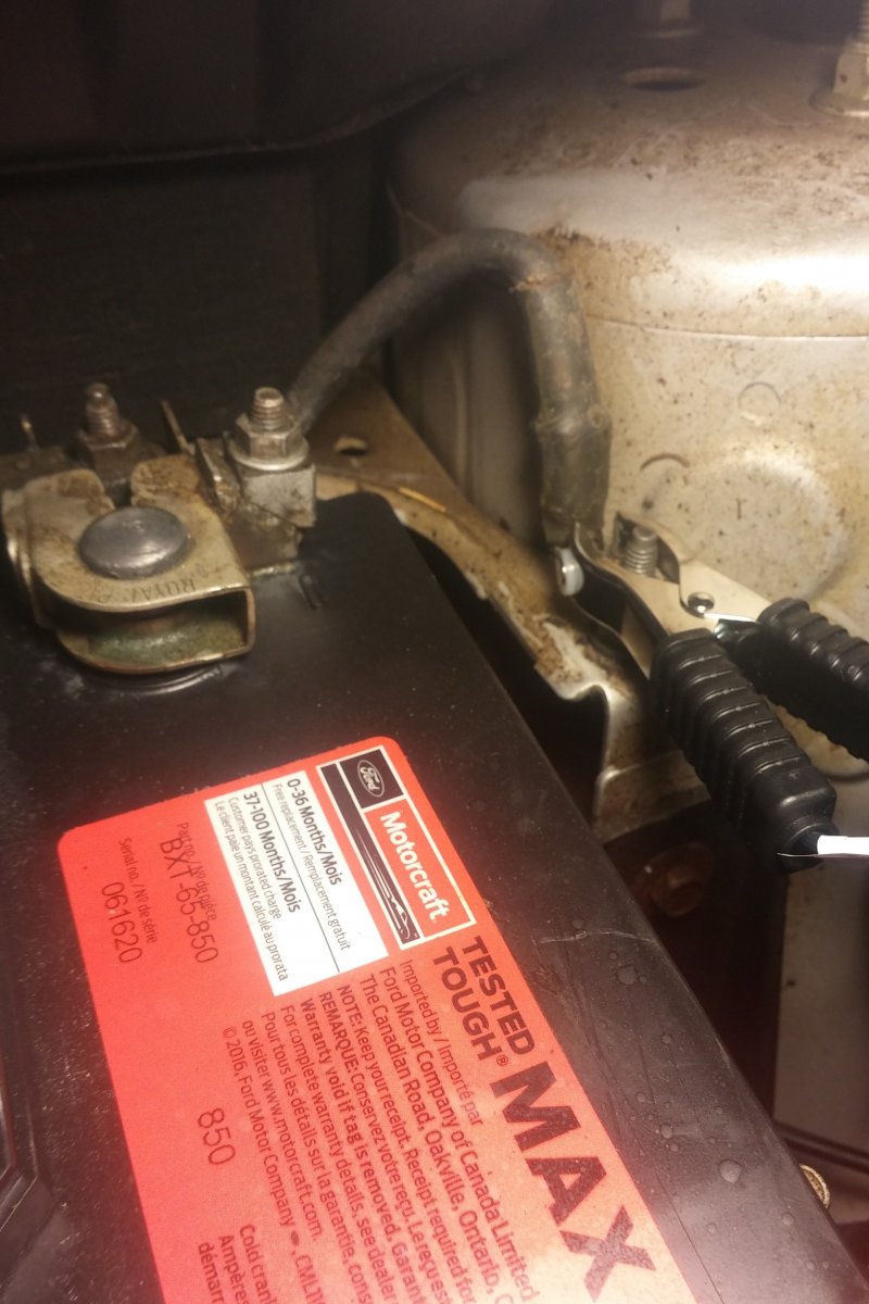

Edgingage Posted January 9, 2021 Author Report Share Posted January 9, 2021 (edited) No, the dealer didn't reset the BMS, nothing; upon request this time they sat the cable connections all the way down the posts and sprayed some lube on top; I still see the greenish corrosion deposits on the connections... Good enough I guess. On 12/30/2020 at 7:52 PM, WWWPerfA_ZN0W said: Yeah, good point. I have never measured the amp draw in this condition, tho it may be reduced if you can lock the doors with the ignition on. Znow, if you're not sure, with all respect I'll then take your advise on the side of caution... I wouldn't want to use my vehicle as a guinea pig lol. Do I REALLY need TO HAVE the ignition on?.. Also, when you say "make sure to leave the ignition on (engine off) for the duration", do you mean: - not accessory on, but ignition on (with all those dash lights and chimes on?) - for the duration: I usually leave the charger overnight, is it OK to leave the ignition on overnight for the reset purpose? I've heard/read that having the keyfob out of reach for more than 8 hours will reset the BMS. I do this quite often, like 3-4 times a week at least, as I parked more than 100m away from my movement area at work. Edit: Oh, a good chunk of text was cut off when I pressed submit...; I'll type it again below: A while ago in another thread Bac2010 determined that my battery has 62.5 Ah capacity. The smart charger's manufacturer recommends that "a good, safe rule of thumb is about 1/10th its Ah capacity". Based on both info, I bought a smart charger that charges 7A @ 14.4V (it has a choice to charge 1A at the same voltage), can provide constant power supply at 13.0V, and can recondition at 15.8V. Just in case this info may help you determine if it can do what you suggested once we figure out how much current is drawn with the ignition on. Now, meanwhile, for me to get ready I need to ask a kind of dummy question: I usually hook the smart charger negative clamp to the bolt attached to the strut mount, behind the fuse box, please see attached picture. Please let me know if that location is suitable to be used as negative/ground connection for the mentioned purpose. Thanks in advance folks. Edited January 10, 2021 by Edgingage Quote Link to comment Share on other sites More sharing options...
WWWPerfA_ZN0W Posted January 10, 2021 Report Share Posted January 10, 2021 if you wait the 8+ hours, then technically, no, you do not need to have ignition in ON mode. yes, ON would the be the last step before starting the vehicle. I believe if you do not push the brake pedal, the ignition will only go to ON mode, not START/RUN. I believe the point you use is a grounding point. if it is bare metal to bare metal and your charger works, you are good. yes your charger has sufficient capability to charge this battery. is it a CTek charger? Quote Link to comment Share on other sites More sharing options...

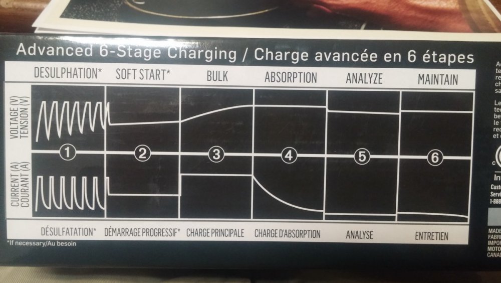

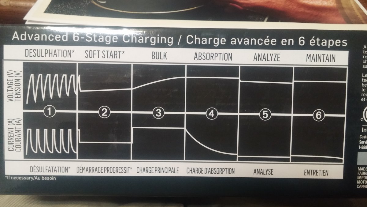

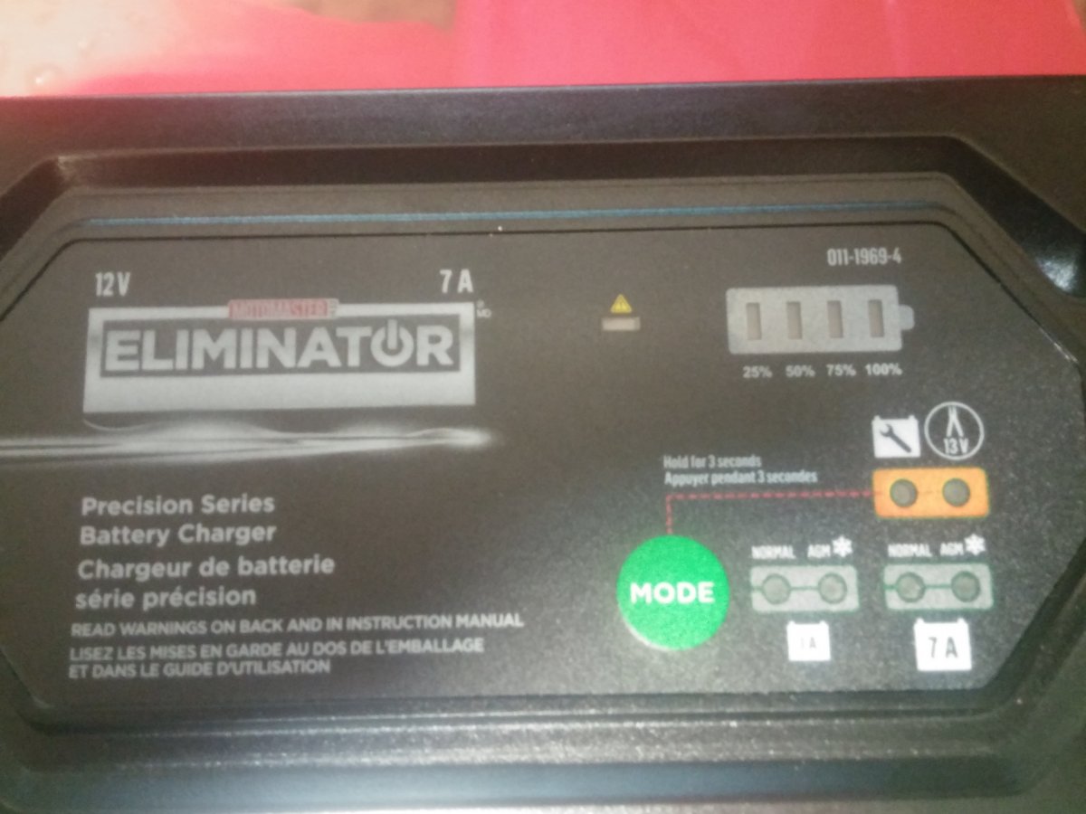

Edgingage Posted January 10, 2021 Author Report Share Posted January 10, 2021 (edited) Hello Znow and all Thanks for all your answers! I have the Canadian version CTek It has all the same smart features, except it's way cheaper than a CTek here (CAD $68.99). Same thing with the BA7: I have the Canadian version: it has all the exact same functions with the exact same software and hardware configuration except its casing looks different, and a little cheaper (CAD $62.99). Charger pictures attached. And I have one (hopefully last) dummy question about work with batteries: I've always read that we cannot disconnect/remove/replace the battery without a tender to keep the current/power to avoid/prevent computers/system from resetting and then having to get everything reconfigured again. Questions: - Is this true? - What memory settings exactly do we risk losing and having to reconfigure again if we don't use a tender to remove/replace/disconnect the battery? Radio "pre-sets"? - If we risk losing some memory pre-sets (other than radio), then we need to use a charger/tender to keep the current going in the car. Then, I would like to know what the order of steps is to connect and disconnect things (charger/tender, battery terminals/cables, other accessories?). For example, connecting the charger before disconnecting the battery: does it not double up the current (12V battery + 13V charger) in the car now that both (battery + charger) are still connected together before the battery cable (positive or negative?) gets disconnected? I have lots of doubts myself about the proper steps and order to connect/disconnect/reconnect charger and battery in the car. Sorry for my ignorance... The reason for my question is because, as you can see, I think I bought the tools I need to change the battery myself. However, yes, my battery was just changed by the dealer (for the above reasons I was chicken to do it myself) but I still plan to add some accessories and eventually I'll have to disconnect and reconnect the battery again. I just would like to make sure about the proper steps. And yes, I've seen quite a few YT videos, but some people disconnect the positive first, other ones disconnect the negative first, some people reconnect the negative first, other ones reconnect the positive first, ...and I don't know who is right or wrong, or maybe the disconnect/reconnect order doesn't matter? That's why I would like to ask in here instead of following who knows who's YT video is correct... Hope you folks wouldn't mind my questions. Thanks again for all your advice. It's ALWAYS greatly appreciated. Edited January 10, 2021 by Edgingage Quote Link to comment Share on other sites More sharing options...
