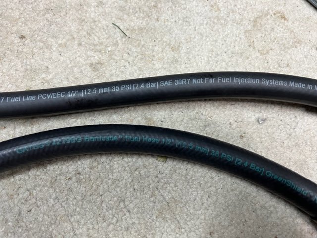

txaggie Posted February 16, 2022 Report Share Posted February 16, 2022 (edited) Got the new hoses in yesterday and installed them. So far so good, they are quite different, thicker, not as flexible. Hopefully they fix the problem once and for all,I have attached a photo showing the new hose type (green writing) - Edited February 16, 2022 by txaggie 1 Quote Link to comment Share on other sites More sharing options...
my2k2zx2 Posted February 17, 2022 Report Share Posted February 17, 2022 I have an Edge with the 2.0 but went through this issue with my JLT install back in November. They sent me the hoses that the gas fumes easily go through, after 100 miles the cabin air is thick with oil/fuel vapors. I contacted them and they said they would send replacement hoses, but while waiting for them to arrive I went to town and bought some Gates Barricade hoses. The temps were going to drop too far to work on the vehicle when the replacement hoses would arrive. That was done in December and so far we have not had the fume issue come back. 1 Quote Link to comment Share on other sites More sharing options...
WWWPerfA_ZN0W Posted February 17, 2022 Report Share Posted February 17, 2022 IMHO it is a rookie mistake to send non fuel resistant hoses with catch cans. more so with direct injection vehicles. 3 Quote Link to comment Share on other sites More sharing options...
SC_ST Posted February 20, 2022 Report Share Posted February 20, 2022 On 2/17/2022 at 5:43 PM, WWWPerfA_ZN0W said: IMHO it is a rookie mistake to send non fuel resistant hoses with catch cans. more so with direct injection vehicles. Was thinking the same thing. Here is info on Gates Barricade Fuel Hose https://www.gates.com/us/en/fluid-power/engine-hose/fuel-line-hose.p.4219-000000-000000.v.4219-05652.html Quote Link to comment Share on other sites More sharing options...
txaggie Posted February 20, 2022 Report Share Posted February 20, 2022 21 hours ago, SC_ST said: Was thinking the same thing. Here is info on Gates Barricade Fuel Hose https://www.gates.com/us/en/fluid-power/engine-hose/fuel-line-hose.p.4219-000000-000000.v.4219-05652.html Looks like that is the hose they sent me this time, so hopefully this solves it once and for all. So far so good! 1 Quote Link to comment Share on other sites More sharing options...
