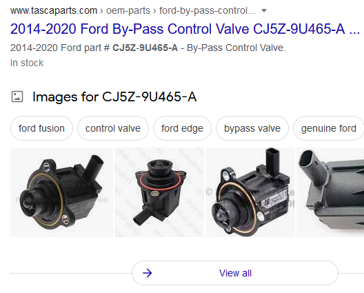

I would start by checking the blowoff valves and cracked turbo piping, esp right next to the clamps.  sometimes a hose will pop off the boost control solenoid as well, if they are left unclamped.
The orange seal I am referring to on the blowoff valves *3.5EB

I'm not a member of that forum and cannot see the photos. Are you referring to this?

Boost leak/vacuum leak test is paramount. It also may be a leaking BPV because apparently this platform struggles with that when you turn up the wic.  Honestly an easy way is you could spray the intake track, then intercooler piping, then vacuum lines in order and one at a time with soapy water and watch for bubbling. Have someone rev it too while you watch.
