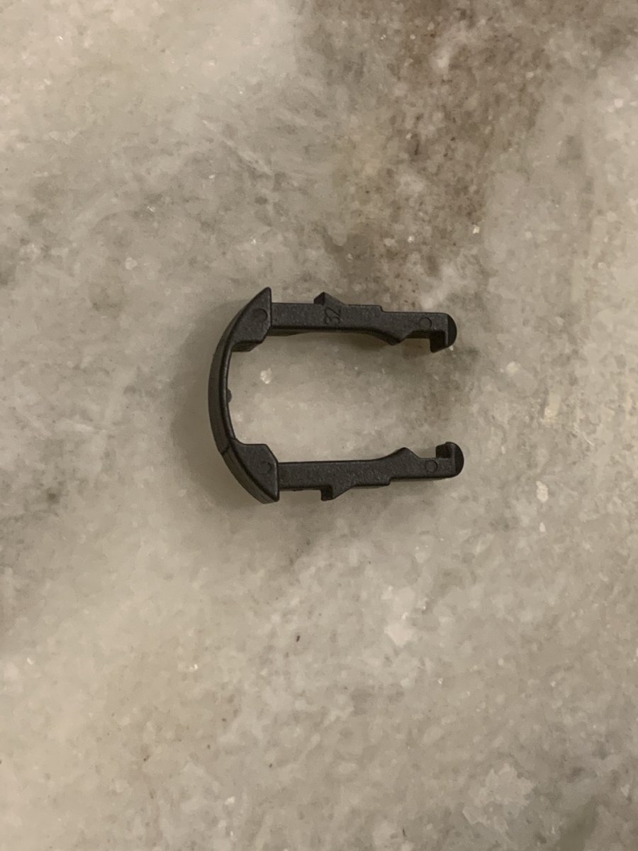

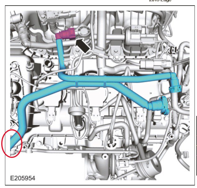

1004ron Posted November 22, 2020 Report Share Posted November 22, 2020 When doing a spark plug replacement I broke the release clip on one of the small air Quick Release Couplings and cant find where to buy a replacement. The connector in question is on the air pipe circled in red in the attached image. Quote Link to comment Share on other sites More sharing options...

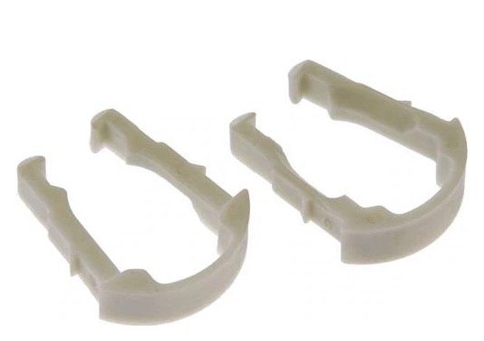

1004ron Posted November 23, 2020 Author Report Share Posted November 23, 2020 Found them - Dorman Part # 800-040 They're white, but are a perfect fit. Dorman - OE Solutions 1/2in Universal Fuel Line Retainer 2 Piece https://www.oreillyauto.com/detail/b/dorman-oe-solutions-3387/hardware---fasteners-16585/retaining-clips---connectors-25214/hold-down-clips-clamps-19033/115bcf9d8125/dorman-oe-solutions-universal-fuel-line-retainers/800040/4257314 Its unlikely you'll break this clip - because access is awkward to squeeze/press the retainer inwards, I pulled it out and that's when it broke. While I was at it I found using a long nose pliers to squeeze/press the back of the retainer worked best. qd_catalog_dor231625581 - Updated.pdf 2 Quote Link to comment Share on other sites More sharing options...
