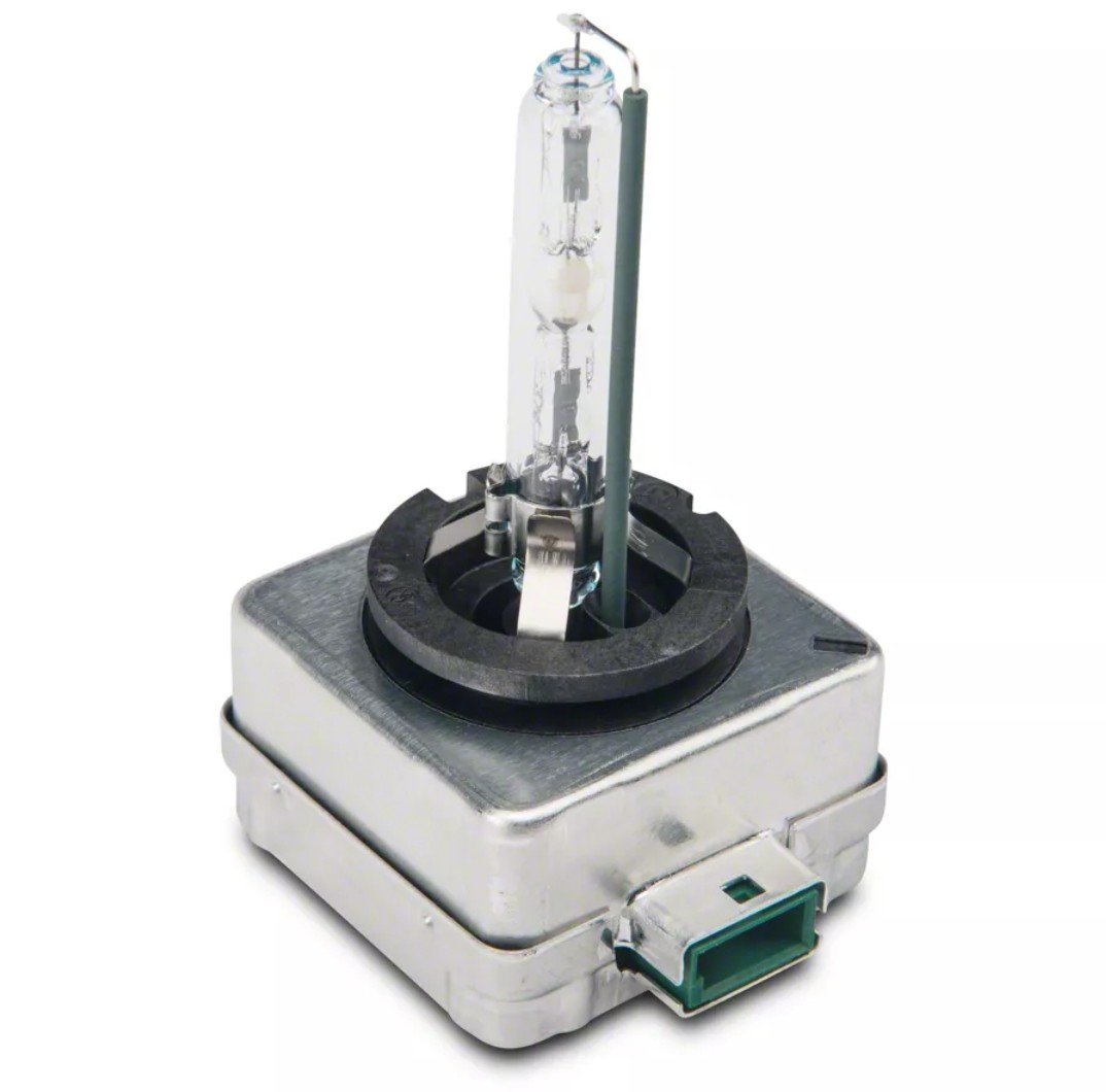

omar302 Posted November 6, 2020 Report Share Posted November 6, 2020 HID bulb turning yellow is probably a sign of failing bulb. By the way, this is what a stock HID bulb for the Edge looks like (D3S): Quote Link to comment Share on other sites More sharing options...
Calgary Dave Posted November 6, 2020 Author Report Share Posted November 6, 2020 Hi Omar 302. That is what it looks like. I managed to get the bulb out, with a bit of a struggle. I am of the opinion that if the bulb fails, it fails and does not do it gradually. I sort of think it could be the ballast or corrosion on one of the wires although I did not see any. I would like to know if anyone else has had this problem. I have been trying to avoid the dealership as they want $160/hour just to look. Dave Quote Link to comment Share on other sites More sharing options...
