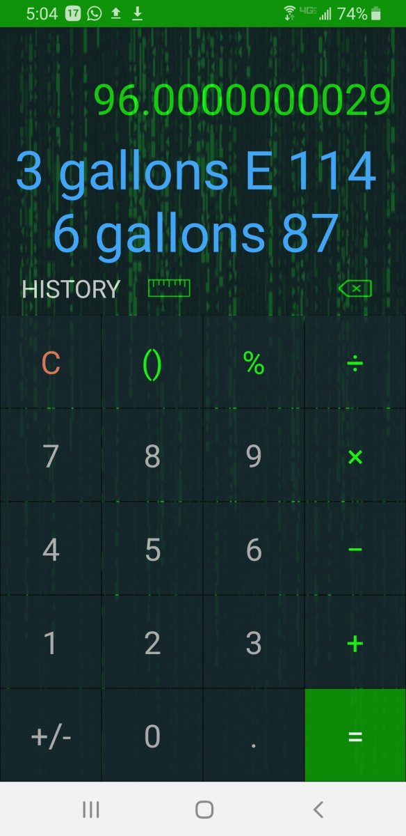

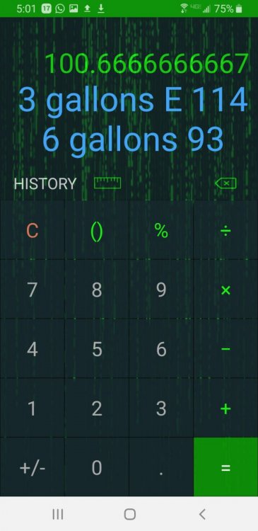

Edge5280 Posted April 17, 2021 Report Share Posted April 17, 2021 (edited) Gasoline isn't simple. The cam2 I add- Isooctane 26635-64-3 30-70 Toluene 108-88-3 10-25 Naphtha (petroleum), light alkylate 64741-66-8 5-20 Isopentane 78-78-4 5-15 Ethyl Alcohol 64-17-5 7-10 Butane 106-97-8 0-5 Benzene 71-43-2 0.002-0.01 There is also a difference between octane and knock resistance. Ethanol is a boosted dream. E30 blend Octane difference between 87 and 93 Edited April 17, 2021 by Edge5280 Just bc Quote Link to comment Share on other sites More sharing options...
