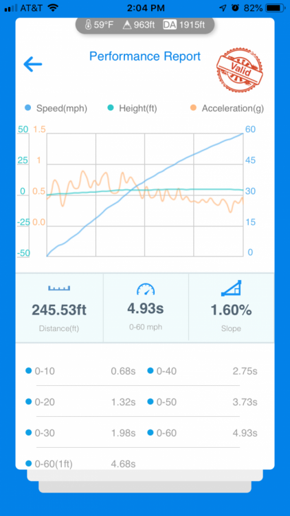

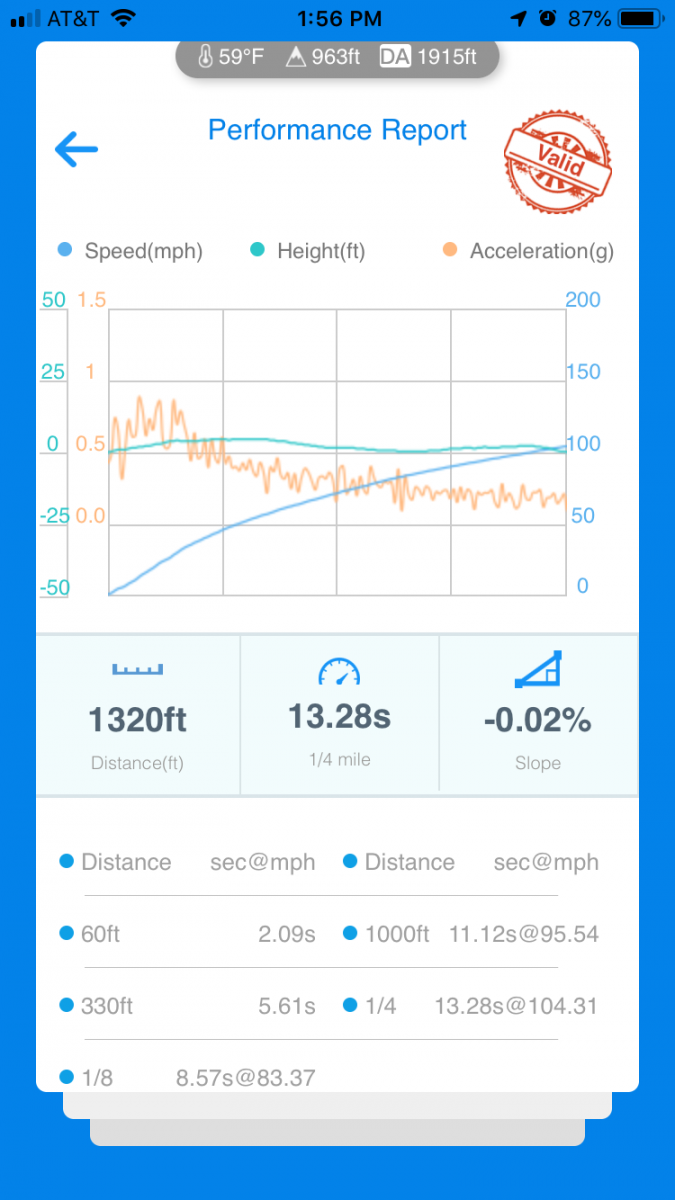

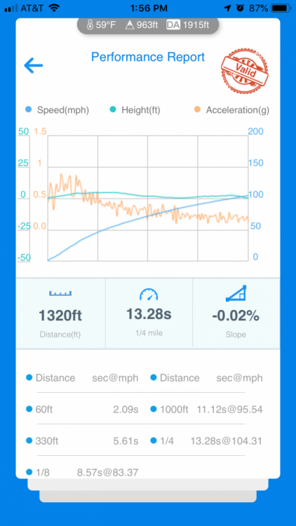

CrackedDSM Posted November 15, 2020 Report Share Posted November 15, 2020 18 hours ago, 19EdgeSTeve said: Do you have any Dyno or Dragy numbers to back that up? I do, and the 93 and e30 might as well be the same tune. Yep, I sure do. LMS 93, 100% stock everything else. Spun a little bit, top end not nearly as good. LMS E30 tune, stock everything else, same tires, same everything as before. Traction is a joke at this point, all four wheels spin like crazy, have to feather it/keep 50% throttle when launching to get a good launch. Throttle response much better, mid range better, top end HUGE improvement. With a better launch/more traction it’d be in the 12’s easily. maybe theres something wrong with your car or maybe the tune wasn’t actually uploaded. Made a significant difference in mine. Quote Link to comment Share on other sites More sharing options...

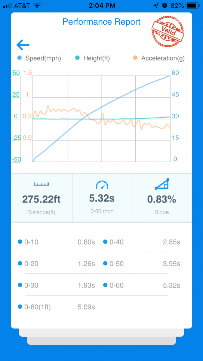

CrackedDSM Posted November 15, 2020 Report Share Posted November 15, 2020 Also: here’s a before and after 0-60. First pic is before second is after. 1 Quote Link to comment Share on other sites More sharing options...
19EdgeSTeve Posted November 16, 2020 Report Share Posted November 16, 2020 7 hours ago, CrackedDSM said: Also: here’s a before and after 0-60. First pic is before second is after. Right on. I just realized that you have a Ford Edge Sport. I have the ST, so different transmissions, and perhaps LMS is afraid to push it. anywho, The only noticeable difference has been 0-60. But only minimal. The top end power is a joke and honestly is worse than the 93 Tune. 93 0-60 Best run 4.93 E30 0-60 Best run 4.88 93 best 1/4 13.47 102 e30 best 1/5 13.53 101 ZFG is telling me that they can hand me an e85 tune on the stock pump (+intercooler) and easily hit 12s.....and easily hit 13.2 on e50 otherwise stock. 2 Quote Link to comment Share on other sites More sharing options...

CrackedDSM Posted November 16, 2020 Report Share Posted November 16, 2020 (edited) 13 hours ago, 19EdgeSTeve said: Right on. I just realized that you have a Ford Edge Sport. I have the ST, so different transmissions, and perhaps LMS is afraid to push it. anywho, The only noticeable difference has been 0-60. But only minimal. The top end power is a joke and honestly is worse than the 93 Tune. 93 0-60 Best run 4.93 E30 0-60 Best run 4.88 93 best 1/4 13.47 102 e30 best 1/5 13.53 101 ZFG is telling me that they can hand me an e85 tune on the stock pump (+intercooler) and easily hit 12s.....and easily hit 13.2 on e50 otherwise stock. Those are good numbers but I can see what you mean when you say the top end kills you. That’s crazy! You can see on mine where traction kills me. If I can get the 0-60 down to 4.6-4.7 I’d be booking. Need moar traction! You have the altitude advantage too, I saw in one of your dragy results your DA was negative 1100. Lol, I’m jealous of that for sure. It’s definitely gotta be something exclusive to the edge ST tune because the top end difference on mine is phenomenal. In the 93 tune I was so disappointed at the top end. On e30 it’s straight ridiculous. These tigerpaw 245’s gotta go, man. No traction is killing me. I’m willing to bet at an actual drag strip I’d get better results because of the prep and be in the 12’s. I do eventually want to go with lightwheels wheels and some sticky tires but one step at a time. Currently getting my EMT certs so time and money is at a premium. Couldn't hurt to reach out to LMS and say hey, this douche in an edge sport has way better top end on his e30 tune than I do, is there something different in the st tune? Edit: just thought of something, how are you blending your e30? Are you testing the e85 and then mixing based off of that? Or are you just mixing e85 and pump without testing? Edited November 16, 2020 by CrackedDSM Quote Link to comment Share on other sites More sharing options...
19EdgeSTeve Posted November 16, 2020 Report Share Posted November 16, 2020 1 hour ago, CrackedDSM said: Those are good numbers but I can see what you mean when you say the top end kills you. That’s crazy! You can see on mine where traction kills me. If I can get the 0-60 down to 4.6-4.7 I’d be booking. Need moar traction! You have the altitude advantage too, I saw in one of your dragy results your DA was negative 1100. Lol, I’m jealous of that for sure. It’s definitely gotta be something exclusive to the edge ST tune because the top end difference on mine is phenomenal. In the 93 tune I was so disappointed at the top end. On e30 it’s straight ridiculous. These tigerpaw 245’s gotta go, man. No traction is killing me. I’m willing to bet at an actual drag strip I’d get better results because of the prep and be in the 12’s. I do eventually want to go with lightwheels wheels and some sticky tires but one step at a time. Currently getting my EMT certs so time and money is at a premium. Couldn't hurt to reach out to LMS and say hey, this douche in an edge sport has way better top end on his e30 tune than I do, is there something different in the st tune? Edit: just thought of something, how are you blending your e30? Are you testing the e85 and then mixing based off of that? Or are you just mixing e85 and pump without testing? Yes, i am testing the E85 regularly. its very consistent. I lean towards e35 to be sure. I have 275/40r20 Pirelli Centurato sport all seasons and they provide enough traction. I am running 4.9-5.0 in positive DA on the regular. Basically at 55 degrees, its a 5.0 or under 0-60 everytime. Quote Link to comment Share on other sites More sharing options...
CrackedDSM Posted November 16, 2020 Report Share Posted November 16, 2020 3 hours ago, 19EdgeSTeve said: Yes, i am testing the E85 regularly. its very consistent. I lean towards e35 to be sure. I have 275/40r20 Pirelli Centurato sport all seasons and they provide enough traction. I am running 4.9-5.0 in positive DA on the regular. Basically at 55 degrees, its a 5.0 or under 0-60 everytime. That’s honestly what needs to happen on mine. I need stickier tires and losing some rotating mass in the process wouldn’t be bad either. But even just a tire change would help immensely. What I have to do to avoid spinning on the line is brake boost to 2200, hold about half throttle, release brake, continue to hold half throttle til it gets around 20-30, then floor it. If I could do a proper full rip launch that’d be great. But honestly it’s gotta be something with the trans. I’ve heard there’s some transmission gear they can’t tune around that kills life after 60, maybe that’s whats going on. Quote Link to comment Share on other sites More sharing options...
