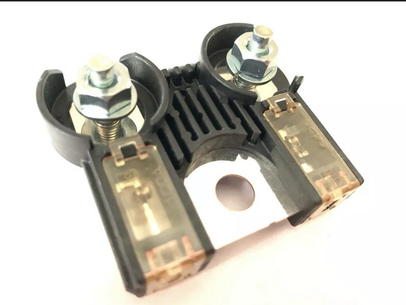

also what is the purpose of the fuse/circuit breaker on the positive battery cable?
Testing continuity across the two posts with the nuts on will confirm that both fuses are in tact, and if you don't get continuity there, then test from the center connector to each of those posts to identify which of the two fuses has blown.
You should be able to see through those clear plastic covers whether the fuse is blown, but a continuity check with a multimeter is the ultimate check.

Definitely start with a close inspection of the fuses at the positive terminal, cables for signs of corrosion, etc.  As omar mentioned, there might be codes in the system also that would help pinpoint the issue.

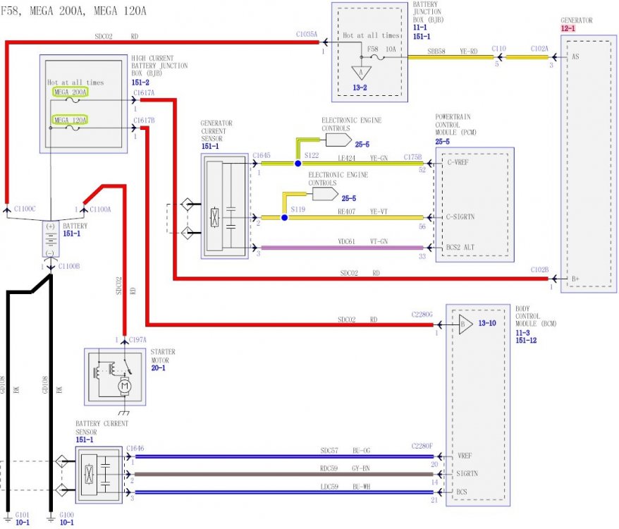

Diagram of connections from the battery:
