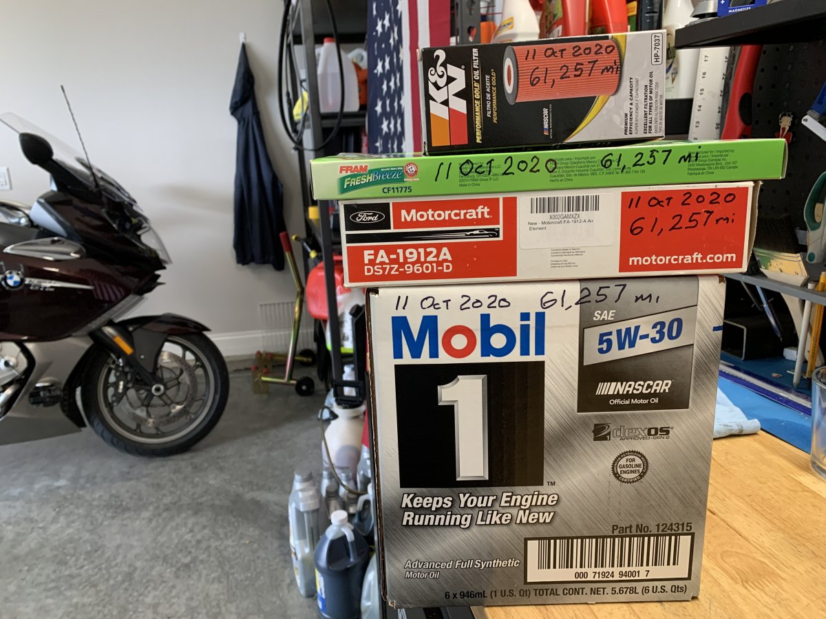

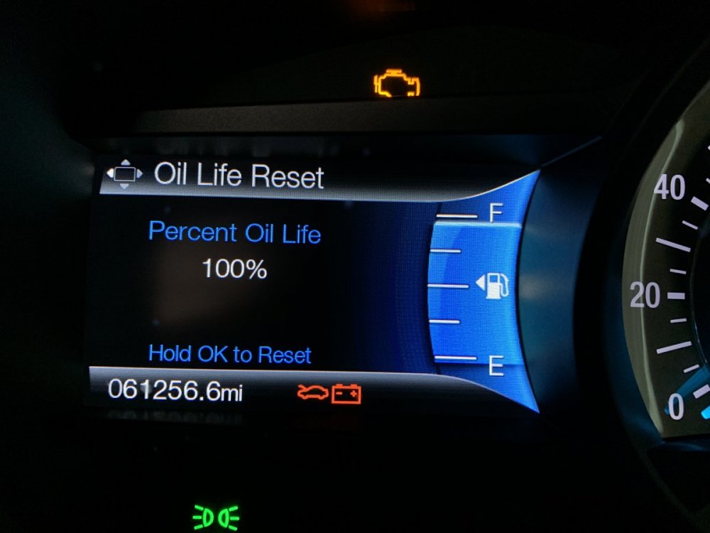

Keep your receipts for the oil and filters, and the service shop, and in addition to this I take a photo of the odometer with service indicator before and after I reset it (the photos data includes the date).
