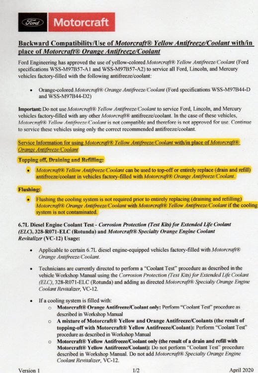

Chipster Posted November 2, 2020 Report Share Posted November 2, 2020 I am having the orange coolant changed out of my 2016 3.5. I wanted to get the orange stuff out and replaced with 10X Peak. My original plan was to get a "flush" as part of the plan, but after looking at the heater lines where I assume the flush T fitting would have to go I am spooked. While I can only see an obstructed view, I am concerned about the possibility of a fitting failure later in time and not being able to get to it without a lift. With this in mind and since this vehicle has low miles (< 16 K) I now am thinking about a drain and replace. What do you all think about my concerns? Comments? Quote Link to comment Share on other sites More sharing options...

Chipster Posted November 2, 2020 Author Report Share Posted November 2, 2020 (edited) 1 hour ago, todd92 said: Why are you gung ho to replace the 100,000 mile OEM coolant at 16,000 miles? Ford has basically told all owners of vehicles with the orange coolant to change it. Also regardless of mileage, a change should be done every five years. See the attached service advisory above and this: Edited November 2, 2020 by Chipster Quote Link to comment Share on other sites More sharing options...
1004ron Posted November 2, 2020 Report Share Posted November 2, 2020 (edited) 16 hours ago, Chipster said: Ford has basically told all owners of vehicles with the orange coolant to change it. Also regardless of mileage, a change should be done every five years. See the attached service advisory above and this: I haven't seen such a notice - do you have a link to it? I have enough Yellow coolant on hand to change my 2017 Sport which is at 65K miles, but wasn't planning on doing it just yet, but seeing an official notice I'll do it right away. Edited November 3, 2020 by 1004ron Quote Link to comment Share on other sites More sharing options...

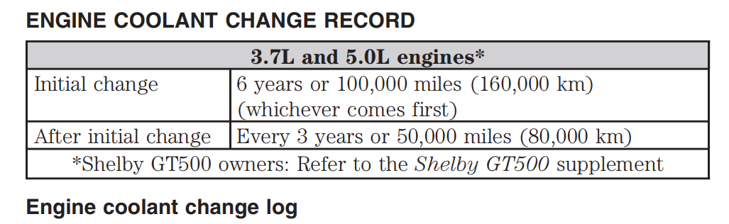

handfiler Posted November 2, 2020 Report Share Posted November 2, 2020 (edited) 13 minutes ago, todd92 said: Where is it? Cut and paste from my 2012 Mustang owner's manual which came from the factory with the orange coolant. Edited November 2, 2020 by handfiler Quote Link to comment Share on other sites More sharing options...

Chipster Posted November 2, 2020 Author Report Share Posted November 2, 2020 23 minutes ago, handfiler said: Cut and paste from my 2012 Mustang owner's manual which came from the factory with the orange coolant. 2012- 3.7 and you want to quibble about one year? Quote Link to comment Share on other sites More sharing options...

omar302 Posted November 3, 2020 Report Share Posted November 3, 2020 In the 2016 Owners manual, the initial coolant change is clearly stated as "Initial replacement at six years or 100000 mi (160,000 km), then every three years or 50000 mi (80,000 km)." I am sure there is no harm in changing it early. Also, proof that changing out the orange coolant is not required immediately is the fact that the yellow coolant can be used to rip-off the orange coolant and that no flush is required when draining the orange & filling with yellow. 2 Quote Link to comment Share on other sites More sharing options...
