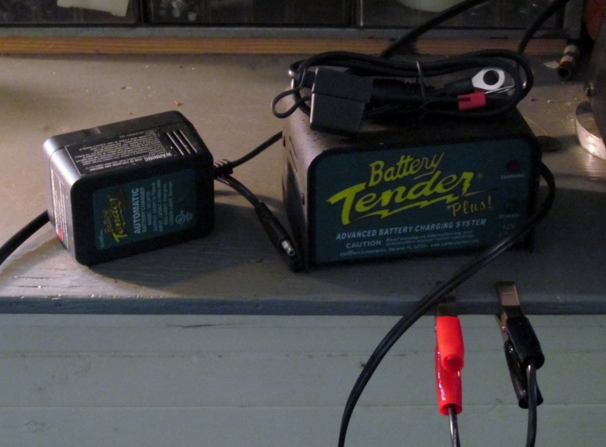

Chipster Posted October 23, 2020 Report Share Posted October 23, 2020 Do yourself a favor. Go buy a smart float charger like Battery Tender or Battery Tender Jr. I had similar issues with batteries (2) on my Edge, but since starting to use my Battery Tender when I know I will not be driving it for several days, or even after a long drive. It is interesting to see how long it takes the Battery Tender to indicate that the battery is fully charged after driving it on fairly long trips. (as indicated by a solid green led on the charger) I offer this as a possible fix for your complaint only if there are no outstanding charge / discharge issues that may exist. Over the years I have discovered that these vehicles a voltage hogs! 3 Quote Link to comment Share on other sites More sharing options...
