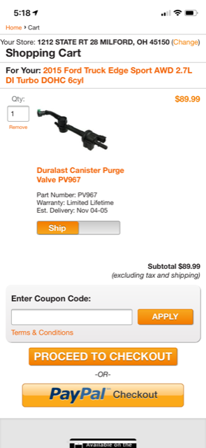

Same issue with my wife's Edge Sport. Having very hard time finding part online. I had a Bosch in the car, but would like the Ford part number as well. Found one replacement on Auto Zone, but when got to cart, said not available. Thanks!

14 hours ago, BWBESport said:
Ok, so I finally found one in stock at Rock Auto. And it’s was cheaper than anywhere else.
https://www.rockauto.com/en/catalog/ford,2015,edge,2.7l+v6+turbocharged,3310415
