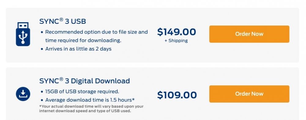

baronizer Posted October 19, 2020 Report Share Posted October 19, 2020 (edited) HI Guys, Got the email indicting there is a new Sync 3 Nav update available. To my surprise they want $150 for this thing to ship it to me. Is there anywhere I can download the file, so I can load it on a flashdrive and perform the update? Thanks! Edited October 19, 2020 by baronizer Quote Link to comment Share on other sites More sharing options...
1004ron Posted October 20, 2020 Report Share Posted October 20, 2020 https://syncnavigation.com/ford/home If you follow the directions in the above URL you'll get the option to download it for $109 Quote Link to comment Share on other sites More sharing options...
