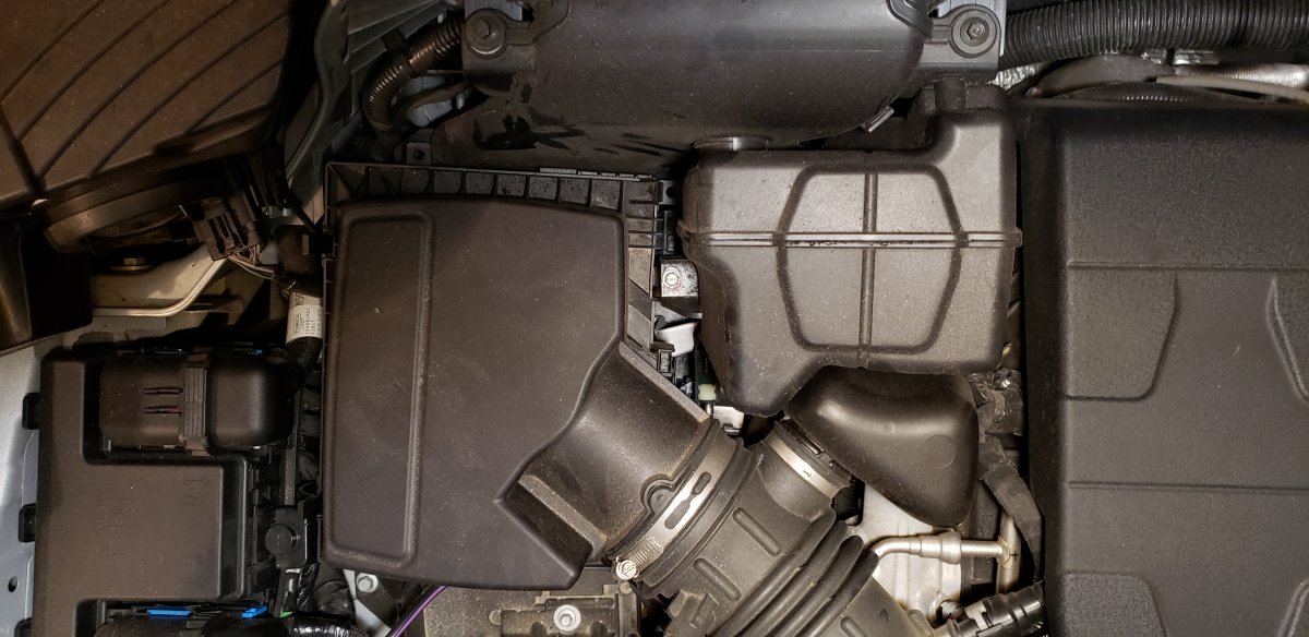

flymore Posted October 11, 2020 Report Share Posted October 11, 2020 Considering changing the transmission fluid on my 2018 3.5L edge but cannot reach the transmission dip stick. I've tried and tried to get to the transmission dip stick but cannot reach it under the large box that's to the left and feeds into the air cleaner. Is there a procedure for removing or shifting this box? The front of the car is at the top of the image. Quote Link to comment Share on other sites More sharing options...

flymore Posted March 17, 2021 Author Report Share Posted March 17, 2021 46 minutes ago, enigma-2 said: Does it look like this video ? No. Not even close. It looks like the image below. The top of the image is the front of the car. There is no access to the transmission fluid. 46 minutes ago, enigma-2 said: Quote Link to comment Share on other sites More sharing options...

flymore Posted March 17, 2021 Author Report Share Posted March 17, 2021 I can see it. Yes, it's in the same location as your video. There's no way to reach it, look at my picture. No way to reach your hand in there. Quote Link to comment Share on other sites More sharing options...
flymore Posted March 17, 2021 Author Report Share Posted March 17, 2021 Ok, that was "fun". By releasing the two screws and shoving the airbox over to the drivers side I was able to barely get my hand in and pull the dipstick out of the transmission. The car was cold, I expected not to see any fluid on the dipstick, instead it was just past the full mark. The fluid looked pink and smelled fine - no burn. Then releasing the clamp and wrestling some the airbox came out fine. Airbox wouldn't go back in. Couldn't get it down low enough and the screw holes wouldn't line up. Realized the back rubber grommet was stuck to the bottom of the airbox. Taking the grommet off the airbox and putting it back by the battery tray - then the airbox went back in. So confident I can do the drain and fill now. I'll measure and put back just what comes out. 1 Quote Link to comment Share on other sites More sharing options...
