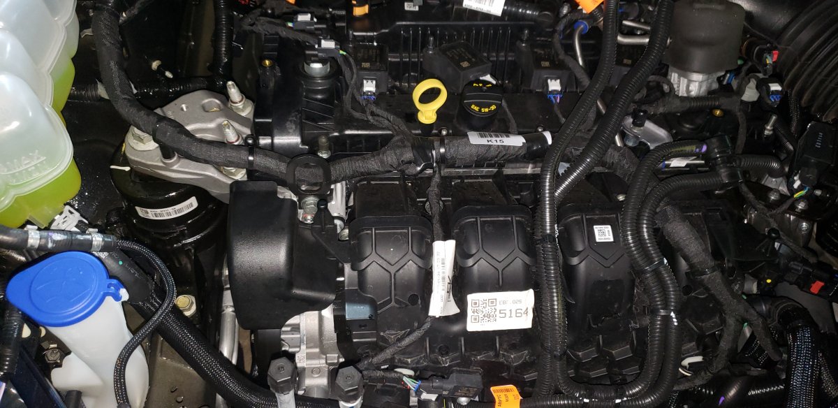

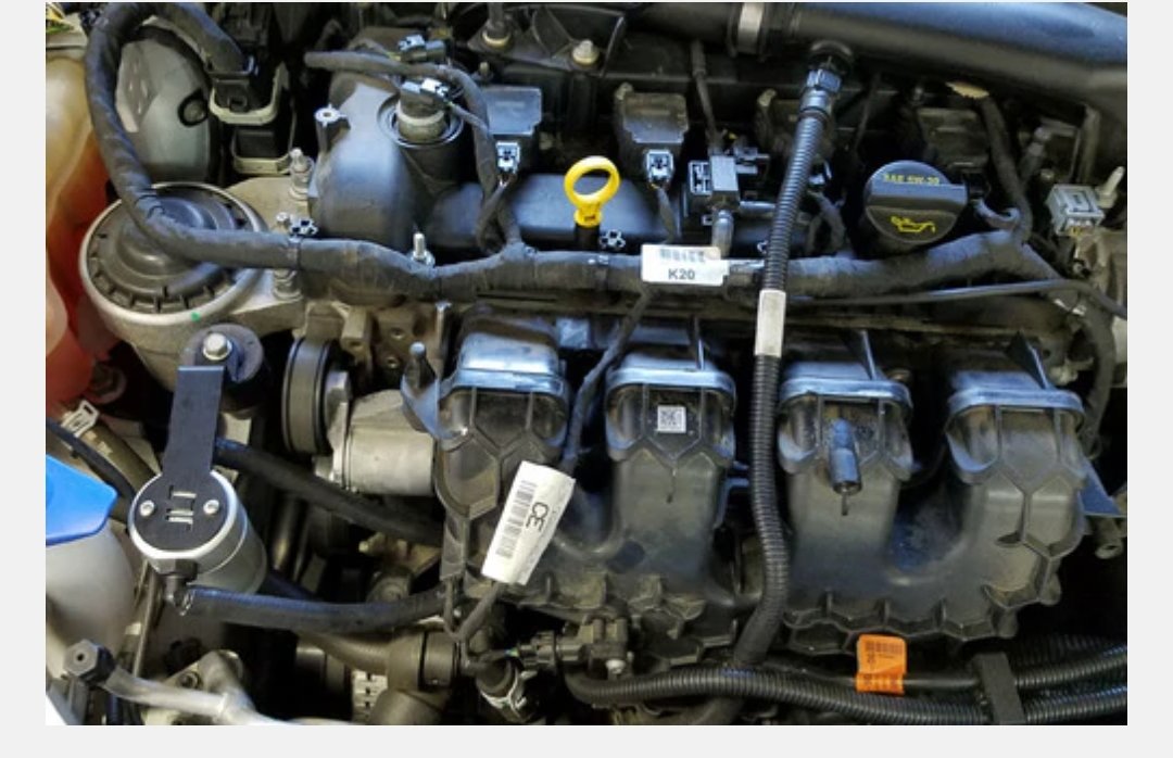

lildisco Posted November 27, 2020 Report Share Posted November 27, 2020 (edited) I don't see any 'sale' prices. Even when added to my cart. Also my engine bay isn't the same as the one pictured for the install. My engine bay is the 1st one. Edited November 27, 2020 by lildisco 1 Quote Link to comment Share on other sites More sharing options...
1004ron Posted November 27, 2020 Report Share Posted November 27, 2020 25 minutes ago, lildisco said: I don't see any 'sale' prices. Even when added to my cart. Also my engine bay isn't the same as the one pictured for the install. My engine bay is the 1st one. I called and this year they'll not be offering the usual 10% discount, only a T-shirt. Use "vinny5" on checkout for a 5% discount. Quote Link to comment Share on other sites More sharing options...
lildisco Posted November 27, 2020 Report Share Posted November 27, 2020 Called & spoke with Vinny & he said that he wasn't 100% sure things would fit & was already looking at the different mounting location as my engine bay is different than the 19 he installed. I advised him that I would be HIGHLY interested in getting a 'pre production' kit, but I don't trust myself enough to engineer something is things didn't fit correctly. He basically said to stay tuned & the Edge 2.0 & Fusion 2.0 are his big sellers, so it'd only be a matter of time till he starts producing some more kits. 1 Quote Link to comment Share on other sites More sharing options...
