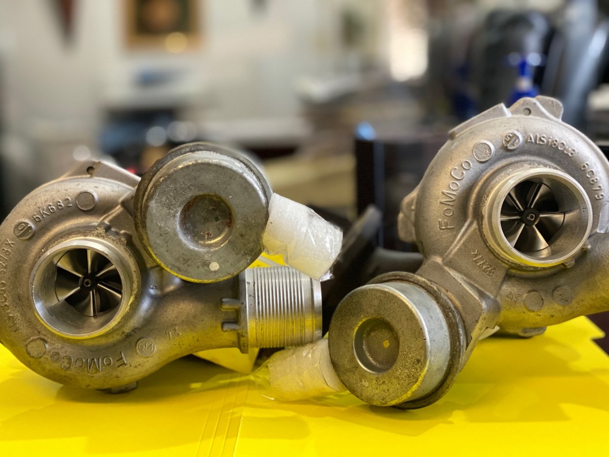

My Stage 3 turbos are in!
EDGE.R
Please be careful, the LMS tune is not calibrated for your new turbos and can cause severe engine damage. UrbanFree recently destroyed his 2.7EB by running an LMS tune with a modified engine. I recommend that you get a custom tune and not mess around with LMS. The LMS tunes are great for stock cars. They are NOT designed for cars with modified aftermarket turbos. Contact Adam at ZFG  he can help you tune the car.
Here is the thread:
good point...maybe I should get it back to factory set up until I get the dyno tune ready but I hope to have the tuner ready once done
Even with the factory tune please be careful, keep it below 5,000RPM, and do not stress the engine. Before I got my tune in I ran the stock tune and the fuel-air mix was lean because the new turbos move so much more air. I cannot stress enough about being conservative until you get that tune in it sorted out.
Ill drive like a old lady till I get the tune but, hoping to have that lined up afterinstall since there are no tuners for this cars near by. closest one is about 2 hours away here in orlando.

I can not begin to emphasize to you that you can not use LMS to tune your vehicle. They "should" only tune your vehicle if its on their dyno, none of their off the shelf tunes are compatible with your new turbos.
You should buy  the HPTuners MPVI2. With HPTuners you are not limited to one tuner. BCB, ZFG, Unleashed etc can use the HPTuner interface.
Unleashed and ZFG will give you the quickest turn around time once you submit your stock tune.  Once they have  your stock tune they will provide you with an introductory tune that will compensate for your new turbos flow rate.
After a few logs and back and forth correspondence you will be dialed in.
