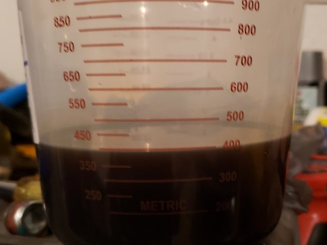

flymore Posted September 29, 2020 Report Share Posted September 29, 2020 (edited) My first PTU drain and fill on my 2018 Titanium with 38,500 miles and I'm disappointed with the capacity. I followed the videos suggestion of collecting the used fluid in a measuring cup. All that came out was EXACTLY 40ml the manual says 53ml. All I could get back in was 400ml. I was hoping capacity on this thing was going up. No I didn't spill any and it seems odd that EXACTLY 400ml came out. The only consideration was my Edge was on a ramp, but that's all I have. Anybody have any thoughts? Edited September 30, 2020 by flymore Quote Link to comment Share on other sites More sharing options...

flymore Posted September 29, 2020 Author Report Share Posted September 29, 2020 (edited) That's what I was wondering. How much do others see when they drain the PTU? Kinda strange that I got exactly 400ml. Why not 410ml or 420ml? Why not 390? Edited September 30, 2020 by flymore Quote Link to comment Share on other sites More sharing options...

flymore Posted September 30, 2020 Author Report Share Posted September 30, 2020 "You keep saying 40ML(1.35 oz), don't you mean 400ml(13.5 oz)? " Yes, got 13.5oz or 400ML as in the picture...not 40ml. Manual says 17.9 oz or 530ml thanks. Took out the fill plug first - left it out and no fluid came out there. Then took out the drain plug and let it drain for several hours. There was no sign of thick sludge - the old fluid was brown as in the picture but wasn't really too thick. Fluid seemed to drain and flow out fine. Once it was done draining after several hours I put the drain plug in and used a pump to pump in the fresh fluid up into the fill plug. When it started to run out I placed the fill plug back and checked the quart container - allowing for what was left in the pump and hoses it read 400ML was pumped in. Used heat resistant sealant on both the drain and fill plugs. Yea, at least I got most (75%) of the fluid out and already planning my next drain and fill. Probable do something to drive the rear wheels up to raise them and level the vehicle some - maybe get more out? But I think that's all it holds... 400ML. 3 Quote Link to comment Share on other sites More sharing options...

flymore Posted October 1, 2020 Author Report Share Posted October 1, 2020 (edited) Yea the fluid is in the measuring cup. New fluid is clear, the drained fluid was burnt brown. There was a thick layer of sludge on the fill plug. Yes, the old fluid still flowed freely. Edited October 1, 2020 by flymore 1 Quote Link to comment Share on other sites More sharing options...
WWWPerfA_ZN0W Posted October 1, 2020 Report Share Posted October 1, 2020 Even tho the old fluid flowed freely, there is some possibility that sludge buildup was starting to occur. Hot it may have all gone into suspension, but when cooled down, you would see layering. Did you retain the old fluid? I noticed on mine(2007) when I let it settle for a couple of days, there were two distinct layers forming (based on transparency). Hard to believe 130 mL of sludge tho. Common to find that buildup on the plug for the 1st drain. It is magnetic and is supposed to grab on to/retain breakin particles. Next time should be significantly better. Quote Link to comment Share on other sites More sharing options...
flymore Posted October 1, 2020 Author Report Share Posted October 1, 2020 Let the old fluid sit overnight in the measuring cup - didn't see sludge or layering before taking it for recycling. Only sludge was on the fill plug at the top stuck to the magnet no metal shavings. Would think sludge would collect at the bottom by the drain plug but didn't see any sludge there or come out when I drained it. The plastic tube on the fill side would only go in about 1/2 inch. Felt like there was metal there stopping it. 1 Quote Link to comment Share on other sites More sharing options...
