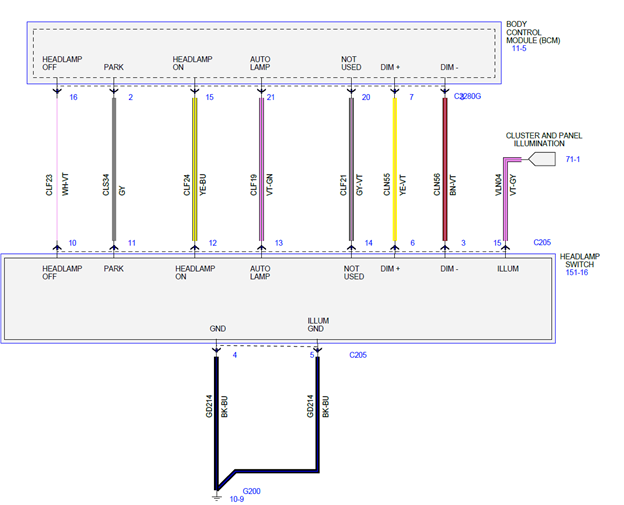

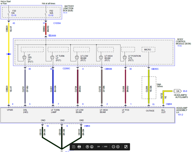

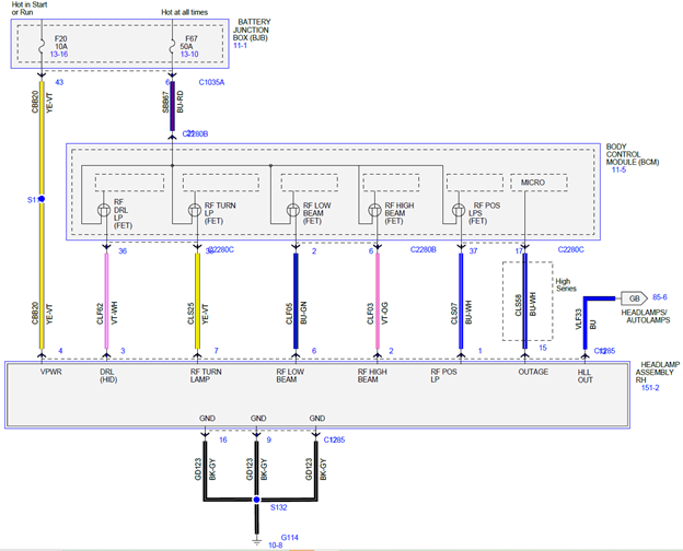

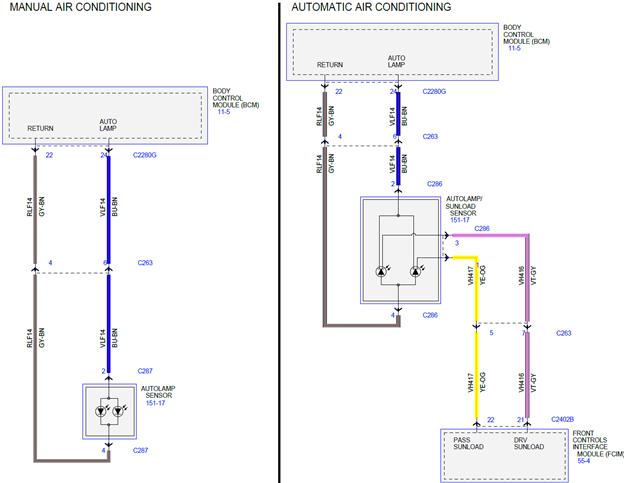

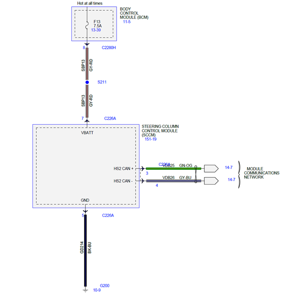

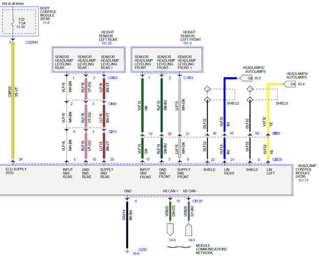

DARK_EDGE Posted September 22, 2020 Report Share Posted September 22, 2020 Good Morning, does anyone have a picture of the 2019 EDGE's headlight wiring diagrams and know what each COLORED WIRE means? Thanks in advance Quote Link to comment Share on other sites More sharing options...

txaggie Posted September 22, 2020 Report Share Posted September 22, 2020 Hope this helps!! 1 Quote Link to comment Share on other sites More sharing options...
DARK_EDGE Posted September 22, 2020 Author Report Share Posted September 22, 2020 THANK YOU SO MUCH @txaggie 1 Quote Link to comment Share on other sites More sharing options...
